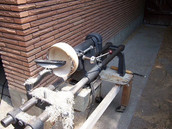

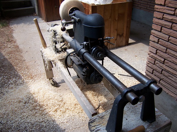

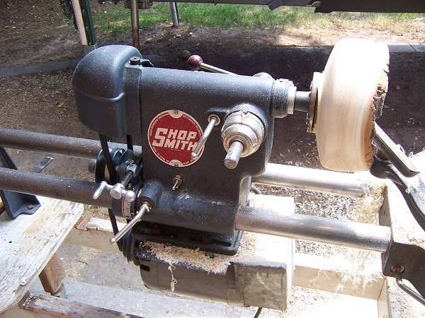

These 10ER's are addicting. I posted a thread last week with questions about one I purchased a week ago Friday. Liked it so much that I found another deal for one with a speed reducer as well. Didn't have as many questions about this one since I had one with which to compare. This is my second 10ER
A Mark V (500) is the first one I purchased new in 1993 (still have it).
As some of you will recall, my first 10ER had a crack on the spindle pulley and a weld on the speed changer. Still works fine. The one I just purchased has no crack and may have a weld that has been ground on on of the upper arms of the speed changer.
Spent a little time adjusting the pulleys and tightening stuff down and cleaned it up a little yesterday (still needs cleaning up). Today, I turned about a bowl that started out as around 9.5" by about 5" depth out-of-round blank of maple that was still a little wet. Turned at lowest speed to start, and I was impressed with the lathe capabilites with the speed changer.
It has a 3/4 HP Power-Kraft motor that appears to be one that did not come with the original 10ER.The reason I say that is the manner in which it is mounted, unlike my other 10ER. Runs great.
By the way, I paid $100.00 for it.
Here are some photos:

Look nice and clean, you got a good price on it.
When doing lathe work I take the height adjustment crank out of the carriage so it doesn't get in the way, or poke me when I am not looking.
Re the speed changer, you can mount the adjustment crank assembly on the left side of the ears instead of on the right, that way it doesn't interfere with the headstock lock handle.
Nice to have a 3/4 hp motor. I like the box they made to keep sawdust out of the motor.
10ER's did not come with a motor. There were motors sold separately that were configured for the 10ER, (capacitor on the side), but the mount was made so the owner could adapt pretty much any motor they had on hand.
If you rebuild the bench, for lathe work it is best to have the spindle at elbow height, so adjust the length of the legs appropriately for your dimensions.
