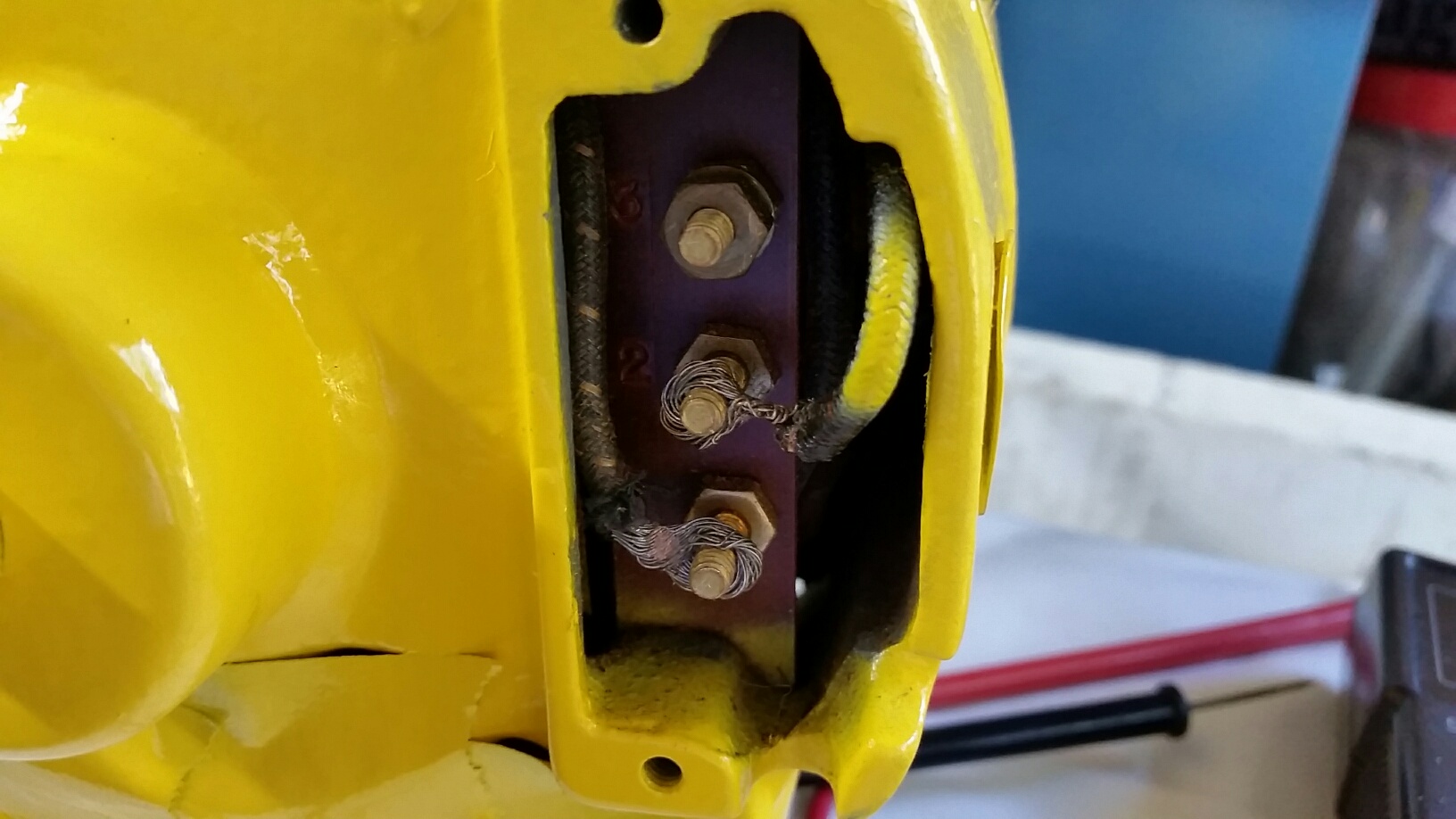

The 10ER I got the previous owner mention it was "running weak". When I took it apart I found that the wires to the motor were connect by strands of wire only the rest had broken off. I figured that was the reason for it "running weak". No way to be sure as everything is apart right now.

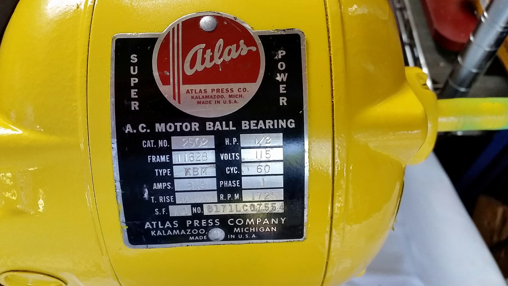

I have it taped and partially painted at this point so I can't see the label but it is an Atlas motor. When I tried to find details on it online I was not able to find them. The motor looks to be from the late 40's to maybe as late as the mid 1950's. It has dual shafts, a feature I'd like to take advantage of if I can.

I should have the painting done this week and want to connect a cord to run the motor. There is a cover plate with 3 screw terminals beneath. The black wire was hooked to the terminal 1, the number 2 terminal had nothing connected (at least on the side you can see) and the white wire was on terminal 3. As it was wired there was no safety ground, that will be corrected.
So anyone care to guess what terminal 2 might be for? If you have a guess can you also tell me how I would test your suggestion with a meter? Again if I could have gotten inside I could have traced the wires but that is not happening.

In addition to the external 'line cord' input wires, were there any 'internal' wires connected to terminals #1 and #3?
At the very least, I would check resistance between the three terminals(you will likely be measuring fractional ohms. That 'might' provide a clue as to what terminal #2 is.
Oh and check resistance from case to each terminal.
Does the name plate specify more than one voltage?
I would speculate the three terminals are used when dual voltage is an option and would have 2 internal wires connected on the outside. The two terminals(#1,#3) provide for lower voltage(coils parallel) or higher voltage(coils series with #2 providing the series connection). The start circuit would be in parallel with one of the coils.
Re: A general motor question??
From the chassis (grd) there are no connects to any of the terminals(reading open circuit).
Two wires were on the user side so I removed them to do the readings.
Between terminals 1 and 2 I see 1.2 ohms
Between terminals 1 and 3 I see 1.6 ohms
Between terminals 2 and 3 I see .6 ohms
The user side wires were on terminals 1 and 2, my guess is that they go to the cap. One has a marker which I can see going into the sealed cap, the other wire is nondescript but it seems reasonable that it too would go to the cap.[correction, I said 2 and 3 but it was really 1 and 2, it helps to have the information correct.....]
As soon as the paint is dry I will be able to unmask the motor plate.

So the paint was dry enough for me to pull the masking tape.
No indication that it has voltage options.......

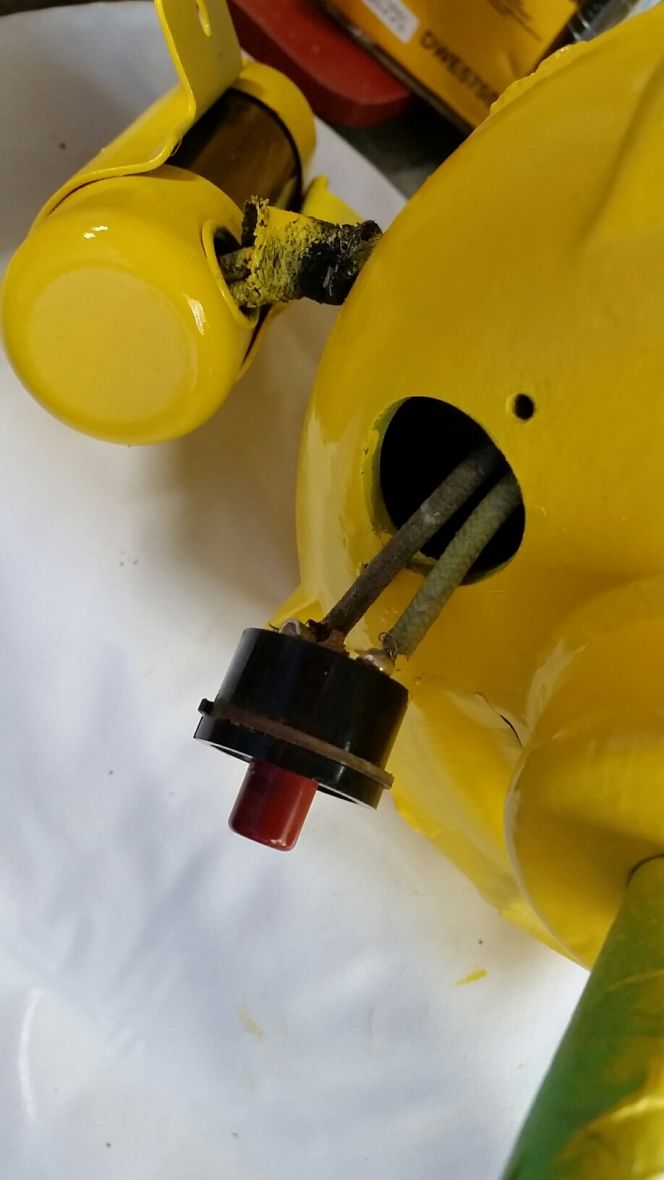

The only other thing that I did not mention is this red button, I thought perhaps a thermal overload? I check that and it is in its closed or conducting state.
I am going to hazard some guesses.
The internal wires(with 'nice' ring terminals) externally connected are the start circuit.
Reversing those wires causes rotation reversal.(reason for terminal 2).
The run windings are internally connected to terminal 1 and 2.
The over temp(cutout) switch is connected between terminals 2 and 3.
Since you have access to the capacitor and cutout switch, some of this can verified/disproved.
I am suspicious the cutout switch was causing the 'weakness' due to .6 ohm resistance(???).
That would make power input connected to 1 and 3.

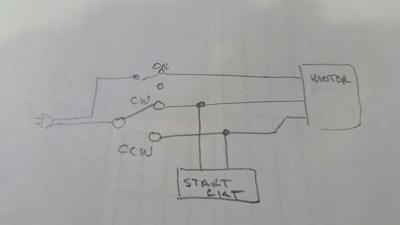

JPG wrote:I am going to hazard some guesses.

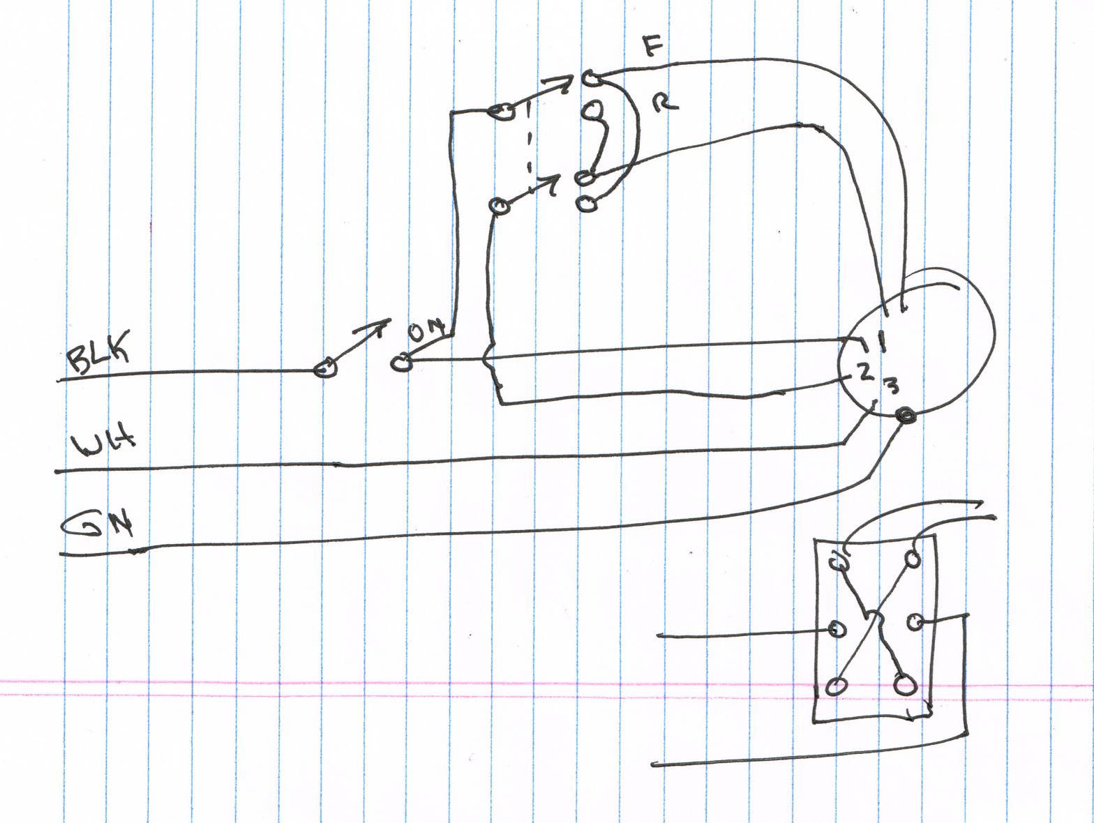

OK I did a sketch of what I think you said.... The cut-out is the switch on top and then added what I think a second switch would do reversing wise. I'd more then likely want another switch in the headstock to turn it on and off and the reversing switch somewhere else.......
If the cut out switch is bad I can live without it. Since it will not be unattended that shouldn't be an issue I don't think.
NOPE!
Like this:
