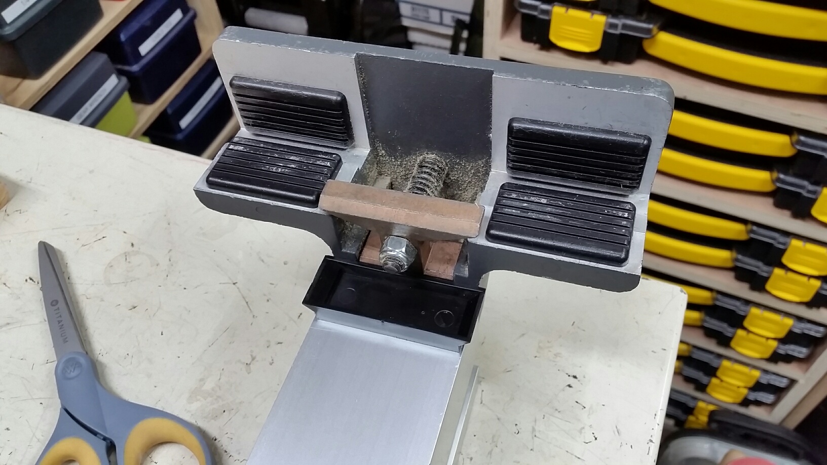

So on my last use of the shopsmith the black plastic bit on the rip fence fell off. Not a big deal as I wasn't using the scales then anyway. But since I some times do I wanted to fix it.
Looking at it you could see that a double sided piece of tape was used to attach it. Getting bumped around for years was a little more then the tape could take. I could see some saw dust migration so this has been coming for a while.
I had to clean the stick residue off the rip fence and the plastic part. Not one of those things I like to do but what can you do.
So this is the two parts that need to go together:

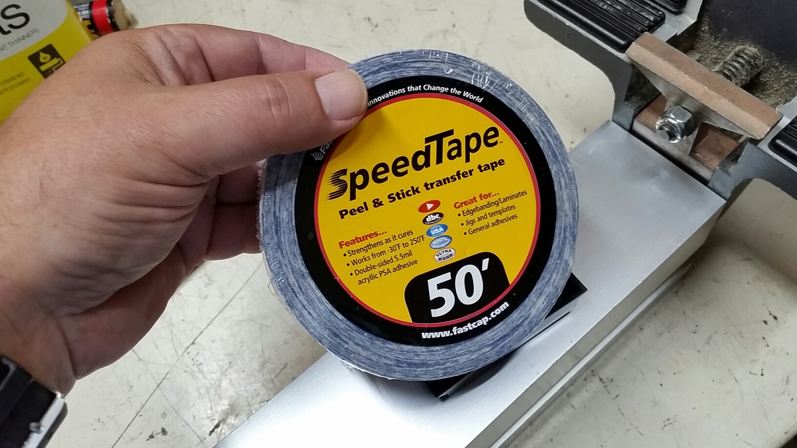

So I have a nice new roll of this stuff:

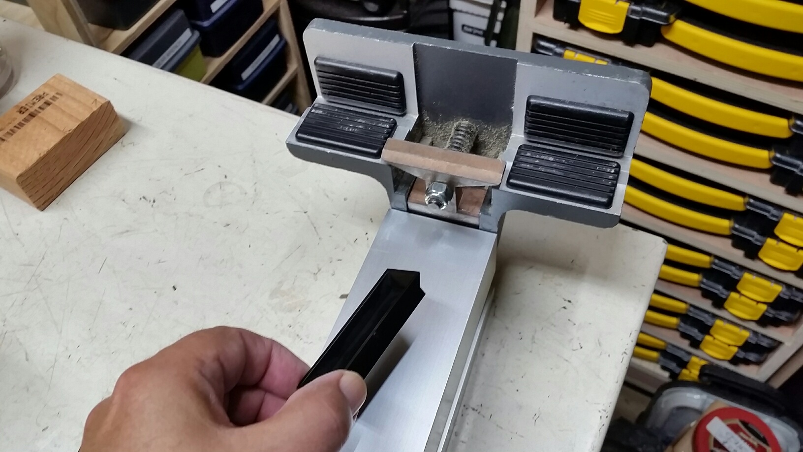

So I figured I give it a go. It was the right width and I trimmed it to length. Stuck it on the plastic part then peeled the second side and stuck it to the rip fence.
Now if it holds on for a week or two I'll let you know, if it starts getting in to years well then I might not be around to let you know......

I've read that people complain that Fast Cap tape is almost impossible to remove. So, your application is likely safe. Time will tell.

Mine never held and I tried multiple two sided tapes (not fast cap however). I finally drilled and screwed it on. End of problem!
