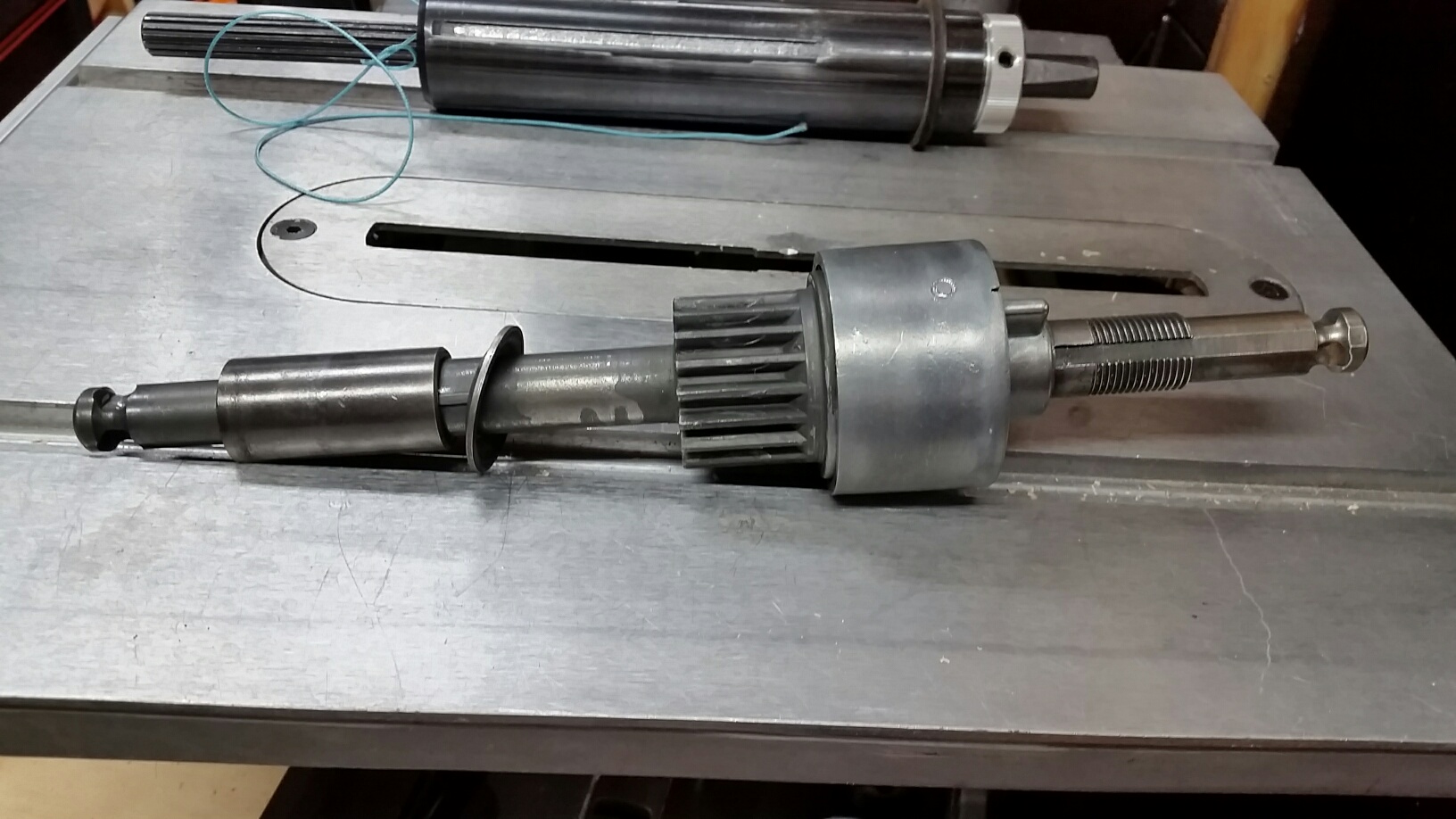

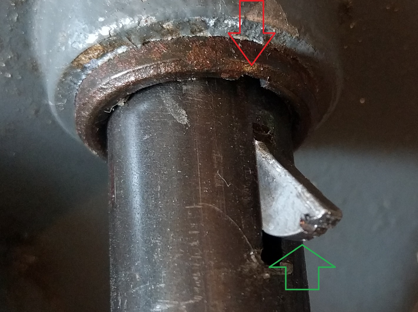

When I got it home and started cleaning and waxing, I noticed the quill wouldn't advance. I finally found time to tear it down yesterday, and was very surprised to find that the quill handle shaft had a keyway slot cut in it, and that the headstock casting had a steel sleeve in it with a matching slot. After 3 hours of frustrated fiddling I finally got the shaft to slide out and found that there is a key bar in that slot which (to my eye anyway) is why the quill won't advance. (in the photo below you can see the sleeve (red arrow), and the key (green arrow). The quill advance shaft is held in place for the photo by being placed backwards in the headstock casting near the speed control)

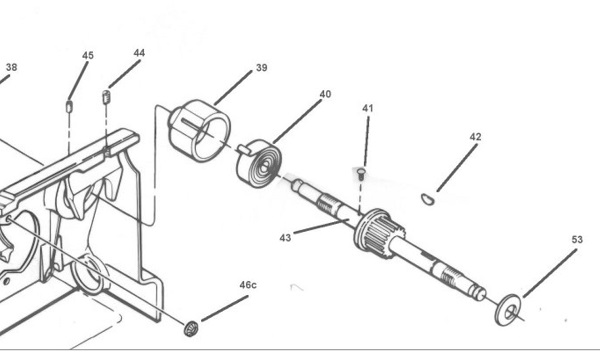

SS diagram seems to indicate that the keyslot and key are done at the factory (see number 42). I have two other Mark V headstocks on hand, neither seems to have the protruding steel sleeve in the photo above, I haven't torn them down to see if the shaft is keyed.
quill assembly parts diagram SS.jpg (37.62 KiB) Viewed 9675 times
1. Should this key be there? Without it, my handle turns freely but with it I can't advance the quill at all.

1. Yes the key should be there. The one you picture is damaged, perhaps it could be filed other wise replaced. It fits a key slot that is the same rounded shape and the flat portions should be parallel to the shaft and the bushing should slide over it. Those are called woodruff keys.
If you have pulled the shaft and did not know about the string trick you will have to fish out the washer that has no doubt dropped off the shaft. It is a top hat sort of washer and it needs to be there to get the quill to tighten/lock, ie not move in or out. No.53 in your diagram.

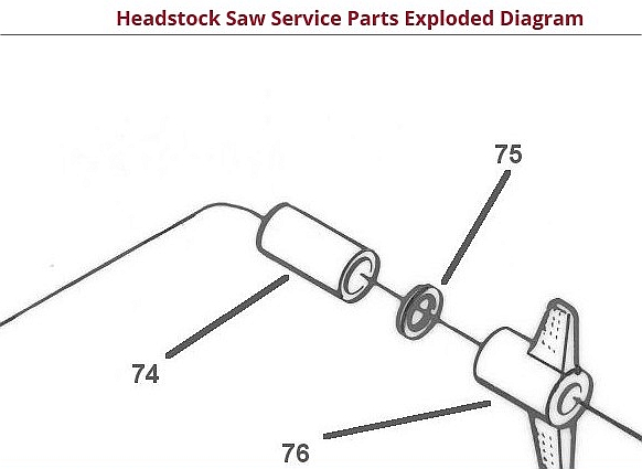

Red arrow - That is two parts 74 and 75. 75 is a wave washer and is toast. 74 is a sleeve with a keyway that the woodruff key mates to - also toast.
The washer should separate from the sleeve with a wedge(chisel) forced into the crack separating them.
Removing the sleeve will likely be a SOB to get out without damaging the softer aluminum headstock casting. It DOES have to go.
I assume the set screw is #45. You may need to drill it out and use an 'easy out'. A brand new hex 5/32" hex wrench may help(less likely to slip).

I stripped out #45, the allen screw that holds #39 in place - #39 slid out, it's scratched from the allen screw, but otherwise intact. I'm in a holding pattern for a few days, the correct size EZ-out is missing from my set so I'm waiting on Amazon for a new one.
#53, the hat shaped washer was bonded to the inside of the sleeve (#74) and stayed put when the shaft slid out - I have it and can reinstall it when needed.
I'm pretty confused by the need for #74 (sleeve) and #42 (woodruff key), as they seem to be what locked my quill from advancing. Is the sleeve stationary on a properly functioning quill? or does it rotate with the #43 shaft?

oh, and JPG - the wave washer is not pictured in the photo with the red arrow - that appears to be the end of the sleeve itself. (assuming here that the wave washer you reference is a flat washer with a ripple in it, that is tightened by the quill lock knob).

Weekendmedic wrote:oh, and JPG - the wave washer is not pictured in the photo with the red arrow - that appears to be the end of the sleeve itself. (assuming here that the wave washer you reference is a flat washer with a ripple in it, that is tightened by the quill lock knob).
Eric
Correct.
The keyed sleeve, key, wave washer, spherical washer and the wing nut are what locks the quill feed when desired.
Unlocked the sleeve rotates in the headstock bore caused by the key connecting the shaft to the sleeve.
When it is desired to lock, the wingnut is tightened causing the wave washer to 'flatten' until it presses firmly against the sleeve. Further tightening will cause the sleeve to move inward and press the spherical washer against the rib inside the headstock. Friction them prevents all that stuff from rotating.
The nice thing about the wave washer is that partial flattening provides partial braking so the quill can be adjusted, but will hold position.
P.S. I think the wave washer is flattened and rusted to the sleeve.
OK then it was not installed correctly. The casting inside that it pushes against would not permit you to remove the assembly with the washer in place. So clean it up and hold on to it for when you reassemble the unit.

??? The key and shaft will slip through the washer center.
Re: 510 Refurb - Quill advance questions
Yes you are correct...... I missed the part where it was bonded to the sleeve.
One of the used machines I got the previous owner said the quill would not lock and he was right, he had taken it apart and had the washer drop in the housing and when he put it back together it would no longer lock...... anyway I've tried to pull the shaft and keep the washer in place on the shaft and it doesn't happen or didn't for me. To much casting to get by without it falling off.
