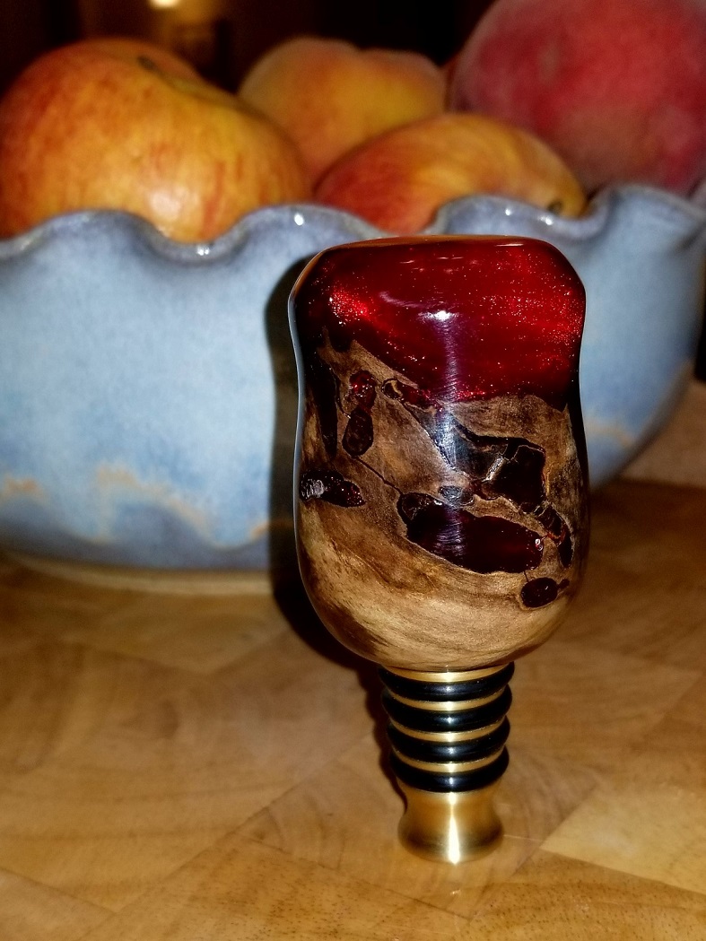

Tried my hands at casting resin. Bottle stopper from carpenter ant eaten maple and alumalite resin. Wood stabilized with cactus juice. Turned.
- stopper resized.jpg (216.38 KiB) Viewed 11642 times

OK it happened. Interesting look to say the least, that could be a real conversation piece.ChrisNeilan wrote:Resized! New Samsung 8 takes really large photos!!!

Looks really nice.

Very cool! Did you make the brass stopper part as well? How did you cast the resin in/around the wood?

The stopper came from Ruth Niles (http://nilesbottlestoppers.com/). The resin is Alumalite 2 part Casting resin (turntex.com). I placed the piece of wood into a mold and poured the resin over it. It then is placed in a pressure po=t under 55 pounds of pressure to eliminate any bubbles. Wait a few hours and crack it open! Drill a hole and mount it on a mandrel and then turn it.

That is very nice looking! Er...what's "cactus juice"?
Re: Hybrid bottle stopper
Tequila.
