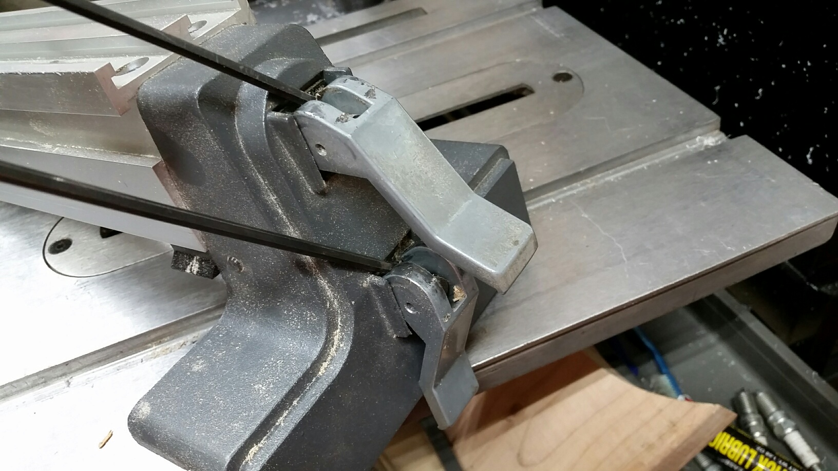

Post by dmori »
When I install the rip fence (power pro) on my saw table the two lever handles require much greater force to close them than should be necessary. I have looked at the user's manual that came with the upgrade to the pro fence system but it does not seem to contain any information on how to adjust the degree of force necessary to throw the levers into their closed and locked position. Can anyone on this forum tell me how to do this?

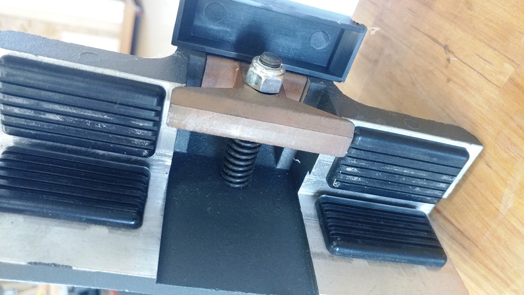

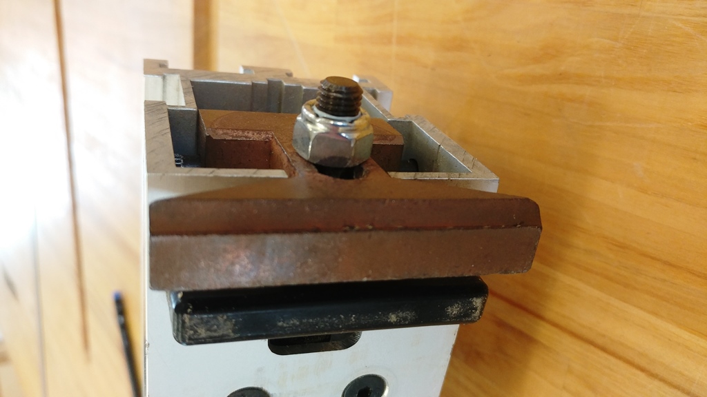

As Ed said it could be a lack of lubrication. However, if the lube does not fix it there are two nuts to adjust the tension. The first picture is the nut for the lower handle and the second picture is the nut for the upper handle. They should be adjusted so there is just a slight resistance when closing the handles. A Lack of lubrication will alter the resistance you feel so lube first and then adjust the nuts if needed.
