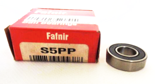

John is absolutely right. For a final confirmation if you live in a larger community, a commercial local bearing supplier can be your best friend. Let them measure the bearing, and the shaft it goes on as well, and then decide what to order if you can't order from Shopsmith.
From everything I can tell, these are the 1950's bearings for the 4E Jointer. They were sealed, not shielded.
S5PP FAFNIR.png (157.28 KiB) Viewed 11347 times
It did change back and forth apparently through the years. If you read the Bearing Document as it exists even in the draft form, this topic is covered already.
If you have ever worked in manufacturing, you already realize that a professional cost control analyst (bean counter for parts acquisitions) will find cheaper parts, even foreign sources for parts, if they think they can save a buck. Shopsmith was never that way. Quality was always
front and center, and it is today. A bearing today doesn't have to last 60 years. 20 is usually fine.
I am working on the Planer and that will be the last in the structure of the document, but by no means is the document finished at that point. If it were a house under construction, it's not even 'dried-in' yet.
