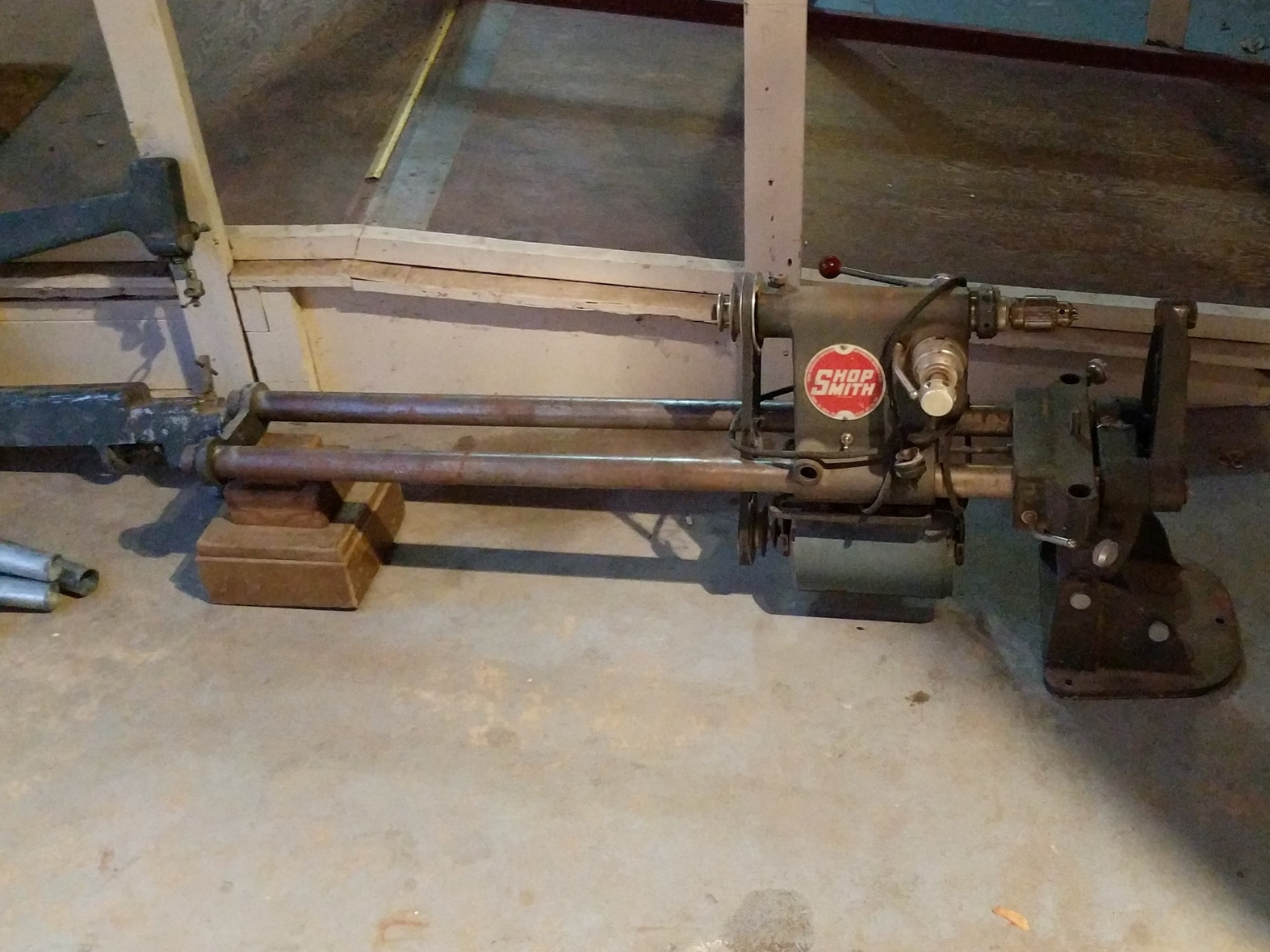

I just got probably the best deal I'll ever find on a SS 10R and a bunch of parts to go with it. However, it needs a good deal of work to get everything running smoothly again. Any suggestions on dos and don'ts before I get started? There's a small amount of rust here and there and most things that move seem to be gummed up from years of no cleaning.

A good place to start is this thread. http://www.shopsmith.com/ss_forum/maint ... t5074.html
Especially be sure to follow the link to Mickyd's restoration thread.
They aren’t that complicated, and built like tanks, just be sure the lock knobs for the table are released before turning the raiser crank, the arm can break.
The only routine maintenance is to keep the way tubes clean and waxed, and if you have a speed changer they need lubricating occasionally.
We would love to see pictures of your prize.
Re: Second ShopSmith, Needs Work
Thanks, I'll work my way through the links in that post.
As you can see in the photo, it didn't come with a bench, so I'll need to figure that out once I have it working again.

My first one didn't come with a bench either, it is easy to make.dzawacki wrote:Thanks, I'll work my way through the links in that post.
Your 10ER has the later (shorter) pivot base, The plans say to make the bench 60'' but you only need to make it 57" long. Also instead of notching 4x4's for the legs, just glue together two pieces of 2x4. And if you are will be using the lathe function then adjust the length of the legs to make the spindle level with your elbow.
Here is the plans for the bench.
Oh, and here is a link to the manual for the jigsaw. http://vintagemachinery.org/pubs/detail.aspx?id=2703

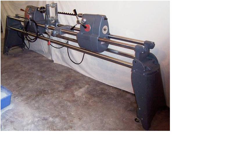

I agree with UncleSnick. She likes what comes out of my shop so leaves me alone. I also repair them for over 15 years now and money back into the budget quieted that argument real fast. My first was a 10ER with speed changer and jigsaw. I added drawers under the base which I highly recommend. That jigsaw is very nice once set up. I sold it when I bought my first Mark V in 1983. Then the upgrades started and I bought my 2nd for the 18 inch jigsaw & jointer. The headstock had a problem and being highly mechanical I took it apart and fixed it and realized I had/have and aptitude for fixing these and love it. I now run a 520 main machine, old 9 " Rockwell tablesaw PO put 520 rails on so table is expandable. I also run 2 minis- 1 saw station and one sanding station, a permanent drill press and a lathe made from 1 machines connected together- turning length is about 7 1/2 feet. I also run a Wood Master 6" jointer on a power stand but upgraded to 1 1/2 HP motor with correct pulleys to get speed of cutterhead close to 6000 RPM. I just purchased a ProPlaner and after I put fresh blades in will sell my original planer with hand crank instead of feed motor. Also a SS 20 inch standalone scroll saw. shop is 24X36- 24X24 is wood shop and 12X24 is old CJ Jeep shop. I repair/refurbish Shopsmiths in one end of garage. Currently bought several packages and once gone over will have some stuff to sell.
- 2 machines connected together- originally used to core wooden baseball bats- until Sosa got busted.
- extra long Shopsmith lathe.jpg (45.04 KiB) Viewed 9019 times
