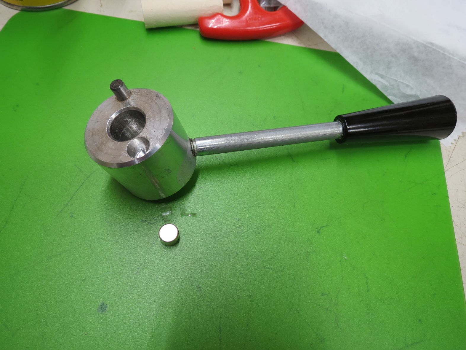

So I take the handle off one side and put it on the other and I notice it is not being held on????? Looking at it I notice this hole where the magnet should be........ the magnet is still back on the other side.
Looks like a failure of the glue........ Well something to work on. The left over bits look a lot like duco cement but I guess any of that sort of stuff pretty much the same.

Loctite(red or blue) should fix it.
Re: Quick Index Quill Feed Handle issue
Well it is back together and ready to be put back on. Why so long? Let's start with what happens when you move things in the shop and then can't find them again..... case in point my loctite collection. It use to be on a shelf which I re-purposed but what did I do with the loctite?? Never mind I pick up another tube.
It has had a couple of days drying time in the house so today it goes back in to the shop and back on the shopsmith.
