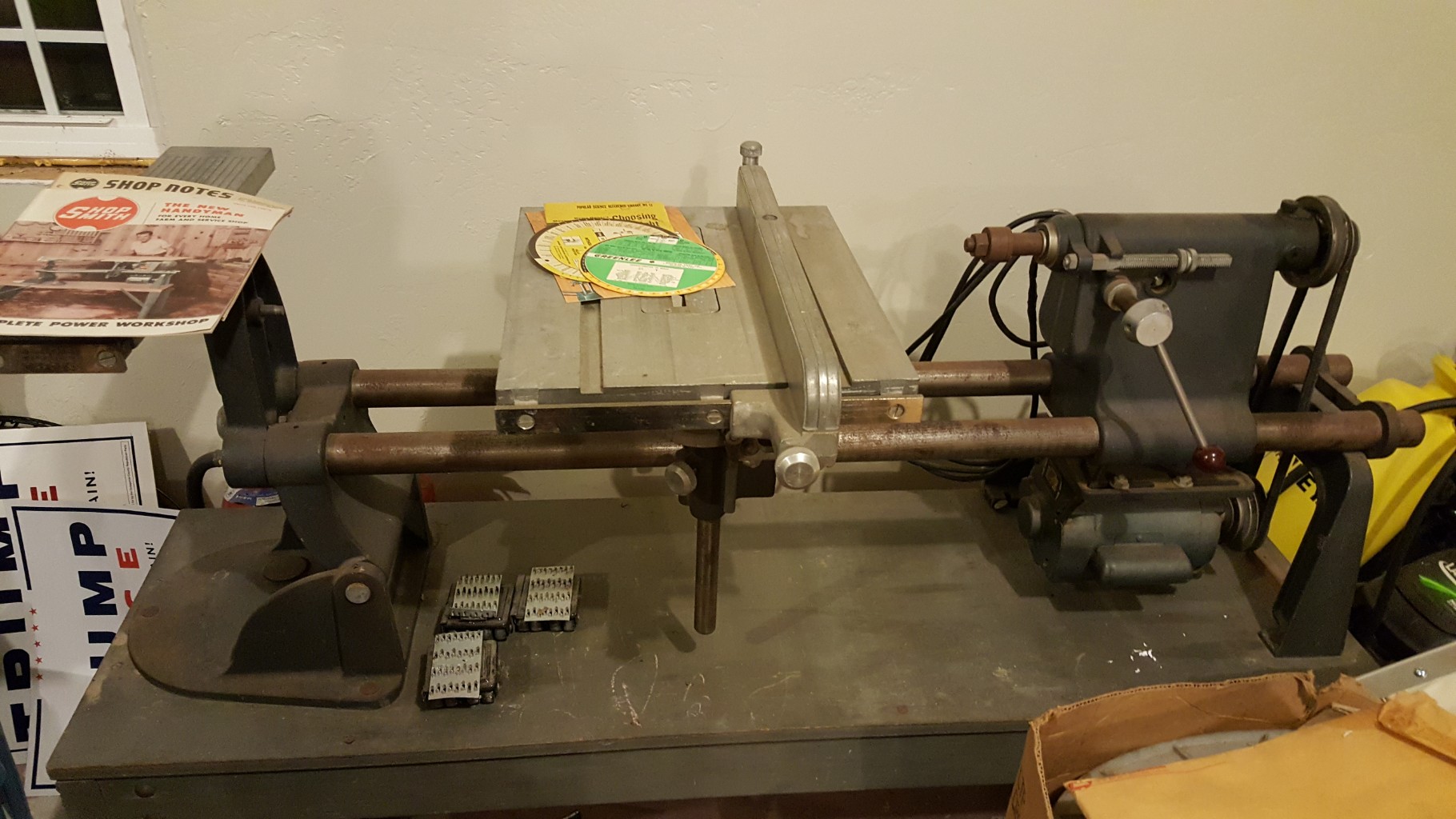

I am looking into trying to find the year this unit was manufactured. It is a Model ER. Serial 44038. I got this shopsmith from my Grandpa who bought it new. I have the original manual and other original paper materials. Nothing indicates a year of manufacture. I would love to restore this and start using it
for projects. Any info/help is greatly appreciated. I will also attach a few pictures if this helps.
Finding Year Manufactured
- 20180127_194534-1820x1024.jpg (317.84 KiB) Viewed 6268 times

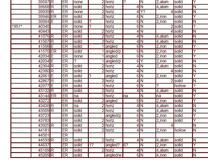

I don't see serial# 44038 on here. Would this be made in 1951 or maybe an earlier year?
Thanks,
Kevin
Thanks,
Kevin
Re: Finding Year Manufactured
Ya think 'maybe' it was between 43925 and 44181?KSchaefer wrote:I don't see serial# 44038 on here. Would this be made in 1951 or maybe an earlier year?
Thanks,
Kevin
All those below 1951* are 1951.
That list is from a survey conducted by Skip and is input from responders.
