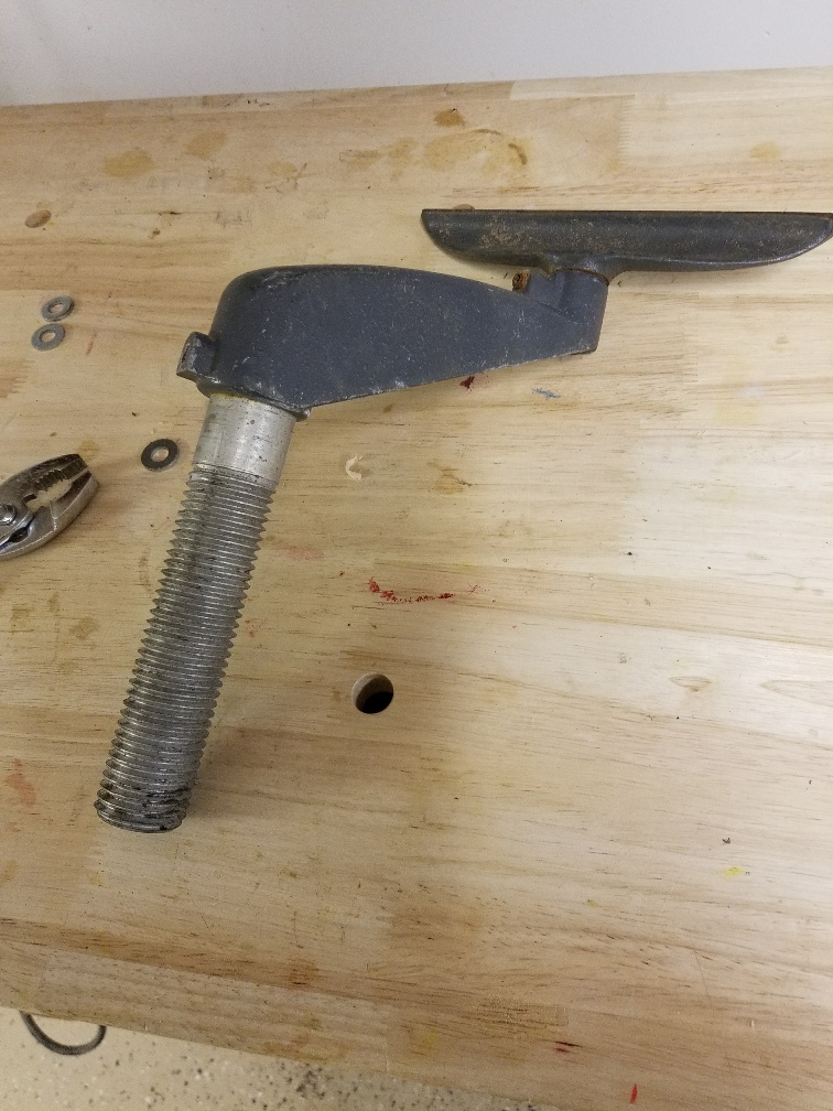

Is this what you are looking for? I have an extra you can have for the cost of shipping. PM me if interested. This came off a Mark V from 1982, but should work.
Chris
Chris
- tool rest post 2.jpg (276.04 KiB) Viewed 10612 times

That'l work!ChrisNeilan wrote:Is this what you are looking for? I have an extra you can have for the cost of shipping. PM me if interested. This came off a Mark V from 1982, but should work.

I just checked the Mark VII manual and parts lists and although the arm and tool rest are different from the Mark 5 the post looks the same as the older Mark 5 post with the grooves all the way around the post and has the same part number 501354 as the Mark 5 from that era, not with the teeth on one side like the newer ones. It appears a Mark 5 lathe tool rest assembly will work in a Mark VII Carriage. One of the caricaturists of the Mark VII parts is they are squared and angled, not rounded surfaces like the Mark V. It's the easiest way to tell a mislabeled part like the Tailstock on eBay or other sale sites.

Actually the M5/VII posts are threaded, not grooved(ringed).

Sorry wrong terminology
Like the Mark 5 post shown above.

Truth be known, only close examination will reveal the 'spiral' groove.chapmanruss wrote:Sorry wrong terminology
