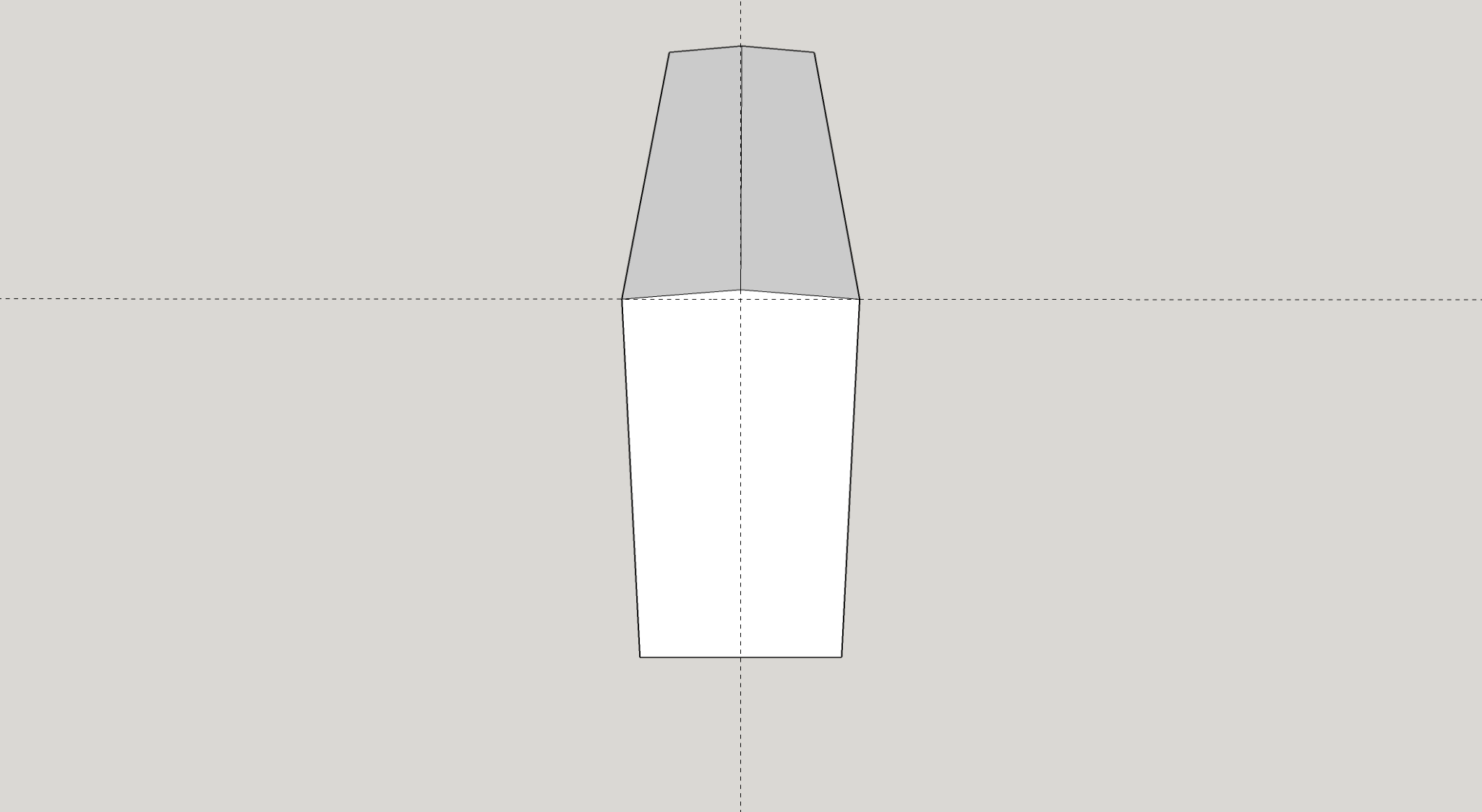

I'm unsure of what is to be accomplished but if I understand the objective I would do this with a disk sander. Preferably the conical disk sander.
Small Bevel.png (40.78 KiB) Viewed 26479 times
The setup will be tricky no matter how the material is to be removed.

My advice assumes bevels are to be cut into the 3 inch tall faces, not a single edge
Re: bevel cut on bandsaw
I would still attempt to do this with the conical disk though 3" may be just a bit much.

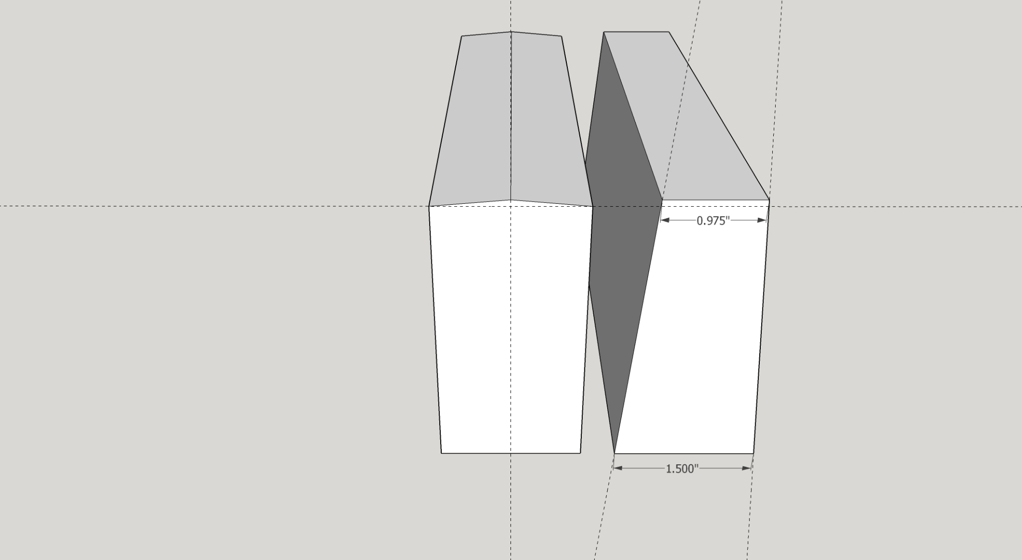

Small Bevel.png (85.7 KiB) Viewed 26453 times
dusty wrote:I would still attempt to do this with the conical disk though 3" may be just a bit much.
A 5° bevel over 3" would be inset only slightly over 1/4".
I agree conical sander is a desirable method. Kinda close quarters though.
Yes too long can be a problem.
