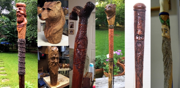

I have not been on the forum for some time. I have been focused on carving canes and walking stick. I have done little other than cutting out small objects on the band saw I and sanding I have not used the SS a lot. My shop area is small and space has become an issue. I have been thinking about shorting the tubes on my 520 to gain floor space. But I want to still use my saw and one table exception. Is there a recommended length which works well? I am thinking taking off 16” to 18.”Any suggestions would be helpful. I was on the forum for some time buti could not signe in with my old name and pass word. These are some of my sticks and toppers.

I have no comment on cutting the tubes, but I will say that those walking sticks are absolutely beautiful!

FIRST - the sticks are fantastic works of art and a certain indicator of yours skills as a craftsman and artist.

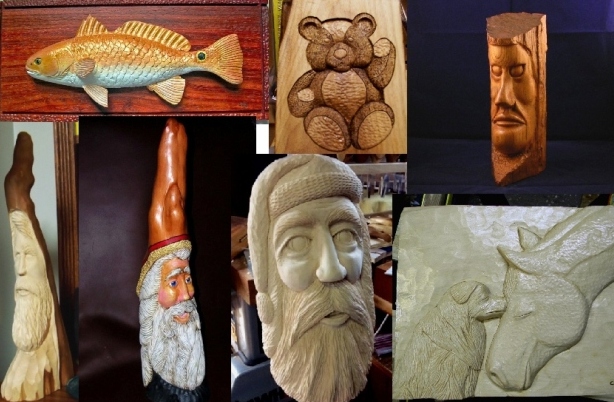

These are some of my other carvings. I use the SS in some form in most all the work I do.

Impressive!
Re: shorting tubes
That word is inadequate!!!Dansmith wrote:Impressive!
I remember your posts in the previous 'life' on this forum.
Your talent would put Mary to shame!!!
