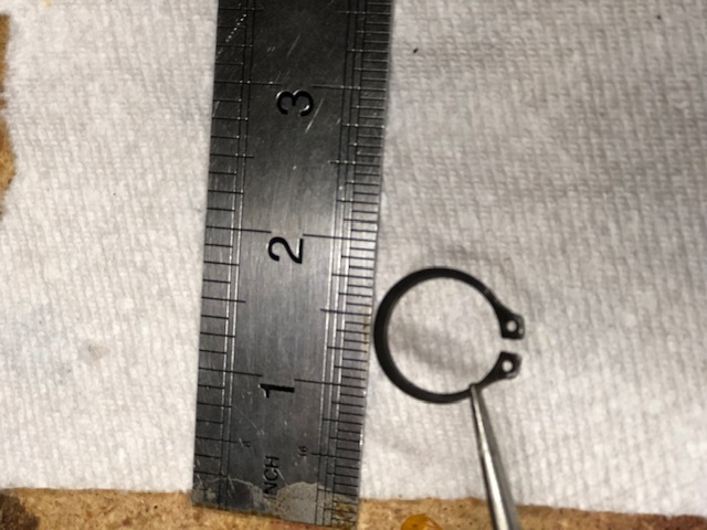

This question is some what of a " fishing expedition".
I am currently refurbishing a '59 Greenie (500) w/ khyber belt, single bearing quill.
I completely disassembled headstock, inspected all parts and reassembled unit.
Here is the "question".
After reassembling unit I discovered that I have an extra 11/16 exterior retaining clip (snap clip).
Any Ideas what part may actually use this size clip?
A little history may help. This is Greenie was not well maintained over the years and many of the small parts ( washers, screws, set pins, ) were missing or installed incorrectly. So not sure if my "extra clip" is actually needed.
i did not remove the fan sheave nor the idler sheave. So those clips were not touched.
I did replace the retaining clip for the motor spring.
So, any ideas would be greatly appreciated.

Re: '59 Greenie extra retaining clip?
A picture of the clip would help.
yes that would have been helpful.
There are three places on the Greenie Headstock that uses a clip around that size. One is on the Drive Sleeve Assembly (1675) facing out, another is on the Pinion Shaft (1677) on the back side of the headstock and the third is on the spindle (1639) in front of the bearing. See attached PDF of page 2 of the March 1959 Parts Lists.
Sorry I can't narrow it down anymore since I do not have a Greenie or Goldie at this time to compare clip types/sizes. I hope this helps you find where it belongs and if your Mark 5 is missing it or not.Russ
Thank you so much chapmanruss .
That image was very helpful.
It was definitely the retaining ring for the pinion quill feed (1677).

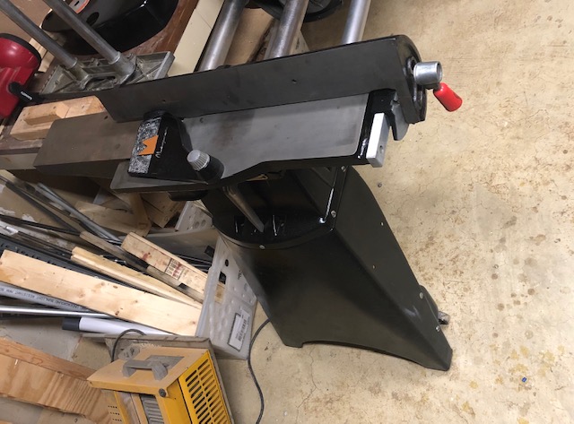

This is the current state. Definitely not green any more.
I do have quite a lot of the original documentation. I have not gone through
all the papers but I would be happy to submit something if it helps.
I will have a look tonight.

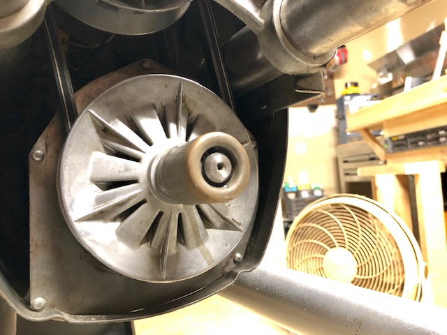

Installed new belt.
Silly question, the belt rubs on the way bar.
Motor appears to be in the correct position.
Is this “normal”? Seems strange.
Is that a SS OEM belt?
