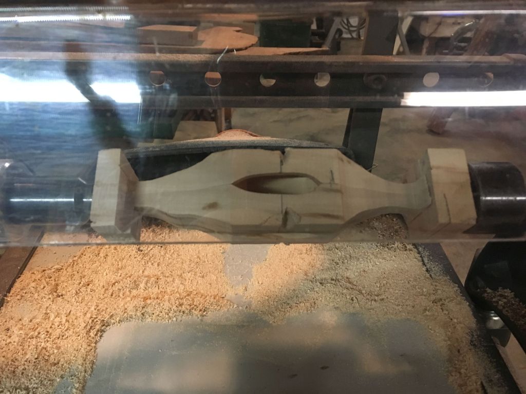

I started making some Christmas ornaments the first week of December just prior to the Shopsmith lathe duplicator ad. So off and on over the last two weeks I made a set of 12: 6 walnut, 3 red cedar, and 3 maple for son and family in Alaska. My wife put them in the mail Friday before I got pictures (I know it didn't happen). Here are some pictures from along the way and one I made yesterday.
The bottom template was used to turn the outside of the ornaments.

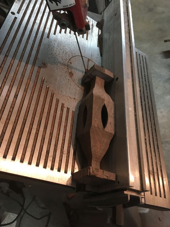

Stock after turning inside, rotating the four sections 180 degrees, gluing back together and removing excess stock.
Removing those knuckle beater corners in subsequent turnings.

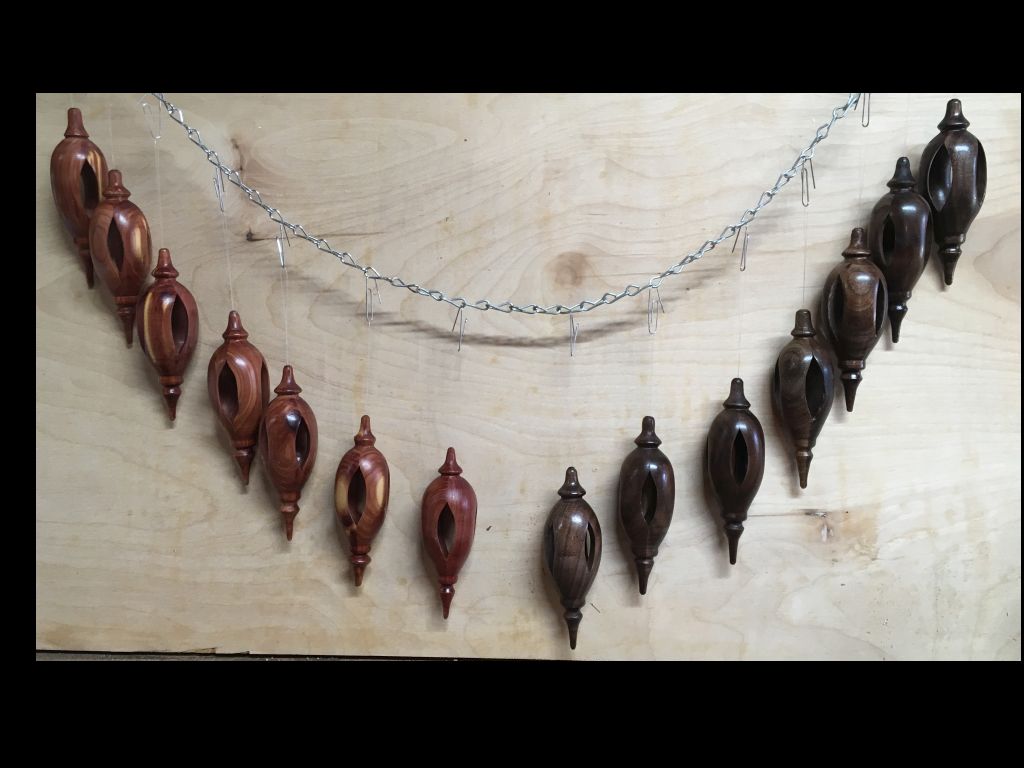

The first two were hand turned to get a template I liked.  The last one I turned yesterday and is like the 12 sent.
I turned most of them with the duplicator on the Power Pro. I have the same issue as with the bandsaw of the fluctuation in speed making noise.
I moved the duplicator to the 520 and it worked much better.
I tried doing the turning from both 1 1/2"x1 1/2"x 7 1/8" stock and four pieces of 3/4"x7 1/8" stock glued together. The 1 1/2" stock has to be cut in quarters on the bandsaw after the inside turning. The four quarters method allows you to use up smaller stock and scrap.

Whenever I make something new to me it seems to get old before I'm finished. I have made 30 of the ornaments already so it's not new anymore. I have six more to go sometime soon.
Just hanging around
Just hanging around
I sharpened the round carbide cutter and what a difference.
And I use to worry about a little dust from the Shopsmith table saw

Those look amazing!
Posts: 3800
Re: Lathe Duplicator
Those are beautiful ornaments ... but 36 of them? :eek: Santa needs some elves! ;)
redleg
Posts: 237
Location: Asheboro, NC
Post by redleg »
Thanks Algale, I kind of like the cedar best.
Thanks, Buckeye.
Or fewer grandelves? Even Mrs. Santa disappears when the Shopsmith starts.
