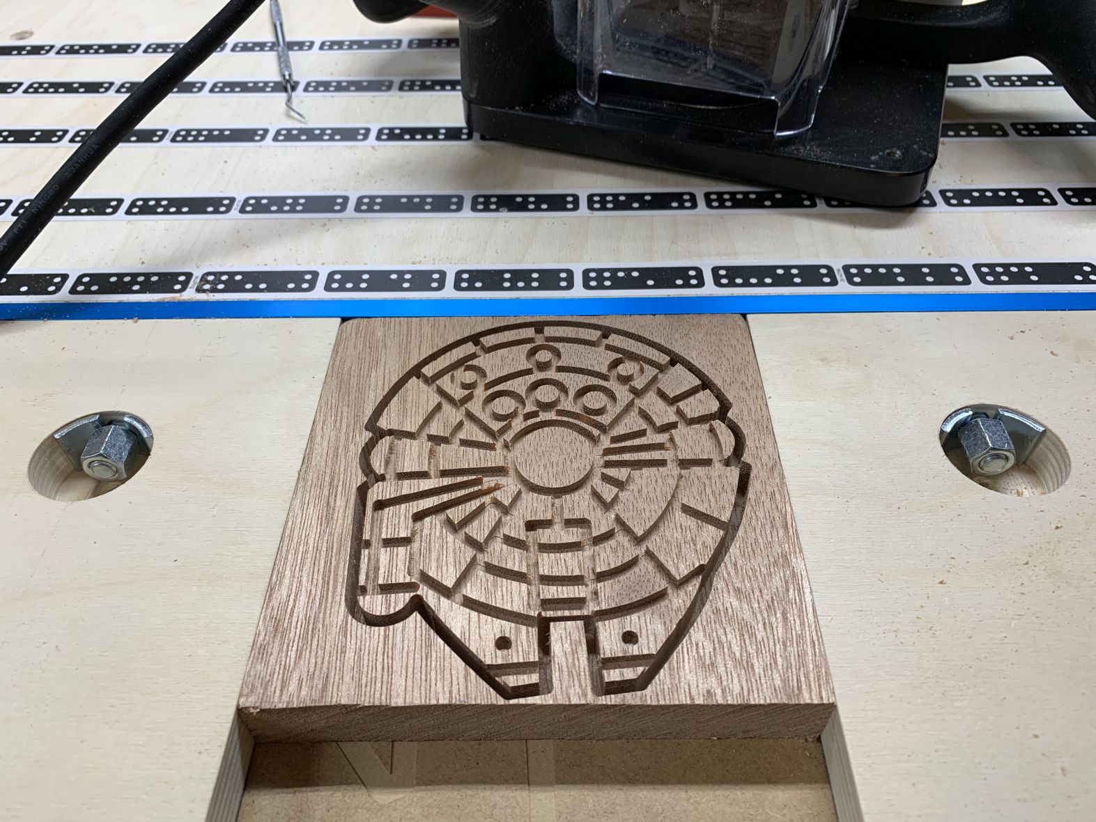

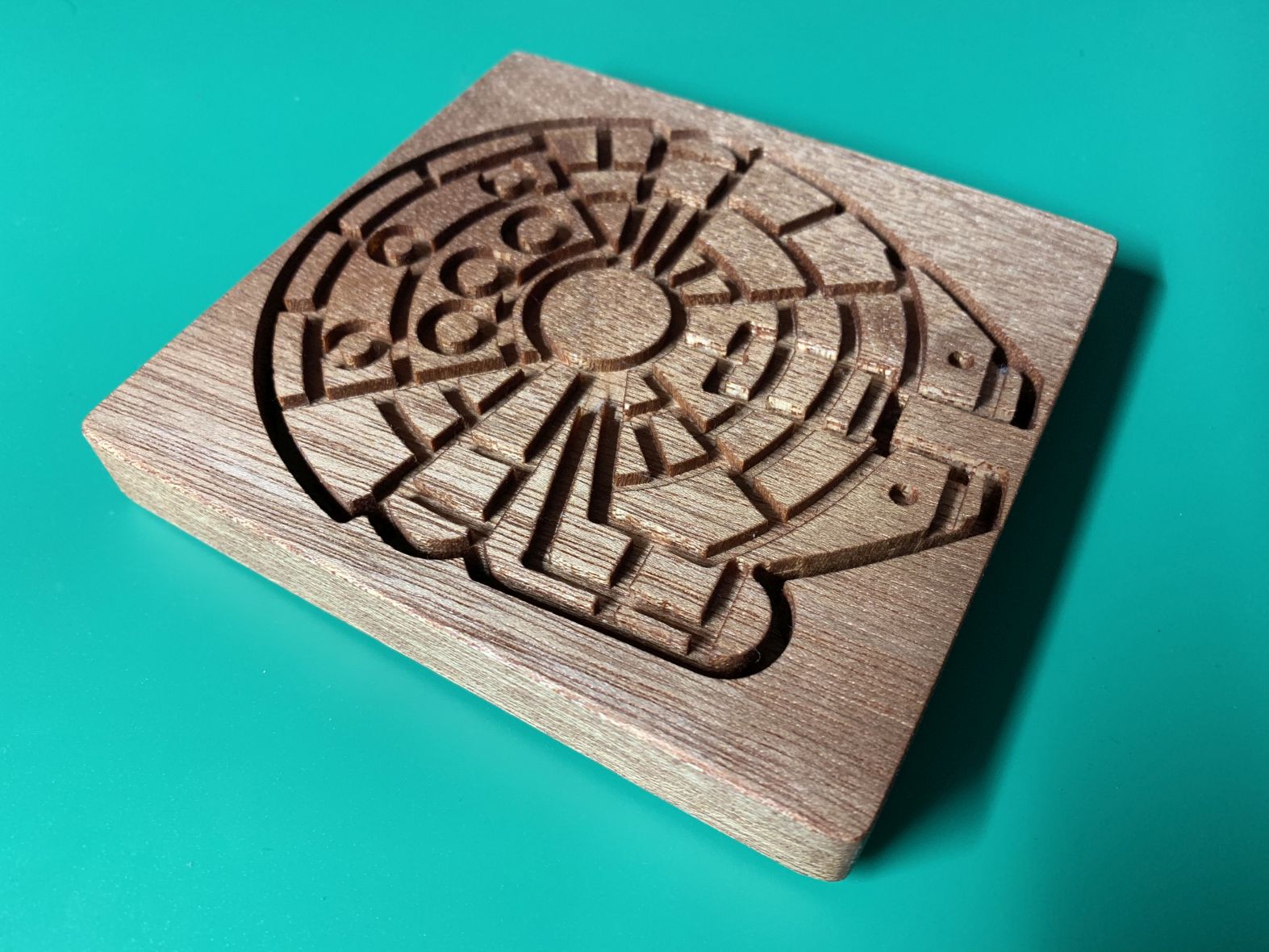

A person over in the Shaper Community posted a Millennium Falcon cheese board with the .svg file. So with my son loving anything and everything star wars this seem like something I really had to do but rather then a cheese board I went with the idea of a trivet.
Here it is just cut out and vacuumed:
Mahogany would not have been my first choice but that is what I had, well I could have used pine or plywood but hey who ever heard of a space ship made out of pine??
I didn't get it centered well but I trimmed the left edge before I sanded it. It now has a finish drying so maybe another picture of the finished trivet.

BTW it is now officially the "Mahogany Falcon". I delivered it today so I guess Christmas is here along with winter as of today.
