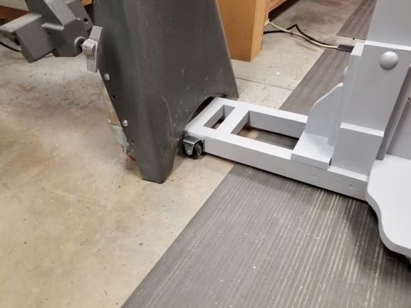

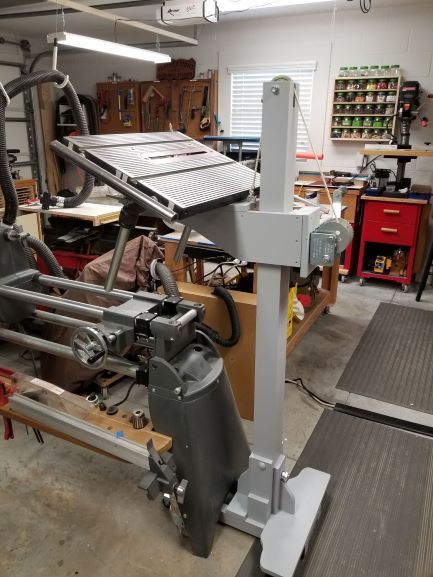

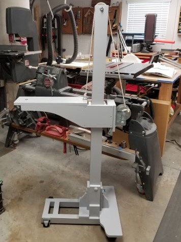

The attached photos will show what I came up with. I thought that I would send this out because more than a few of us Shopsmith owner are getting a little older and if this helped me it may help others. It cost less than $50 to build because I already had a spare half sheet of plywood. I just want myself and others to keep making sawdust as log as possible.

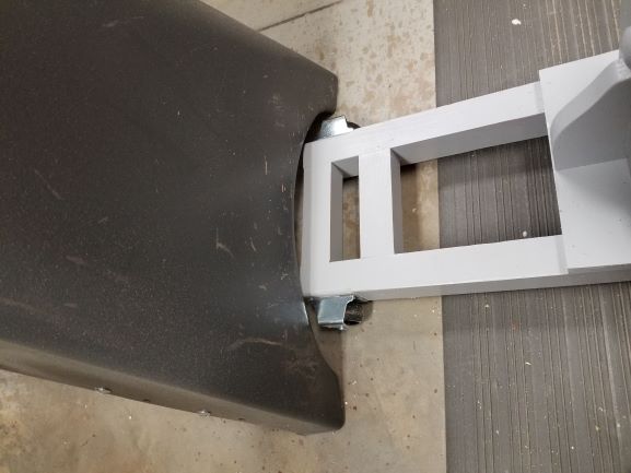

Here are some additional pictures. While the wheels were a special order they were very reasonable.
- Lifts the table
- Hoist2-1.jpg (1.92 MiB) Viewed 26386 times
- Travels between wheels
- hoist2-2.jpg (32.07 KiB) Viewed 26386 times
- Special order side mount wheels
- hoist2-3.jpg (36.21 KiB) Viewed 26386 times

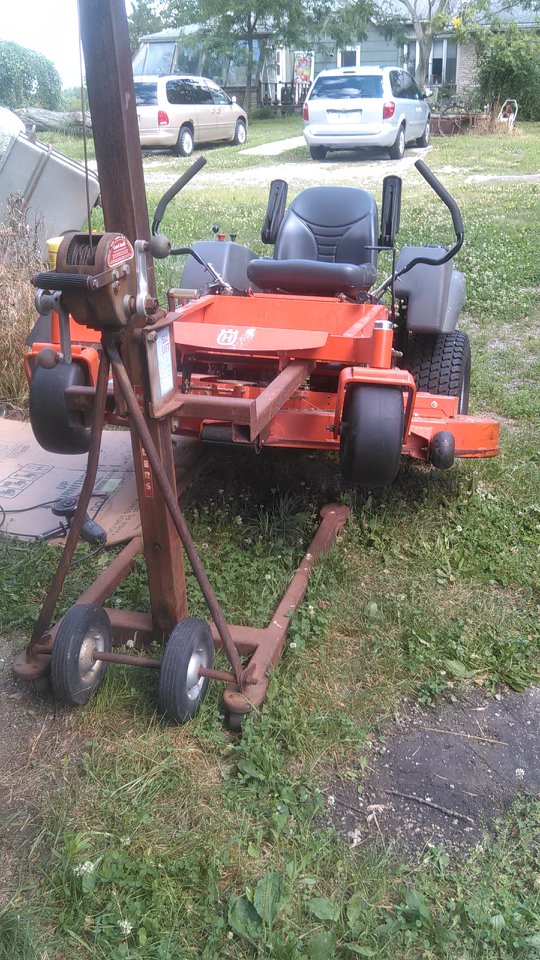

I'm familiar with the concept.
Here is a website where they sell these new. I bought mine used at auction for $75.
https://industrialladder.com/vermette-m ... y-500-lbs/
