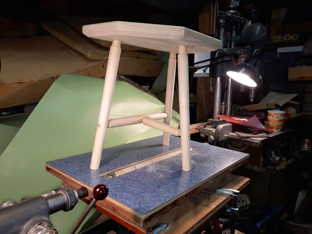

Made from a piece of pine 2x12 that I had in stock. All work done with the 10ER, SS bandsaw and hand tools.
Leveling the feet with the V-drum sander.
leveling the feet.jpg (173.14 KiB) Viewed 21964 times

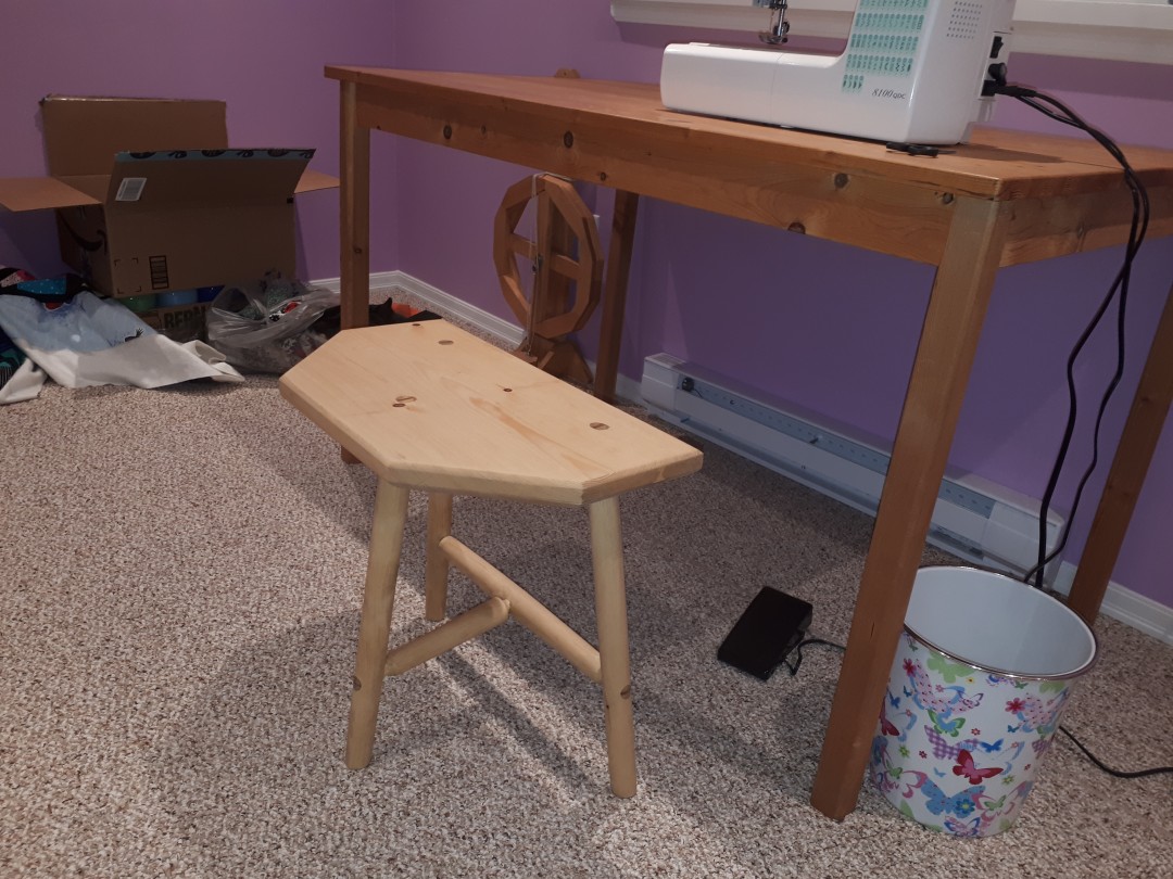

Finished stool.
finished stool.jpg (223.48 KiB) Viewed 21964 times
Turned out okay, learned lots and the next one will be better. :)

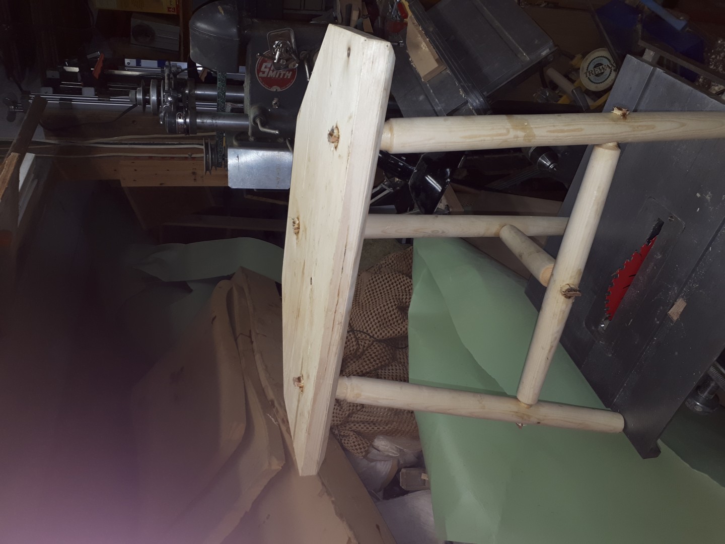

davebodner wrote:What did you use to cut the tenons?
The tenons through the seat are tapered, I roughed them in on the lathe (10ER) and finished with a 5/8" tapered tenon cutter from Lee Valley.
http://www.leevalley.com/us/wood/page.a ... 2288,54835
The tenons on the stretchers are straight 5/8" and I turned them on the lathe.
The mortises were drilled 5/8" and the ones in the seat were opened up to match the tenons with a large standard reamer from Lee Valley.
http://www.leevalley.com/us/wood/page.a ... 3317,54864
The wedges are oak and I cut them on the bandsaw.
This is after the glue up (liquid hide glue), and before the tenons were trimmed flush.
after glue up.jpg (209.98 KiB) Viewed 21849 times
