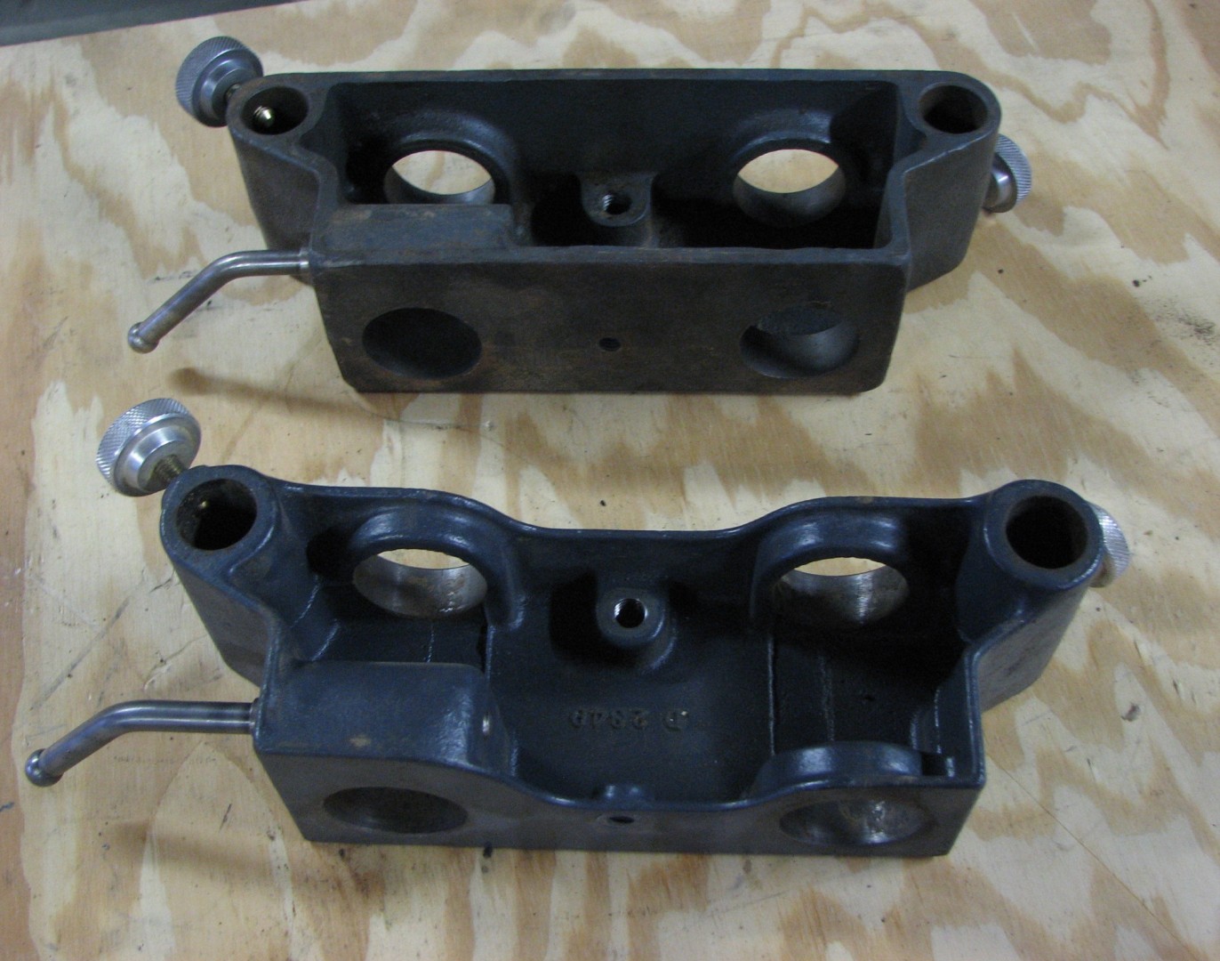

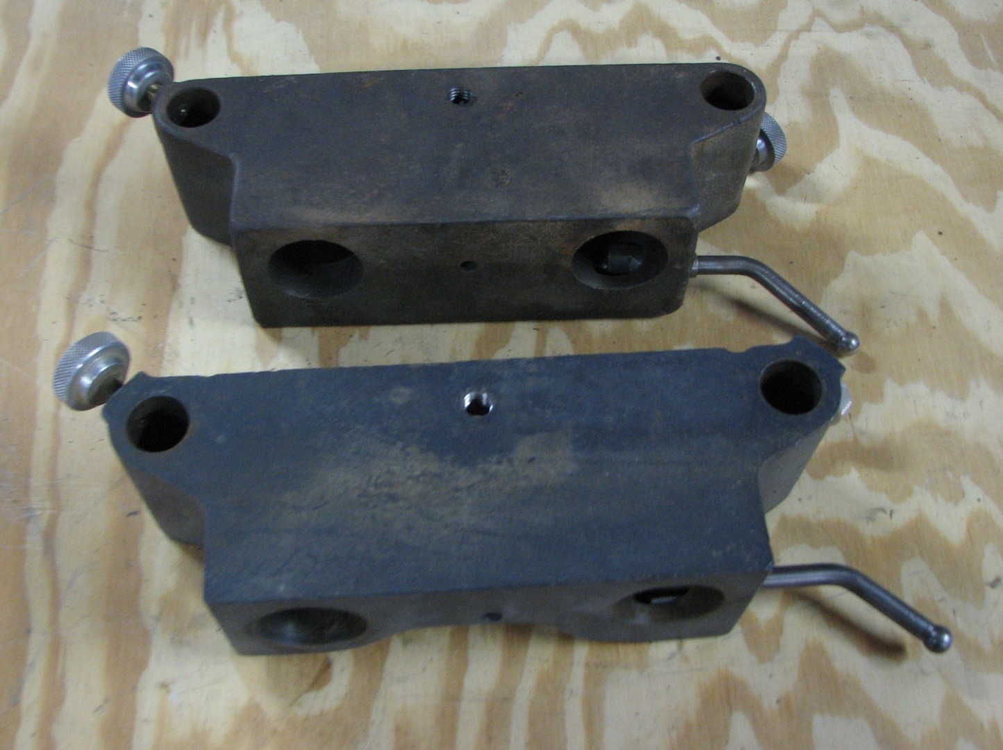

Does anyone know anything about this carriage? In all my many many years of watching eBay daily I have never seen one like that. At least I don't remember if I ever did.
Larry, please tell us what the serial number is.
https://www.shopsmith.com/ss_forum/gene ... 22438.html

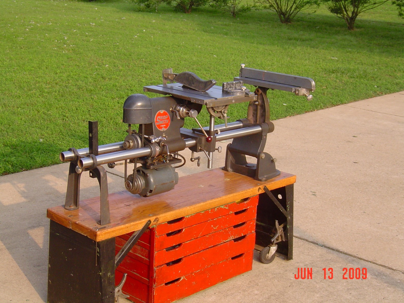

Picked it up at a pawn shop in Mountain Home, Arkansas by way of Ebay if I remember correctly. Pics are the day I got it home and unloaded. I think I found the PO name in Skip's list but not sure I read the spread sheet right. This one has the thinner? waytubes, the table tubes are hollow, the headrest is the two bolt style and seems much lighter than the four bolt style.The carriage is different. Of course I didn't know any of this when I got it, I just knew I had a 10ER

I thought I had seen a second carriage style before.
For those who are interested but not members there...

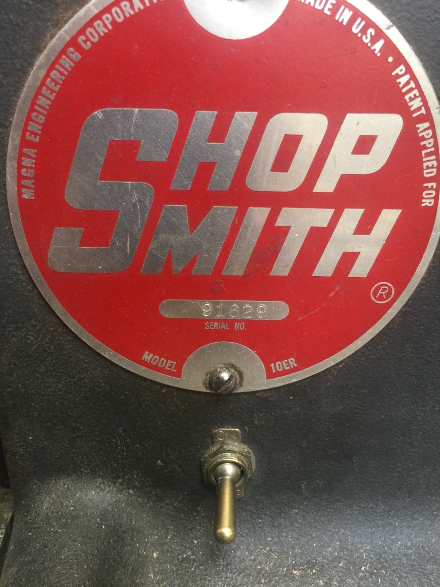

ps I saw the serial number on Larry's, so I went up to the shop and checked my #3 (Serial #94987, currently awaiting re-assembly), and it too has that later style carriage. I hadn't noticed that before.

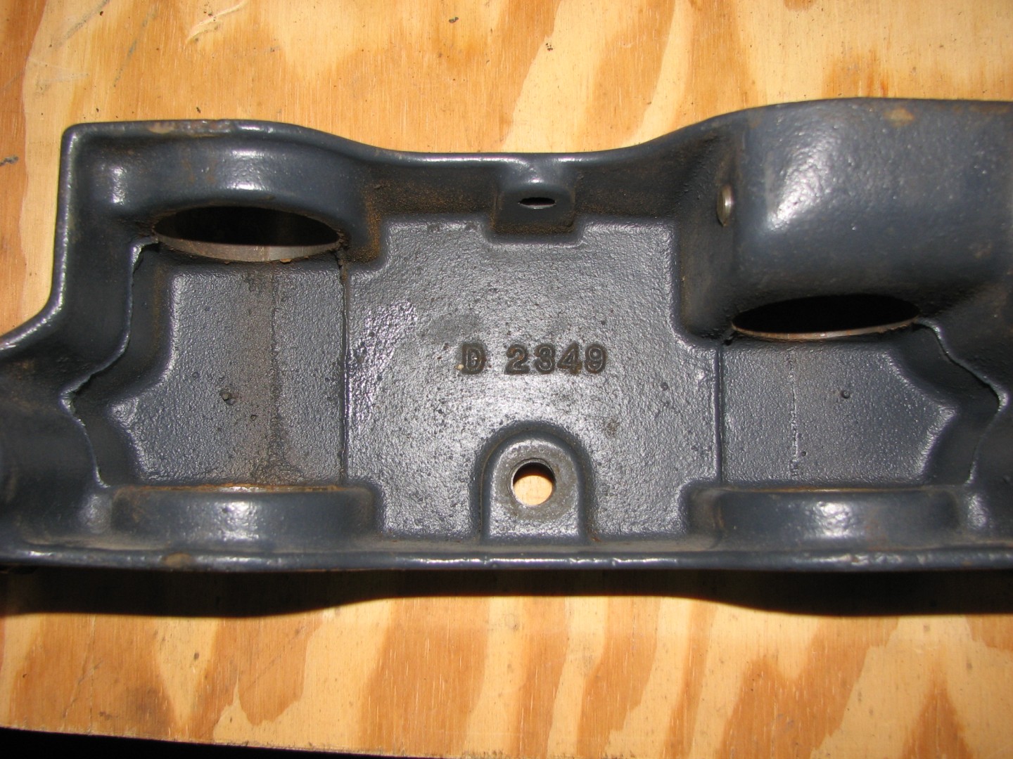

Hi John,
It is the third version of the carriage. I call it the light weight version. The first two I am sure you are familiar with. The original was the double wedge lock and the second was the single wedge lock. This one came out on the later Model 10ER around the same time as the 1/8" thick way tubes. Hollow table tubes and the last version, which is 7, of the headstock with the access hole behind the nameplate had already come out. The latest Model 10ER I have had is serial number 76928 which had the hollow table tubes and version 7 of the headstock. I have yet to own a 10ER that came with this carriage or thin wall way tubes. It is these changes that make the question How Much Does a Model 10E or 10ER Weigh hard to answer.

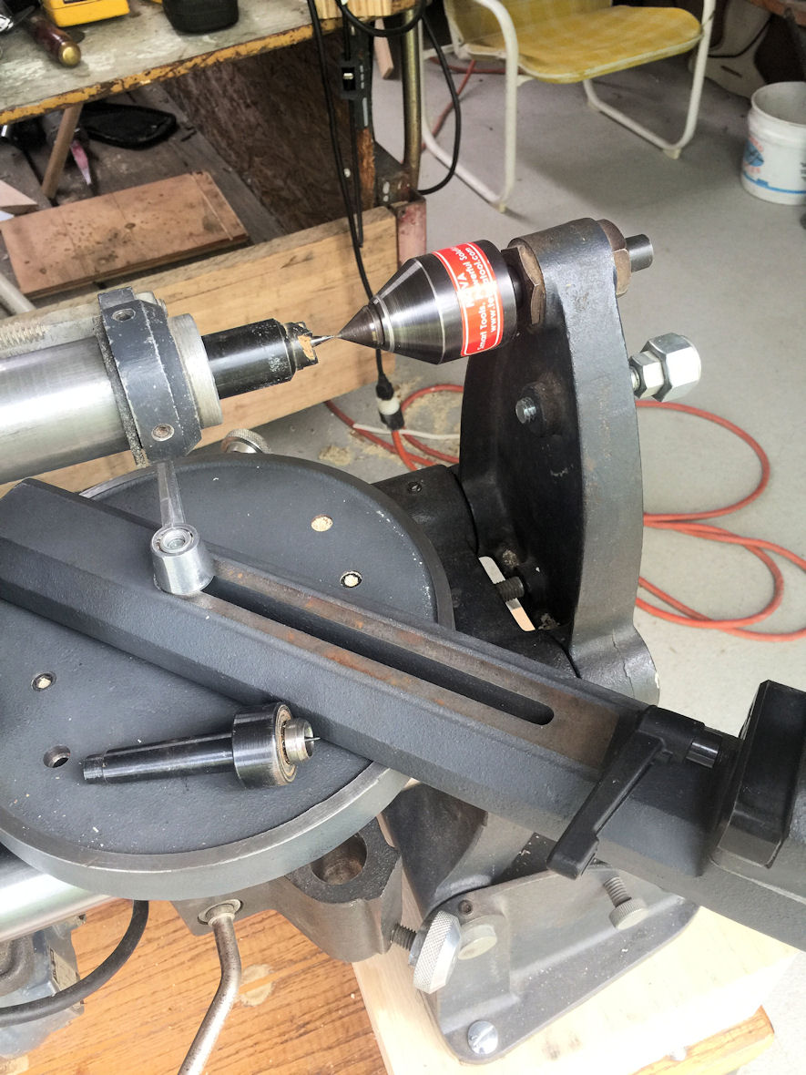

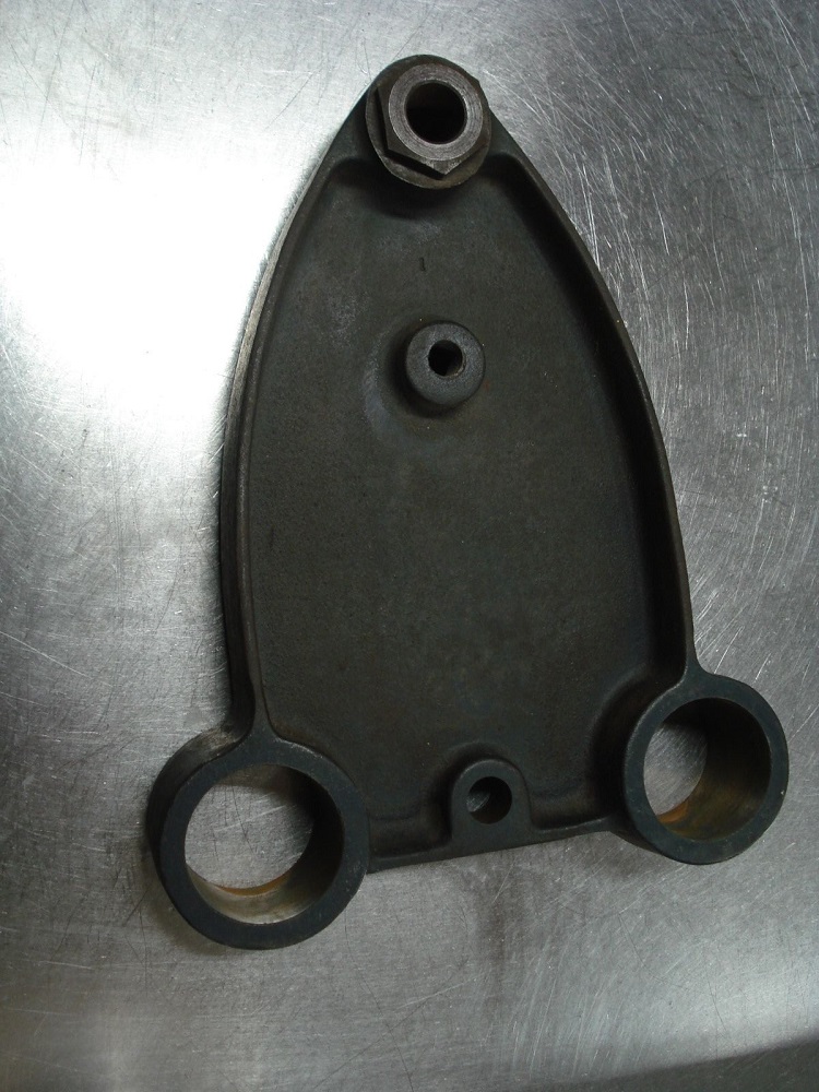

Looking at the pictures of Larry's 10ER it appears his has these later changes. Of interest though his does not have the last version of the tailstock. Notice the rib down the center of his but the last version (number 4) no longer has that rib as seen in the picture below.

That may not be the original tailstock. I had bought an extra to be able to mount extension tables on both ends. I'll check later.chapmanruss wrote:
Looking at the pictures of Larry's 10ER it appears his has these later changes. Of interest though his does not have the last version of the tailstock. Notice the rib down the center of his but the last version (number 4) no longer has that rib as seen in the picture below.Tailstock D2342 V4 r.jpg
Oops, should have looked at my own pictures, the tailstock shown is how I got it. I'll still look to see if my extra has the rib.
