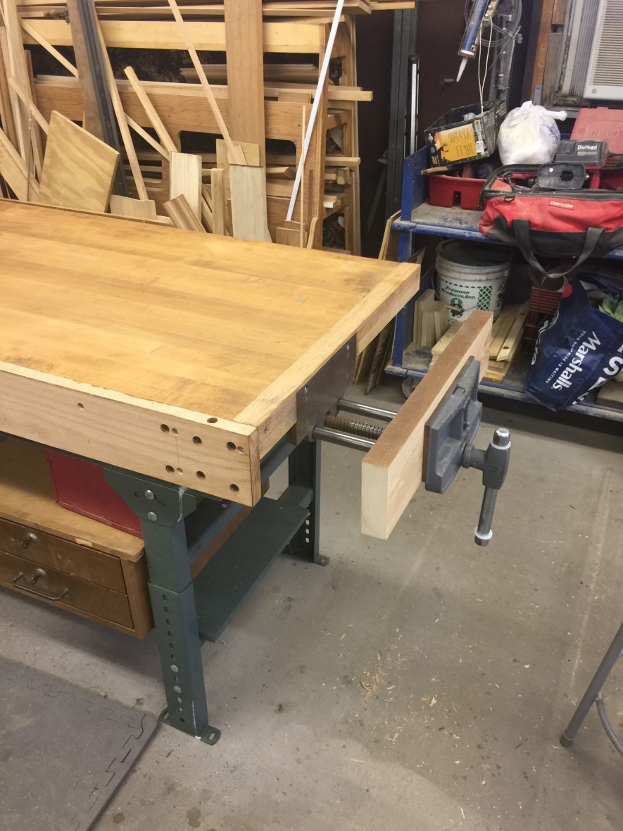

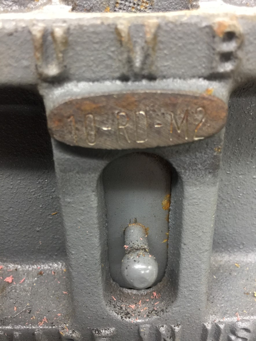

Saw this from carbonman today, http://www.shopsmith.com/ss_forum/viewt ... 03#p259103 and noticed the vise.

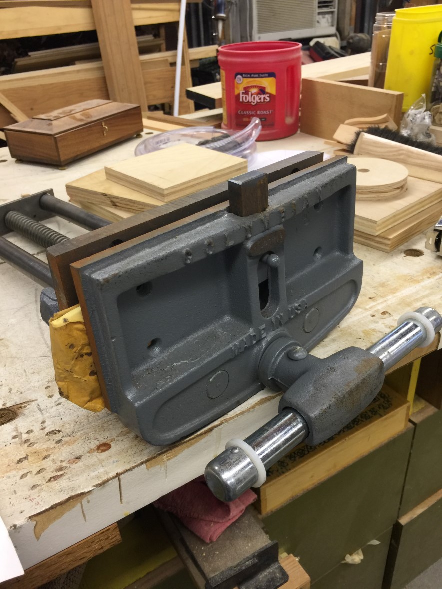

I have one of these, NOS, :D Columbian vise, purchased in 1978 from Lowes and unboxed Tuesday. Update time frame, most likely 1990-1995. I was working out of town in Monroe, La when I bought it. Time flies :o :o
IMG_0333 (Custom).JPG (241.85 KiB) Viewed 34581 times
IMG_0314 (Custom).JPG (224.33 KiB) Viewed 34581 times

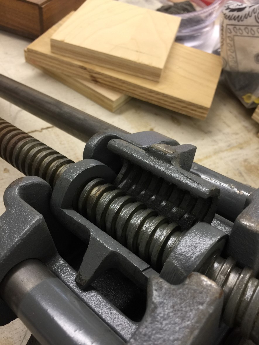

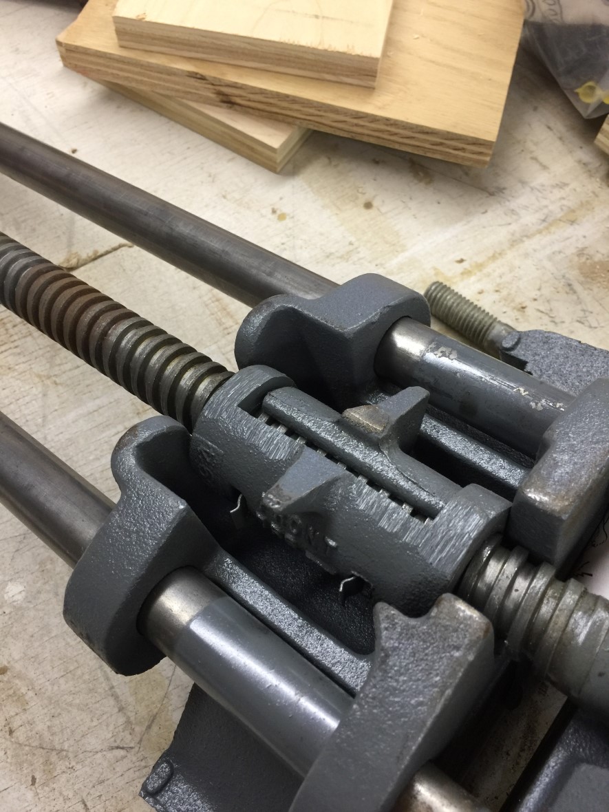

I like the release mechanism.
IMG_0327 (Custom).JPG (245.92 KiB) Viewed 34581 times
IMG_0329 (Custom).JPG (209.9 KiB) Viewed 34581 times

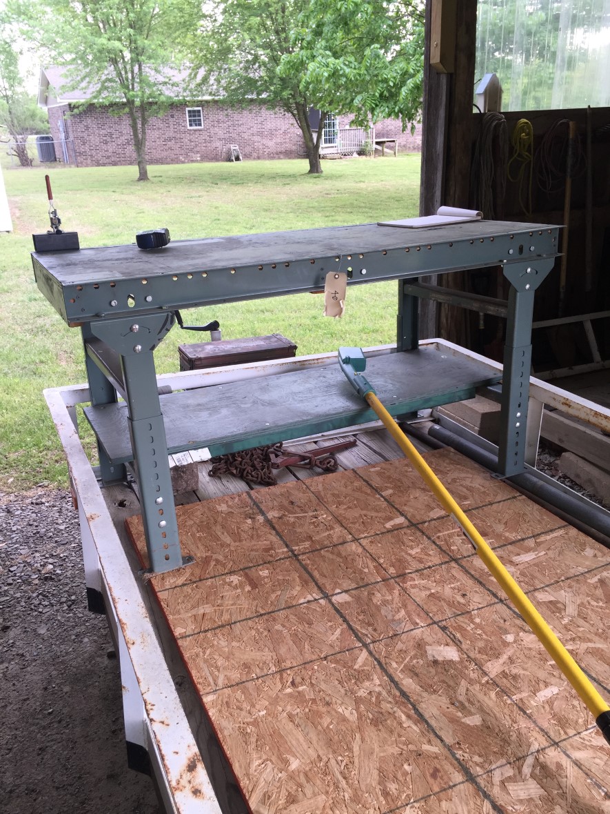

I have a 30x72x1-3/4 maple top that is NOS from Grainger that I got for $50 at least 20 years ago, no pic. And a steel bench free from my brother last Saturday.

but decided I really liked this one much better.
That release is much easier to use than the quick release handle on the Record vise.
No idea how many projects /fixes have been through this vise over the years. It operates just like brand new.

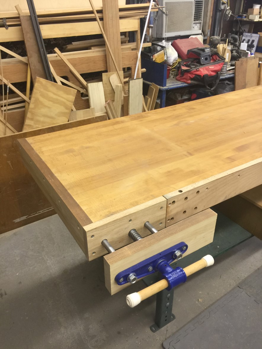

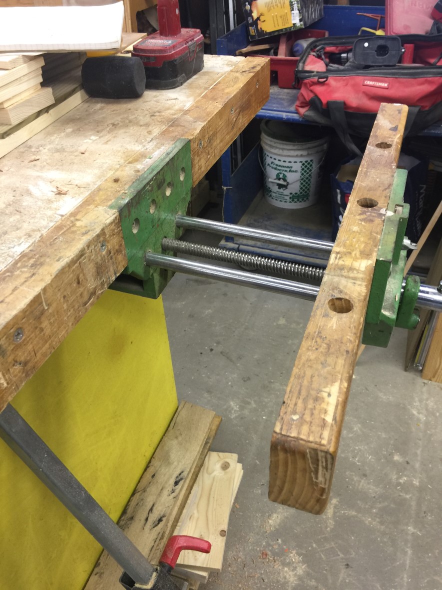

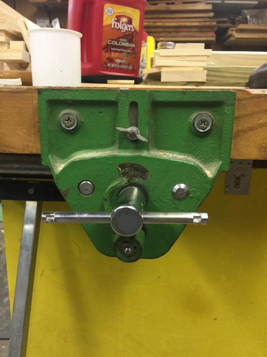

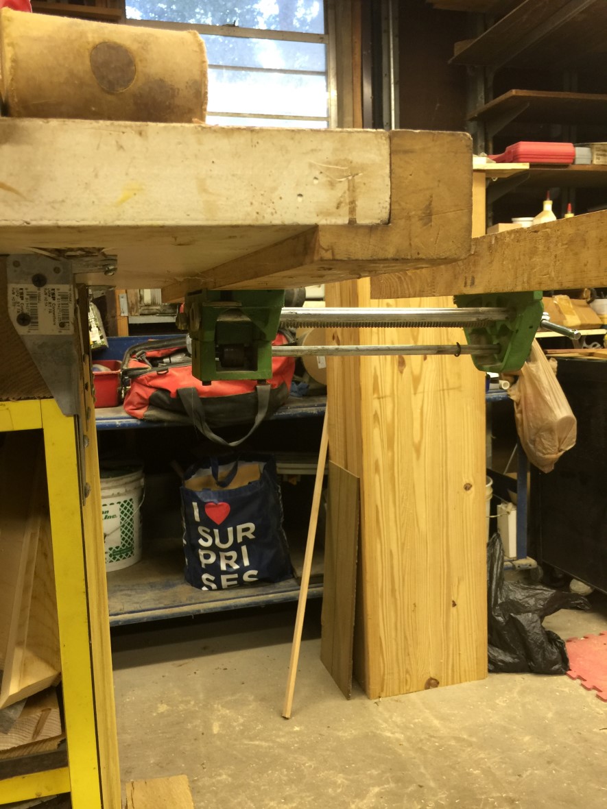

Progress. Not done but closer. The bench I'm replacing is an old 24x72 base cabinet store fixture, all particle board(heavy) with laminate and an old 36x84 solid core door for the top. I mounted a Pittsburgh vise to it.
Old door with Pittsburgh end vise
IMG_0352 (Custom).JPG (246.68 KiB) Viewed 34208 times
Pittsburgh vise
Pittsburgh vise
IMG_0354 (Custom).JPG (184.89 KiB) Viewed 34208 times
Pittsburgh bottom mounting. Also there are two drops from a 2x6 laminated beam. Had them for 10 years.
IMG_0362 (Custom).JPG (222.43 KiB) Viewed 34208 times

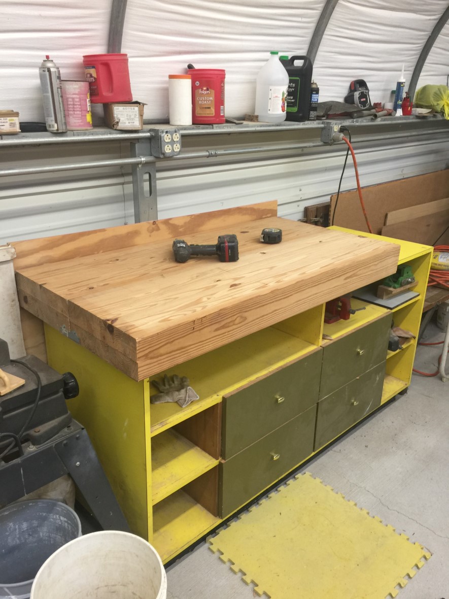

Using the old base to hold my NOS maple top while fitting the Columbian vise.
Old base, new top, temporary
IMG_0378 (Custom).JPG (220.15 KiB) Viewed 34208 times
And the old base moved to my other shop with the two 2x6 glue lams set on it.
Repurposed base and glue lam beams
IMG_0407 (Custom).JPG (220 KiB) Viewed 34208 times

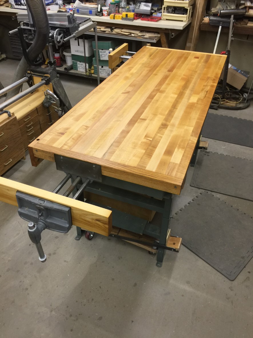

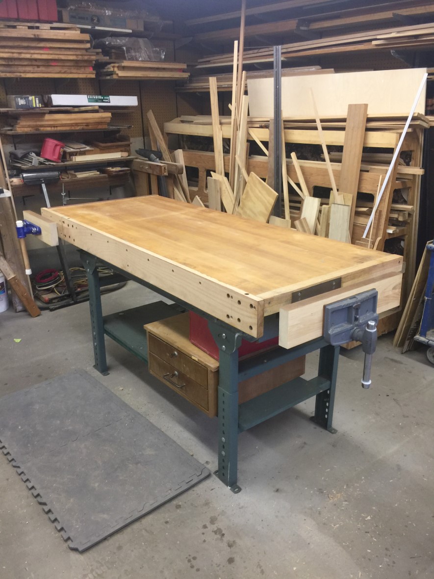

Finally, my progress as of today. NOS maple top, Yost front vise,Columbian end vise, mounted to the steel bench my brother gave me. Still have to trim the side boards level to the maple top and drill the bench dog holes. Any suggestions for a finish? I don't think I want it too slick.
IMG_0404 (Custom).JPG (225.48 KiB) Viewed 34208 times
Yost vise
Yost vise
IMG_0405 (Custom).JPG (219.55 KiB) Viewed 34208 times
Columbian vise
Columbian vise
IMG_0406 (Custom).JPG (232.39 KiB) Viewed 34208 times

Its been a while, I think I used Tung oil (or something similar) on mine.
Posts: 35457
Re: Workbench finally, maybe
Linseed oil comes to mind.

+1 on a oil finish ! maybe even a piece of leather glued to the inside of the vice's

A little more progress, two coats of linseed oil and 1 coat of Johnson's wax. I may not have let the linseed oil cure long enough, the wax seems a little sticky and can still smell the oil. Also added the leather and added wheels.
IMG_0496 (Custom).JPG (230.84 KiB) Viewed 32862 times
Still working on the dog holes. Can't find the picture with the leather, but it's there :)
