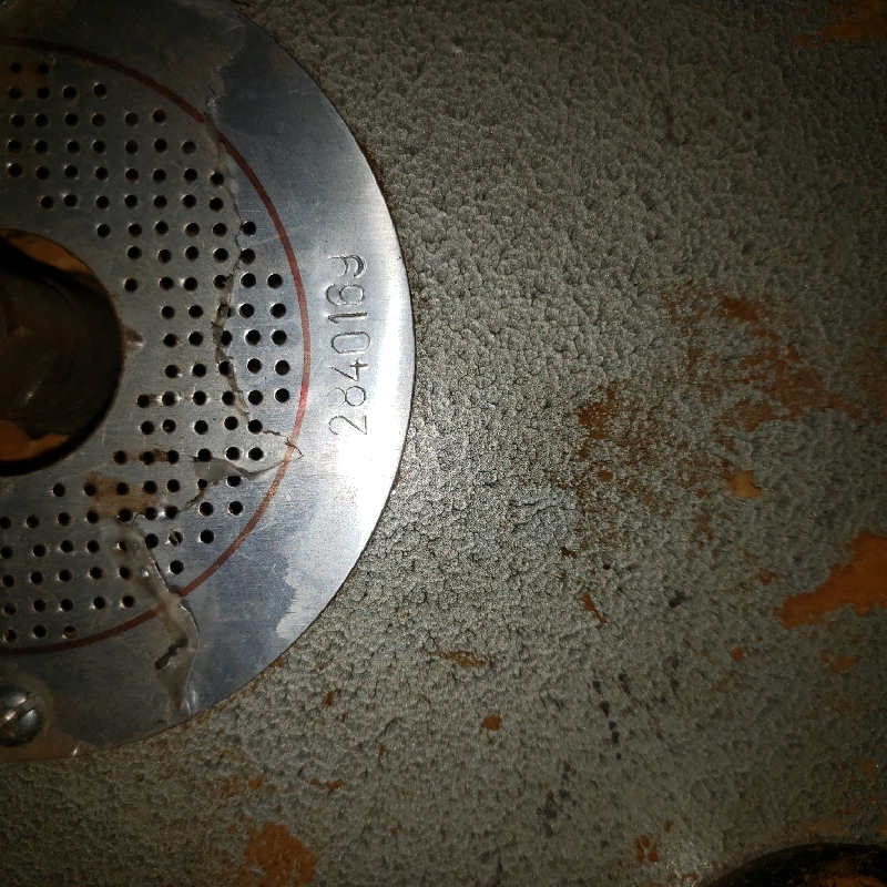

Hello new member here. I'm trying to figure out what machine I have
To get some missing parts everything I have found on serial numbers
Stop at a 6 digit number. I have one with 7 digits. I always have to be
Different it seems. 2840169 is the number If anyone has any info to share on what model
It is and how old it would be greatly appreciated
Thank you
Jim

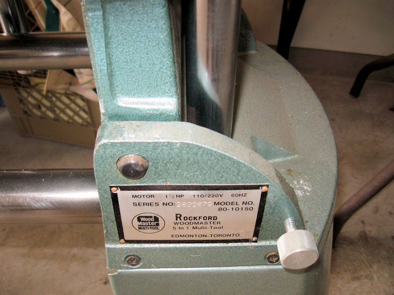

I'm wondering. Could we be talking about a clone? That might explain the unfamiliar 7-digit serial number.
As previously stated, pictures, pictures, pictures.
Snapperscustoms

Will get some pictures this eavning a clone? I was wondering that myself
Were there many clones out there?
Posts: 4534
Re: 7 digit serial number
I had wondered that myself but was waiting for pictures first.
Snapperscustoms you asked
The answer is yes.
Over the years the Shopsmith Mark V has been copied and sold as a cheaper alternative to the Real Shopsmith Mark V. Some of these tools have a label on the base part (where the machine hinge is to put it in drill press mode) with the product’s Information and serial number. See the example in the picture below. On a real Shopsmith Mark V this information is on the belt cover vent plate and on newer machines the serial # and model # are on an additional sticker on the belt cover. This plate, and sticker on newer machines, will say Mark V, or Mark 5 on machines made before early 1980, and have the company name that made it. The company names (newest to oldest) are RLF Brands LLC, RLF Shop LLC, Shopsmith Inc., Magna American Corporation, Yuba Power Products, Magna Power Tool Corporation or Magna Engineering Corporation. The “Clones” some of which are made in China or Taiwan, have different names like Total Shop, Wood Master, PHD 500, Central Machinery and others. Because they are copies of the real Shopsmith Mark V some parts may be interchangeable, many are not. Shopsmith has fought in court and won against companies making these “Clone” machines but many used machines are still out there. My advice for anyone wanting to buy a used Shopsmith Tool or part check to see you are getting a Real Shopsmith item. Remember Shopsmith repair or replacement parts if needed are still available from the manufacturer but not parts for clones.

Snapperscustoms
Silver Member
Posts: 8
Joined: Wed Sep 18, 2019 10:48 pm
Post by Snapperscustoms »
I cant figure out how to get my pictures small enuf to upload
The serial number is on that cover plate but nothing anyplace else
Will keep trying to get pictures smaller to send out
