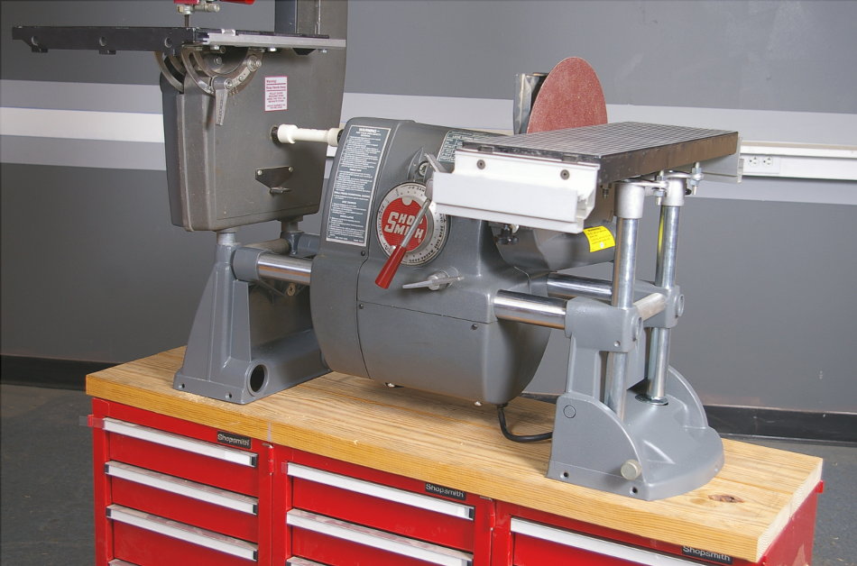

Just spitballin' here. One of the things I've always disliked about both Mk 5s I've owned is that they are too damn tall. I'm only 5'3" so if the saw table is raised high enough to cut, say, a 3/8" deep dado, the table is hitting me mid-to-upper-torso. Not a good height to maintain downward pressure on the workpiece, among other issues. So, after seeing a few photos of 10ERs I got to thinking (a dangerous endeavor, I know), What if I were to take my Mk 5 off of the sheet metal legs and mount it onto a custom built bench/cabinet made the right height so that I don't have to stand on a stool to operate the saw safely (not sure how safe it is to stand on a stool while running the saw but...). Retractable casters could be incorporated into the design so that I'd still maintain portablility. My "shop" is a one-car carport so I'm definitely hurting for space. Thank goodness Arizona weather is so cooperative.
So, anyone know of this being done before? Any photos? Any obvious pitfalls that I'd need to plan for or that would render the idea completely un-doable? Like I say, just spitballin' right now. Haven't even been outside to look at my SS yet to see if it looks feasible since this idea just came to me late last night.

Like this
This is shortened length as well
Shopsmith sells a Shop Deputy Kit to do this, so read about it and you could do this to suit your needs without buying the Shop Deputy conversion

I looked at my SS today and can see that I would need to drill large holes in each end of the base's top in order to allow the auxiliary table to be lowered all the way since its "legs" extend below the lower way tube (not sure if I have the terminology of the tubes correct). But that wouldn't be a biggie. What is a little more problematic is being able to lower the saw table since it's "legs" also extend lower then the lower tube. I have a couple ideas but they're hard to describe. I'll see if I can draw them up and post them as a jpg.

everettdavis wrote:Like this
Yeah, that's basically what I have in mind. I'll do a little research on the Shop Deputy. Thanks.

Hey! FWIW, I just realized that I don't even need the lower tubes if I do a "Deputy-style" conversion.
