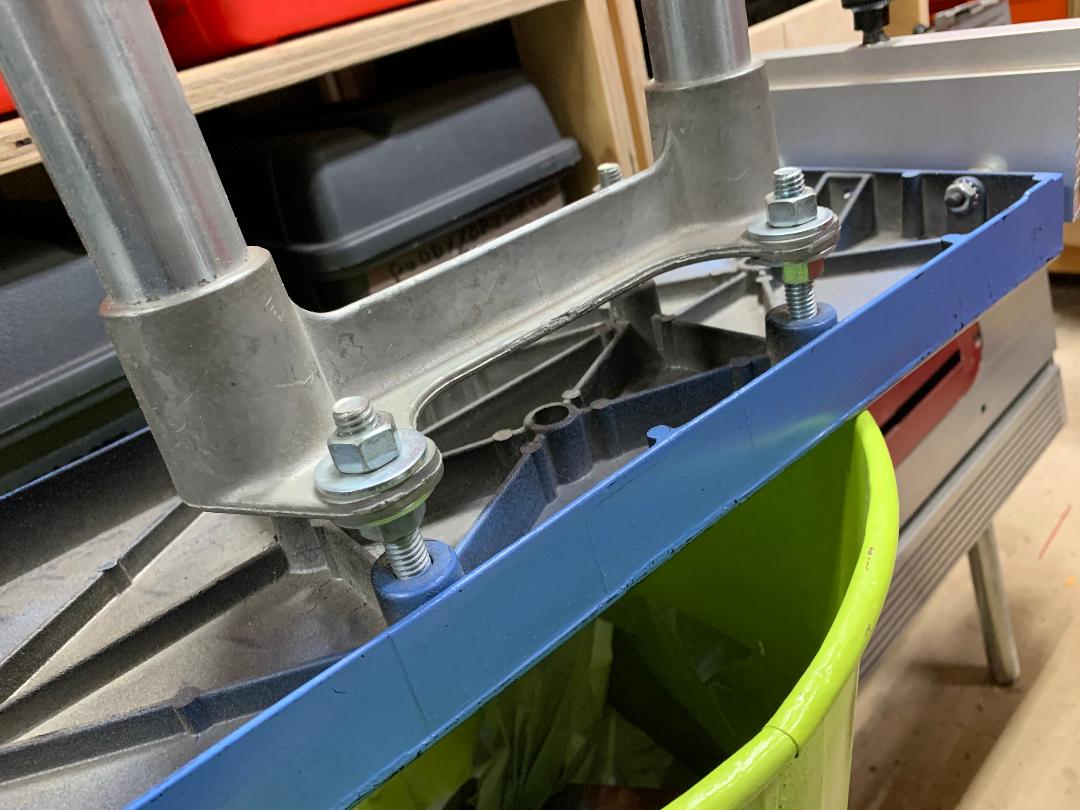

The "dog bone" should not be directly bolted to the table. There should be threaded studs in the table that attach the "dog bone" to the table with nuts top and bottom as JPG said. A picture would help.
Re: Extension table alignment problem
It should look something like this:
We are all assuming you were accurate when you stated you were dealing with a MK7. If you have an older model the 'dogbone' is indeed simply bolted to the table. Altering with studs and nuts/washers will get you what a MK7 has as described .

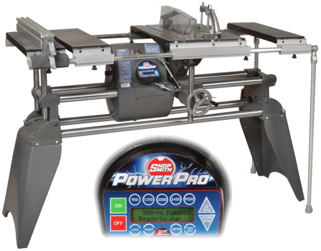

Lets back up a bit. Is you Shopsmith a Mark 7 as shown below.
Or is it a Mark VII from the 1960's as shown below.

If it is the newer Mark 7 as shown in the first picture the bottom of the Extension Table should look like the one Ed posted except for the blue paint. Nice color Ed. If so replace the missing nuts and washers before trying to align it. There should be 8 nuts and 8 washers.

Thank you all. Yes my saw looks like a Mark7 but it started life as a 5. I'll try putting in threaded rod like the photo and see if it gives me the room. David
