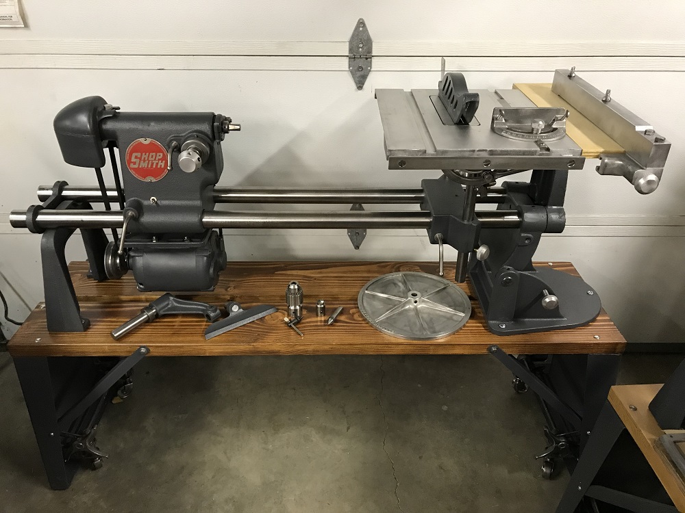

I have used Rustoleum Charcoal Gray paint for all my Model 10 restorations. After trying several gray colors for my first restoration (10ER S/N R64000) I found it to be the closest match to the original paint color. It is a gloss finish and later I started to add a matte finish clear coat. I like the matte finish better. The Charcoal Gray comes out to a near perfect match compared to the original paint on the belt guard, blade guard, Miter, etc. I plan, at some point when I have the time, to touch up the paint on my original restoration and add the matte finish. Below is a more recent restoration with the matte finish.
1077 restored 11-14-18.jpg (234.12 KiB) Viewed 11507 times
Below is my first restoration with a gloss finish. The picture was taken shortly after it was restored. There have been some changes to it.
10ER R64000 with Jig Saw r.jpg (156.5 KiB) Viewed 11507 times
You can see the gloss shine on the Jig Saw belt cover area and the Belt Cover on the bench.

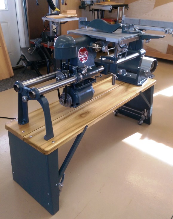

jsburger wrote in 2018 that
"As for paint, the best match to the original according to Skip Campbell the 10ER guru is Krylon Industrial Tough Coat. The paint is S01625 Blue/Grey and the primer for it is S00340 Grey. It is not easy to find. The big box stores do not cary it. I get mine from MSC Industrial. Their numbers for the paint are 84253772 and the primer is 02512317.
The picture is one of my restored 10ER's with that paint."
Original post https://www.shopsmith.com/ss_forum/view ... 65#p243965
I have re-attached the photo he included of his done with that paint realizing that photo lighting can make paint colors vary.
Hope this helps
Everett
Posts: 6585
Re: 10ER Paint - 1625 Blue/Grey discontinued
everettdavis wrote:jsburger wrote in 2018 that
Hope this helps
Everett
I just checked and MSC industrial still lists them both and they are in stock.
