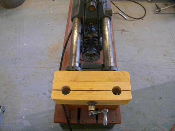

Re: Mark V attachments on 10E/R platform?
A cheaper alternative.
10ER SPT Mount als shipwright.JPG (188.24 KiB) Viewed 4666 times
