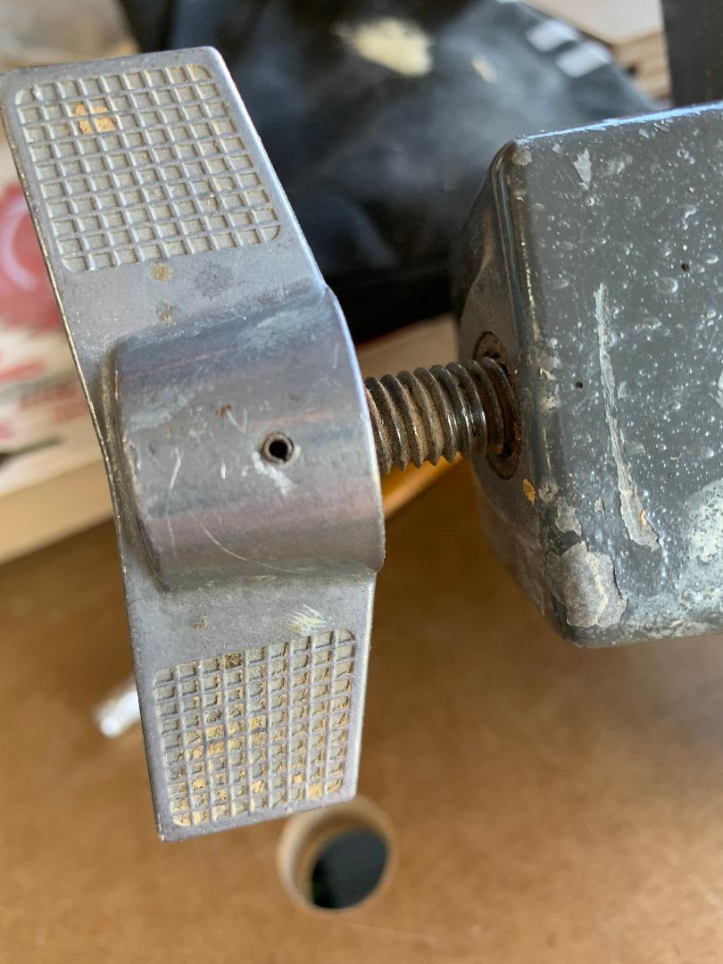

I do believe that the "wing Nut" is supposed to be attached to the threaded shaft with a rollpin.
Shopsmith Catalog item #240, P/N 514384. If this info is correct, any appropriately sized roll pin would work.

That would be a great design, but on my fence, neither the nut nor the threaded shaft are drilled with a hole for a roll pin. The design on the parts diagram looks like an improved design. Thanks for the help

I have a 510 fence that I have parted out but I have the part you need if it will fit your version. I'll get a picture later and if you are interested I could send it off to you.

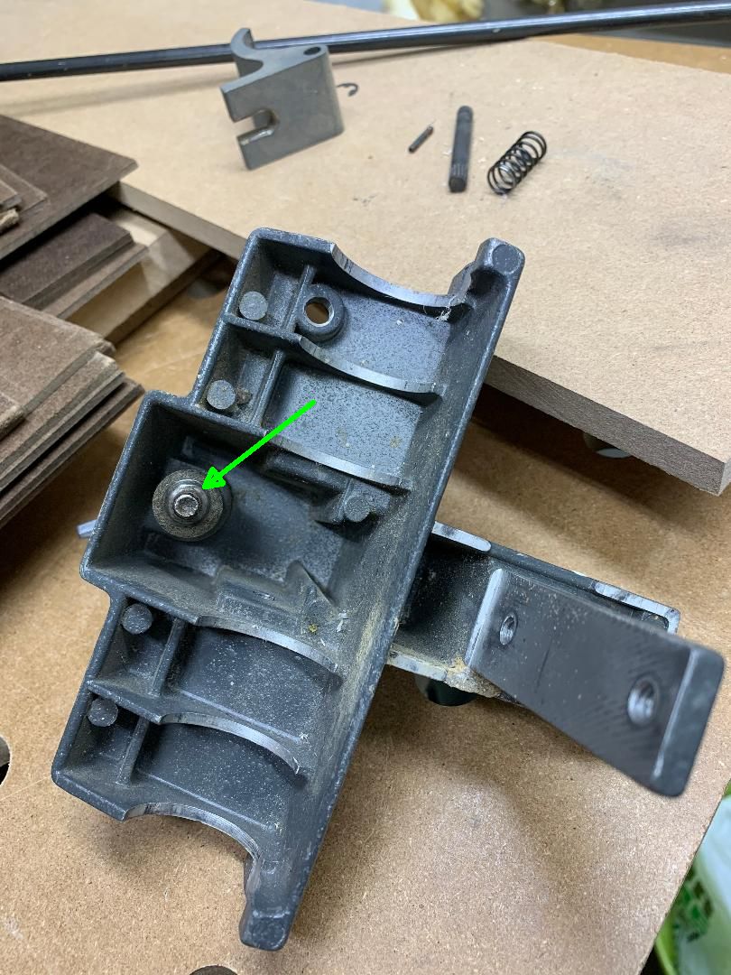

Problem is I'm not sure how you get it out. Anyone know how to get the bit off the end (see green arrow).

my guess would be to take the wing nut off than run it out to inside.

I believe that you are right. If the threads were clean, I believe that it might run out the inside. HOWEVER, ......I tried that and it did not work. I then put a drill bit in the roll pin hole (for leverage) and was able to screw it in further but not all the way. It aooears that the threads have been gummed up somehow to prevent this.
Running a tap down on the threads (where the wing nut would be) might clear it up. I don't have a tap that size so I am unable to confirm the theory.

A die might work more gooder. ;)
[Yes, absolutely but even then I don't have the right size die and trying to use a nut to chase the threads did not work either]
Come on Dusty, add yer comments to yer own post!!! :D
Re: Fence Wingnut
Didn't have time to work on this today so stay tuned for what might happen tomorrow. I drive the pin and and take the handle off and see if mine will screw through. As you might have guessed I've not tried to take this area apart before.
I do have a tap and die set so it is possible I have the right parts to clean up the threads if needed.
