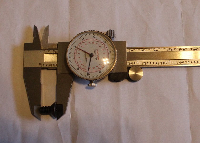

This is primarily intended as a heads-up to anyone that has recently ordered or received this kit. I just received the Infeed/Outfeed Extension Table Brackets 555997. The Flathead screws in my kit were the wrong ones, they were 1/4" - 20 TPI but instead of being 5/8" (0.625") long, as indicated on the parts list in the instructions, they measured only 0.482" long. I didn't check first and immediately stripped the threads in my Table Bracket. The screws connect the Angle to the Table Bracket. The Angle measures 0.308" thick, so with the wrong screws this leaves about 0.174", just over three threads, of engagement. In Aluminum!

I am curious what part of the screw you measured to be '.482'.
Re: Infeed/Outfeed Extension Table Brackets
I measured end to end:
- David

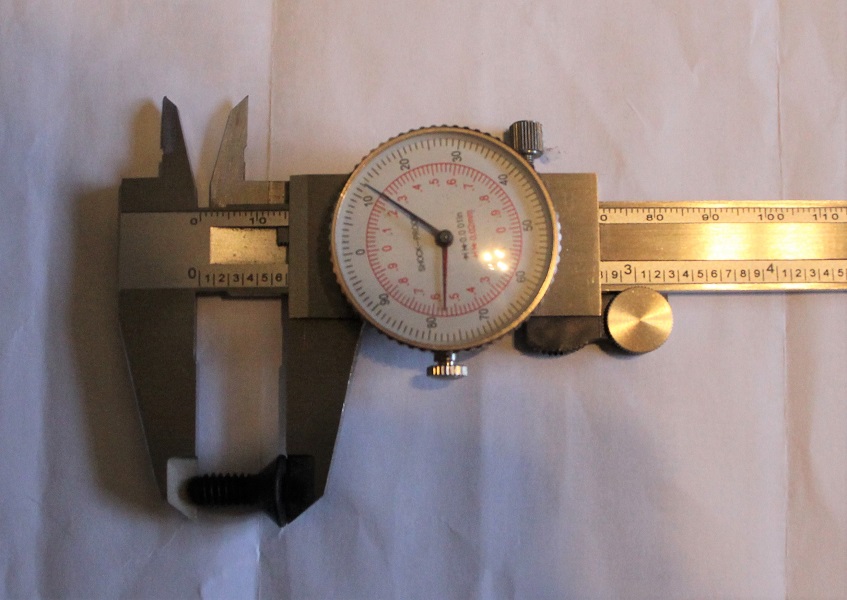

I just received 'correct' replacements. They measured ~.612:
I'm not particularly happy about the service I've received on this. CS did not answer two emails on the subject but did eventually respond by sending the longer screws. The bracket is still stripped, they ignored that part. On my bracket I don't think they'd do anything but strip the threads a little deeper.- David

You measured them correctly! I would follow up and try to make them replace the stripped bracket. I fear you will have to go over someones head to get that. Regardless try to clean up the stripped part and maybe it can be salvaged. Are the holes 'through' holes? Run tap/screw through from the back side??
