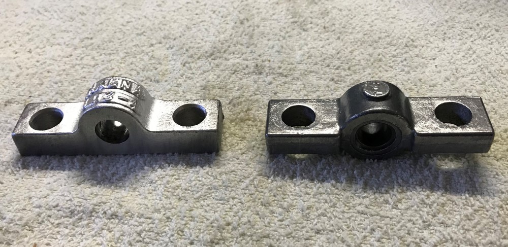

The picture below should help explain what JPG is referring to as far as the Rear Trunnions aka Table Bracket for Model 10's.
Rear Trunnions 10 M500.jpg (160.37 KiB) Viewed 8753 times
The Rear Trunnion or Table Bracket on the left is from a Model 10E and is the same used throughout the Model 10 production. The "bump" side goes up towards the table when reassembling the Model 10's. The Rear Trunnion on the right is from the Mark 5/V 500 original table system and has a casting "bump" on it but the Trunnion itself has the hole for the pivot pin centered unlike the Model 10 part. The casting "bump' is what JPG is referring to for the Mark 5/V. The Rear Trunnion on all other Mark V models (505, 510 & 520) plus the Mark 7 are different so none of this information applies to those models.

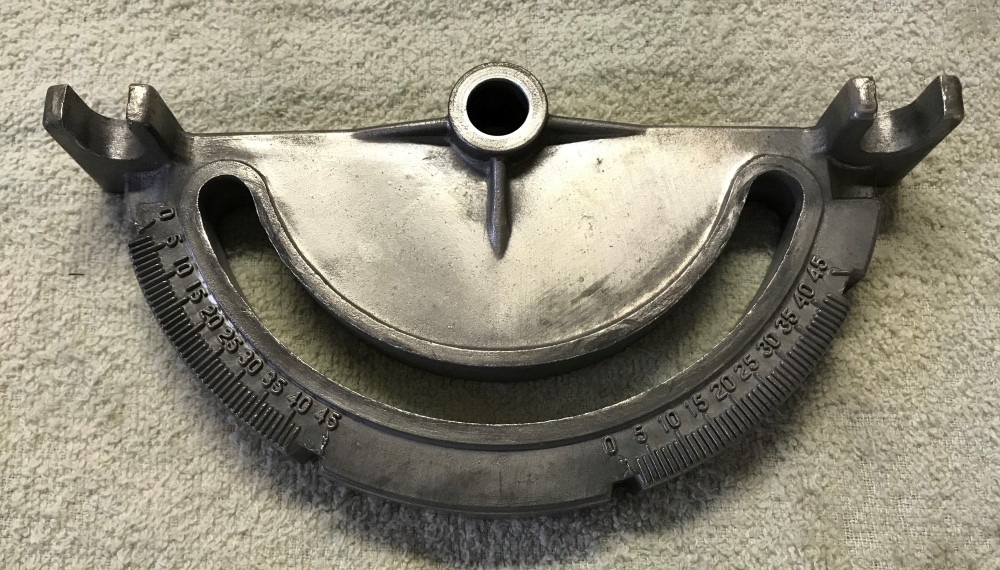

The picture below is the front Trunnion from a Model 10ER. Note the "bump" on the top where the pivot pin goes.
C 2325 Trunnion cr.jpg (203.76 KiB) Viewed 8753 times
I believe that is what JPG is referring to in the quote. JPG will let us know if I have that wrong. Both the Front and Rear Trunnions must have the "bump" up facing the table to be even. The Front Trunnion can only go that way so the Table Bracket aka Rear Trunnion must do the same.
When reassembling the Model 10's table parts it is easy to attach it wrong. I started to do it wrong the other day on the 10ER I just finished restoring. You would think I would not do that after having commented about that here within days of reassembling it. It really seems that the Table Bracket aka Rear Trunnion should go with the "bump" down but NO it doesn't work correctly placed that way. When you compare the Front Trunnion and rear Table Bracket construction it is understandable why they both go with the "bump" up.

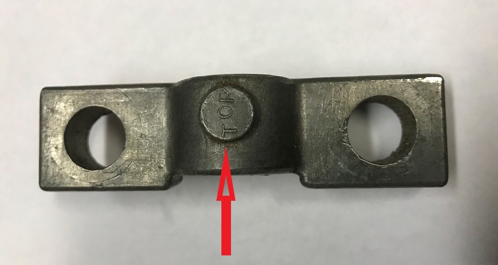

Do you mean the letters TOP on the bump? :eek:
504249 Rear Trunnion arrow.jpg (81.11 KiB) Viewed 8683 times
Another view of that Mark 5/V Rear Trunnion with the letters TOP on the bump. It is what JPG is referring to. Hopefully this thread clears up how the table assemblies go back together as far as the Rear Trunnion aka Table Bracket (for the Model 10s) are positioned.

We would be remiss if we did not mention WHEN the 'top' is up!
The letters are there for whomever assembles the table to the trunion.
That assembly is performed with the table upside down(top of table resting upon a horizontal surface).
As the trunion is attached to the table. the bump needs to face AWAY from the table. Since the table is upside down, the bump must face up as the rear trunion 'mount' is attached to the table. So some assembly engineer decided to include the word 'top' when the rear tunion is cast. That flags the assembly person to attach the rear trunion with the bump facing up(away from the table).
Now the confusion enters when one considers the normal operation orientation of the table when 'right side up'. In that orientation, the bump faces 'down' away from the table and becomes the 'bottom'. :rolleyes:
