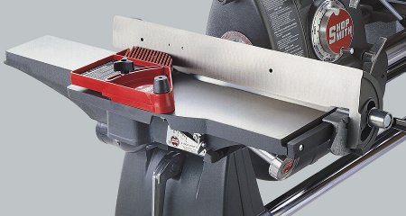

Keep in mind that the Jointer mounts lower than other SPT's. It is powered off the lower Idler Shaft not the upper Drive Shaft. So you don't need to be looking for long mounting tubes. Notice how close it is mounted to the Headrest in the picture below.
Shopsmith catalog picture
