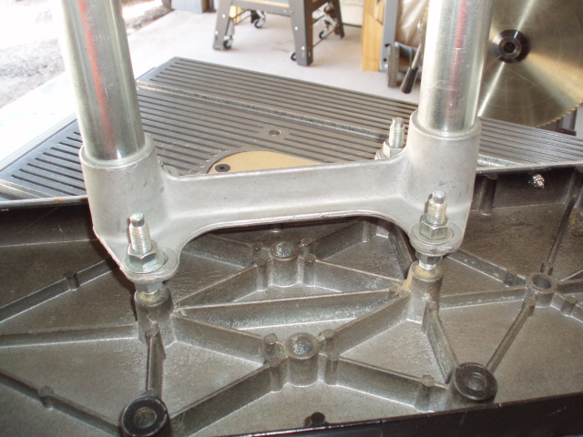

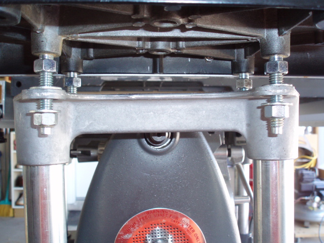

I believe your issue is getting the top table surfaces to be coplanar. The set screw that you mention will not achieve that for you. If fact, Iscrewed mine down to be level with the casting and DO NOT use it.Htrn wrote:I have an older model Mark 5 510 that I got from an uncle many years ago. I have not used it to its full potential but have used it for non critical table sawing, drill press, and sanding. I have recently come into possession of some beautiful pecan lumber and my wife wants me to make a table. I got out the manual and proceeded to do the alignment procedures which went well until I came to the one for aligning the extension table on the power side (left) of the machine. The manual says to mount the extension table on the power side, get it the same height as the worktable and lay a straightedge across the two. If there is a gap, the two tables can be made parallel by loosening the headrest lock and raising the way tubes off the rear pad and raising the setscrew to adjust the position of the powerplant and worktable in relation to the extension table. My problem is that when I get the way tubes shimmed up with washers enough to make the tables parallel as recommended before adjusting the setscrew; the headrest lock is too high to latch. When I get the tables parallel I have raised the way tubes about 3/8" and there is nowhere near that much adjustment allowed in the latch. Also the infeed side and the outfeed side of the table is out of level with the corresponding sides of the worktable. Where am I going wrong with this procedure?
To deal with your stated issue is depicted here and mentioned by JPG.
The nuts shown here are loose (procedure not finished). The table is held in place by the table tubes which are installed in and secured to the rails in the main table. In other words, I attach the tables together and then adjust the nuts accordingly. Hope this helps. I(f not - call back!

I would include a set of washers and jam nuts at the junction of the studs and the table bottom.
