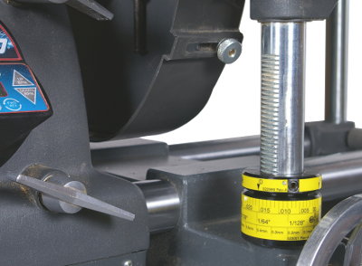

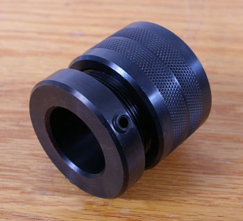

I suppose you could use the table legs in the carriage for vertical adjustment (with the micro adjustable stop collars, seen below), and the carriage could slide along the way tubes as normal, and then build some sort of platform for the base of the router to set on.
