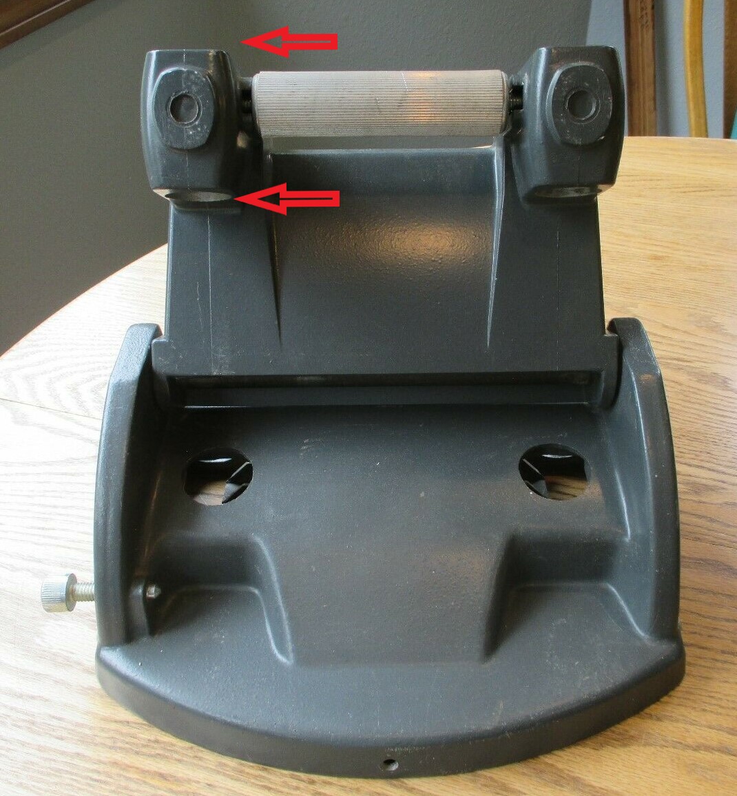

I believe Dusty is correct. Once the tubes pass through the mounting holes, indicated by the arrows in the picture below, there is no additional support provided.
The holes in the base are there only to allow the extension table tubes to pass through when lowered not to provide any support.
Re: Changing extension table tubes
Excellent image. Using this image to suggest a possible solution....you might be able to immobilize the tubes by inserting a wedge between the tubes and the casting.chapmanruss wrote:I believe Dusty is correct. Once the tubes pass through the mounting holes, indicated by the arrows in the picture below, there is no additional support provided.
Base and Arm - arrows.jpgThe holes in the base are there only to allow the extension table tubes to pass through when lowered not to provide any support.
You might also gain some stabilization by wedging between the tubes and the edges of the holes in the base arm.
