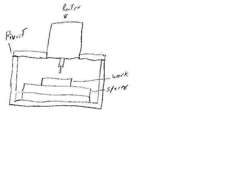

It just dawned on me I didn't explain myself well in the last post. So I quickly drew a picture. Build this jig and mount your router to piviot bar.
The more you extend the bit will increase the arc diameter. Use the spacers to adjust actual depth of cut. The cut is made by tilting the router back and forth causing the bit to swing in an arc. You could also make the support legs that hold the piviot longer or shorter to increase or decrease the arc diameter. Once you got the exact diameter you want you would simply move the jig over your work where you want the slot and tilt the router back and forth and more to the next slot.
Before I did anything I would find a bit small enough to cut the width slot you want. I have seen bits made for laminate and dremel type routers that small.

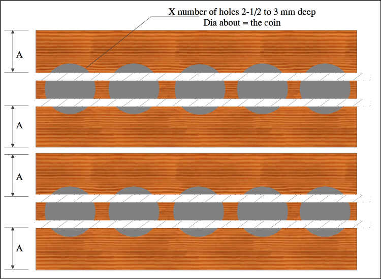

So this is not to confusing I did a couple of sketches to show what I mean. Step one is selecting the wood (more on that in a moment) then deciding on how thick/long/wide you want the finish product. Then find the center and drill the number of holes you want evenly spaced. I have shown two pieces of wood, they each require the two rips shown.
[ATTACH]2331[/ATTACH]

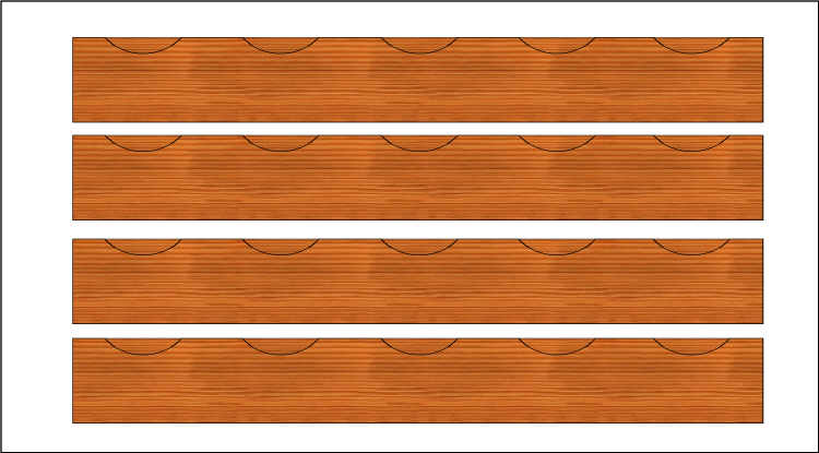

You want all the A's to be the same size so the ripping operation can be done without changing setups, just flip the wood 180 deg and cut again. The results will be a bunch of strips that look like this:
[ATTACH]2332[/ATTACH]

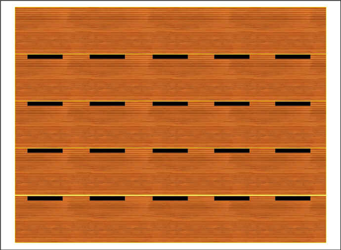

Now for a glue up and finishing. That should look something like this:
[ATTACH]2333[/ATTACH]

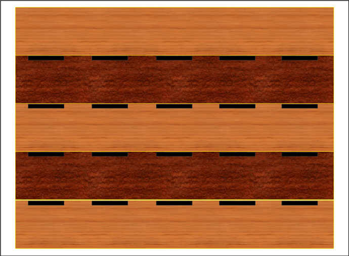

The wood selection or staining could make it interesting as shown:
[ATTACH]2334[/ATTACH]
