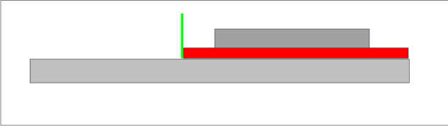

May be a few sketches will help.

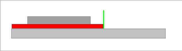

First if you are always going to have the sled on a flat table and never want to use it to cut any other way then left or right shouldn't matter, it becomes personal.
[ATTACH]2387[/ATTACH]

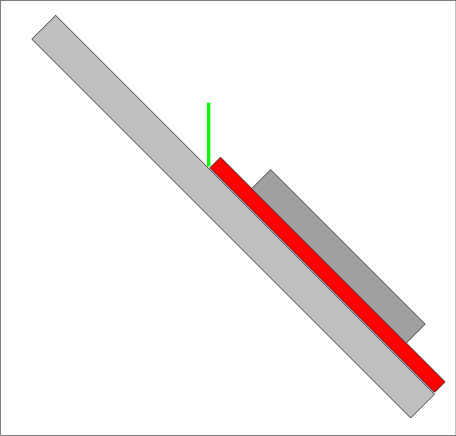

[ATTACH]2388[/ATTACH]

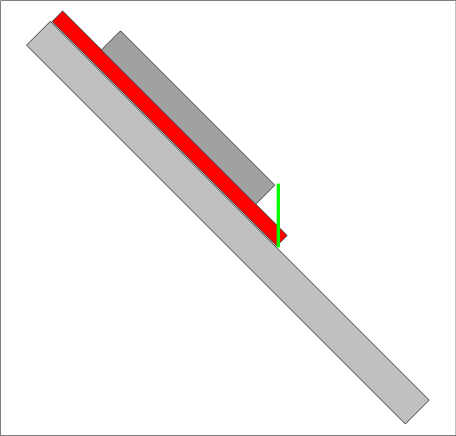

When you want to set the table at an angle be it 1 deg or 45 degs then it maters.
[ATTACH]2389[/ATTACH]
[ATTACH]2390[/ATTACH]
As you can see a part of the incra base is cut away. If you want to use that edge to align to, well it's gone.
Keep in mind this is not to scale or a true representation of the parts but just a quick sketch to show way you may want to do it the way that is pictured on the incra site.
