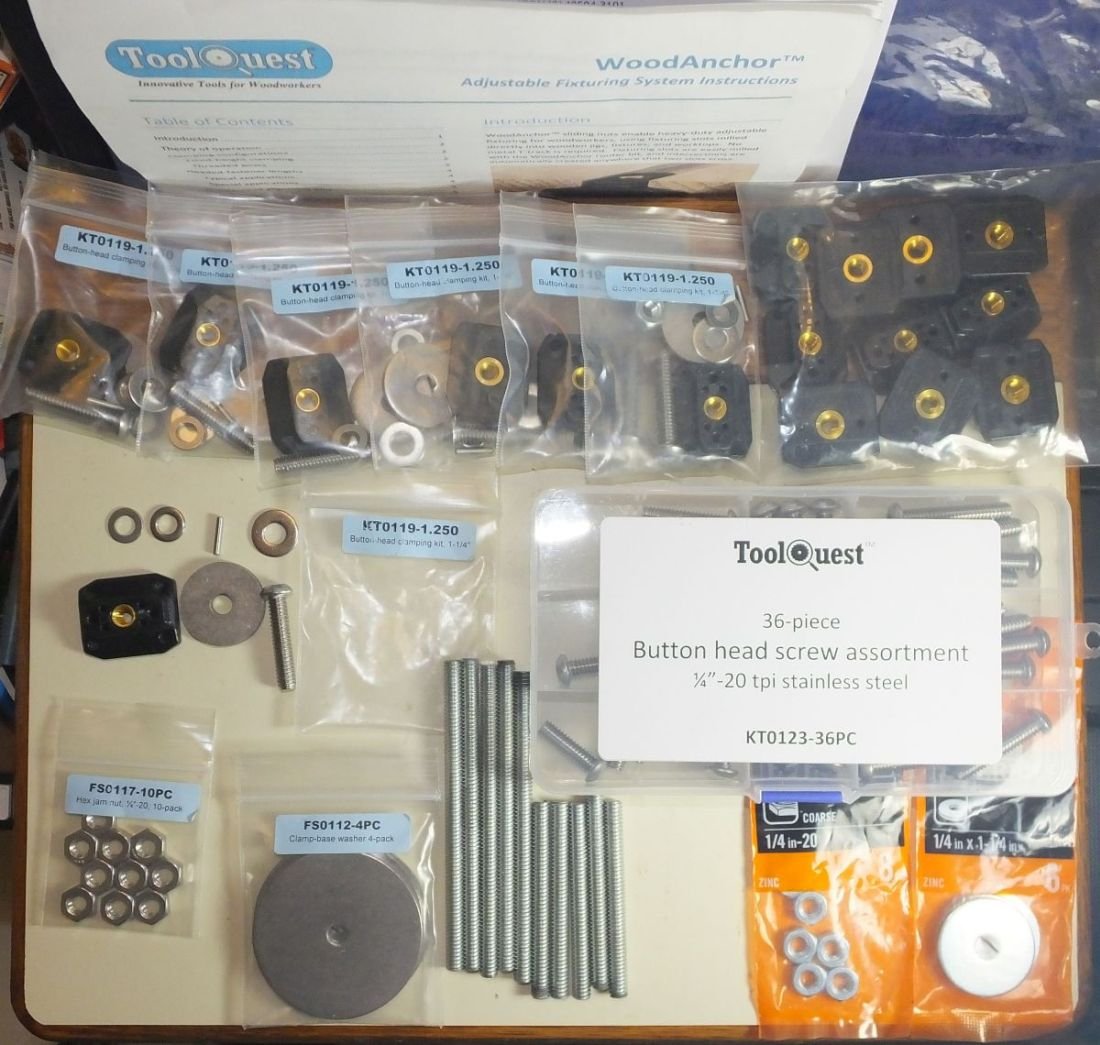

Tool quest stuff comes in cute little plastic bags. Great for shipping etc. but where to store them?
STUFF IN BAGS.jpg (167.55 KiB) Viewed 1298 times
The bags with light blue tags are from Tool Quest.
The orange bags are Home depot stuff.
The studs are all thread cut to same lengths as Tool quest studs(not as pretty but will suffice).
The screw box is really good though small. It will be retained as is for the moment.

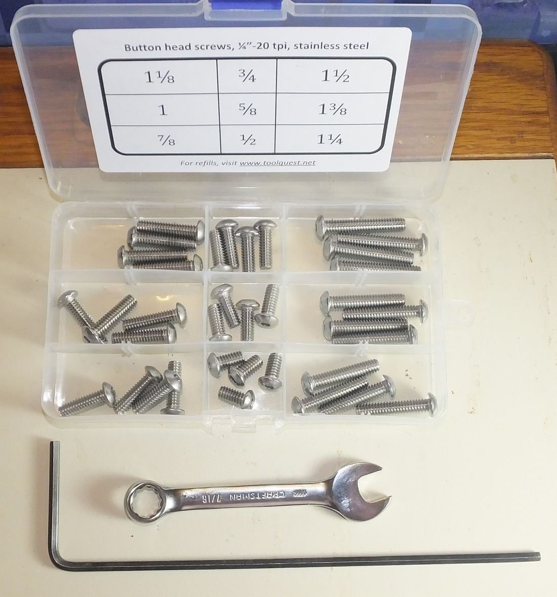

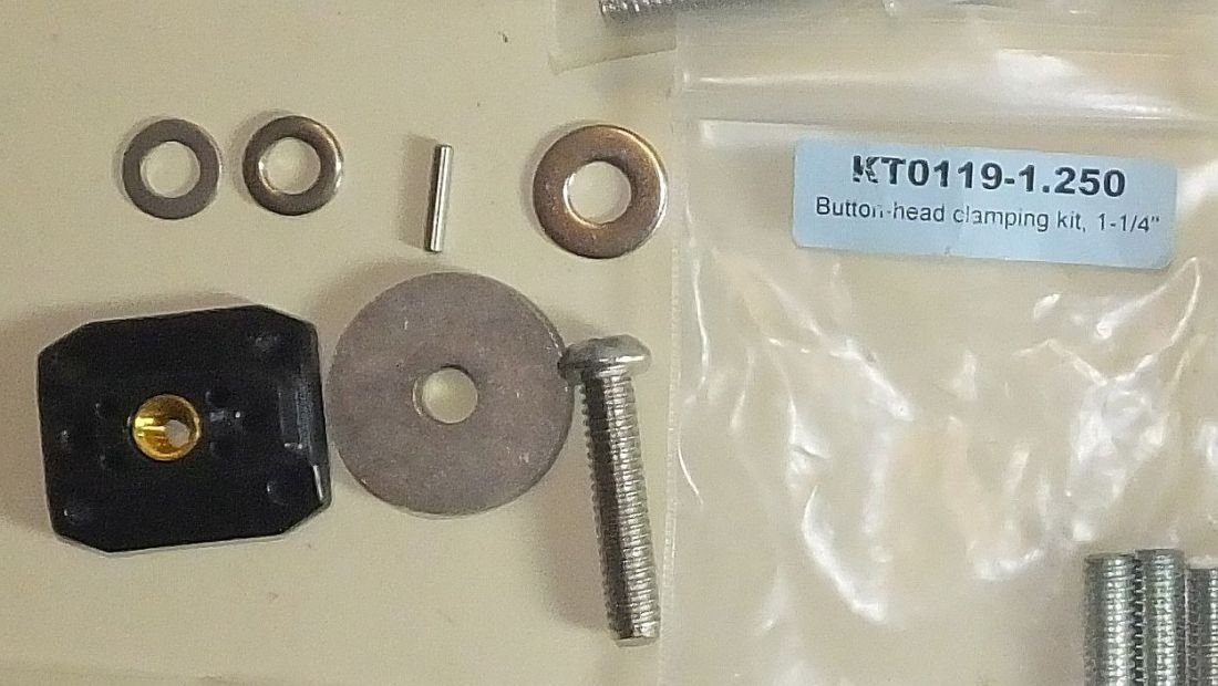

The clamping kit (KT0119-1.250) contains two different 1/2" od washers, one 5/8" od washer,one 1 1/8" od washer, one screw, one pin in addition to the anchor nut.
In addition to all that two wrenches need to be stored.
SCREWS & WRENCHES.jpg (176.46 KiB) Viewed 1298 times
The screw box contains 9 differnt length screws.
The special router bit will be stored with all my other router bits.
That first picture has over 125 'pieces'.

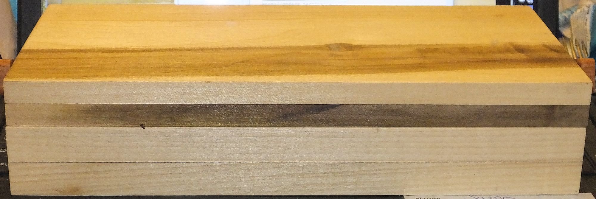

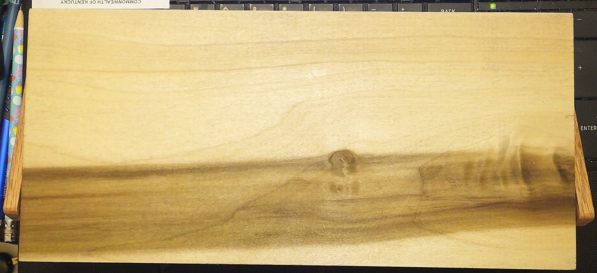

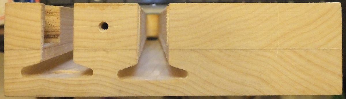

So here goes. first some top/end/back pix. The hunk of poplar is made from a~1"x~6"-2' sawed in half and glued with crowned faces opposing so as to flatten it out(yes under stress).
LEFT END.jpg (53.91 KiB) Viewed 1246 times

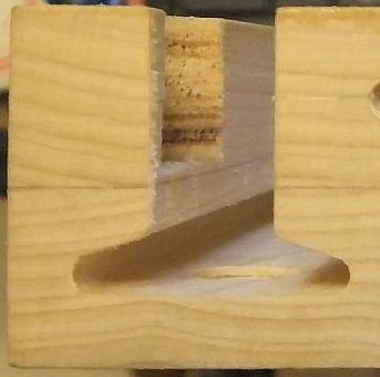

A close up of the anchor nut slot.
ANCHOR NUT SLOT END.jpg (16.65 KiB) Viewed 1246 times

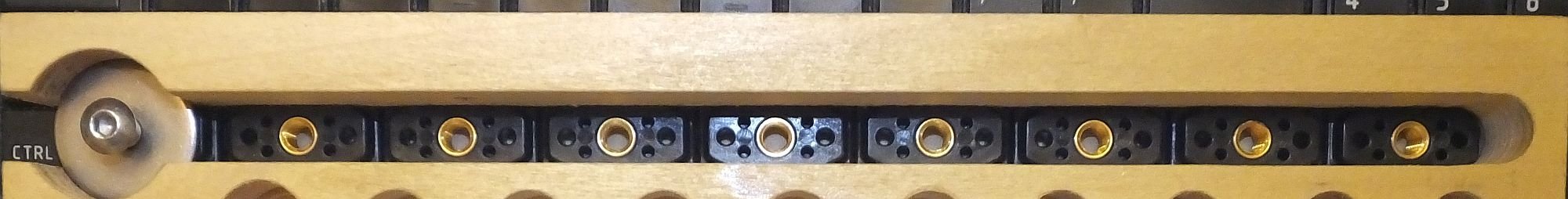

The anchor slots were created by first routing a 1/2" groove(because of the anchor nut router bit not capable of that deep of a slot) using my goldie at 5k+ rpm - slow feed gets it done.

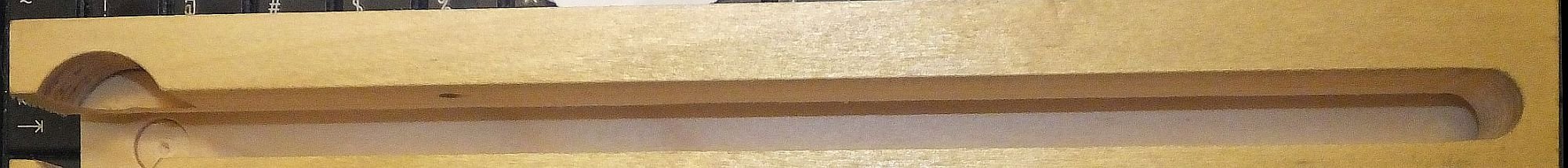

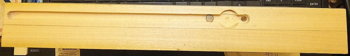

And the top view of the back anchor not slot
ANCHOR NUT SLOT TOP.jpg (103.97 KiB) Viewed 1246 times
The slot is over 11" long and will store up to nine anchor nuts. The left(open) end has a 1 1/8" bore that allows both storing up to 4 of the heavy washers that come with the anchor kit (KT0199-1.250) and serves to retain the entire contents by inserting a screw through the stack of washers and threading it into the anchor nut at that end of the slot. The other anchor nuts are free to slide along the slot.
The back has a 1/4" slot that provides storage for a SS tool kit. The short arm goes into a hole and a small magnet serves to keep the wrench in the groove, Finger holes are there to allow removing the wrench from the slot. (see earlier pix of back)

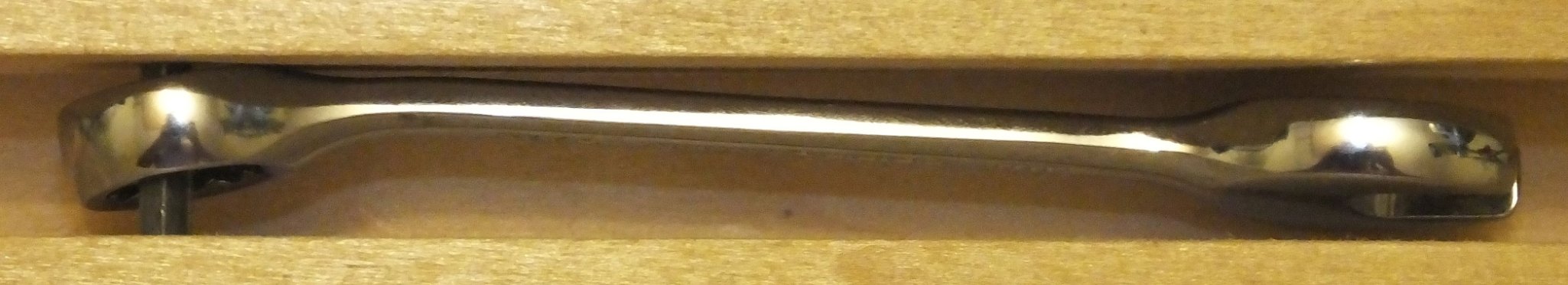

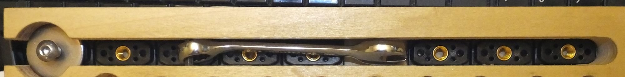

Now we need to store the 7/16" combination wrench. So by removing one of the anchor nuts, a gap is created which allows the open end of the wrench to position below the top and the box end of the wrench is retained by the short arm of the SS tool kit.
COMBINATION WRENCH CAPTURED.jpg (117.47 KiB) Viewed 1246 times
8 loaded with wrench.jpg (76.14 KiB) Viewed 1246 times

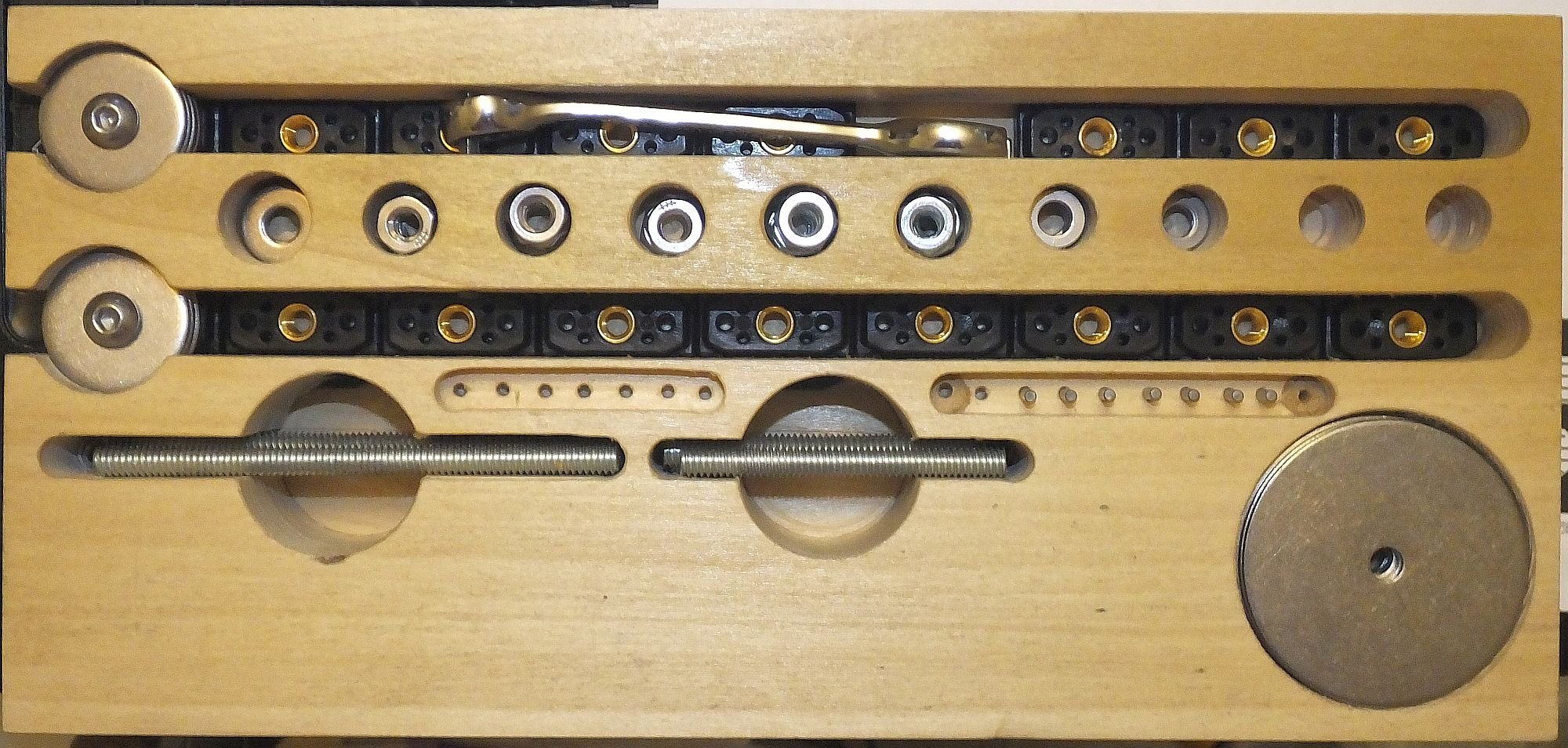

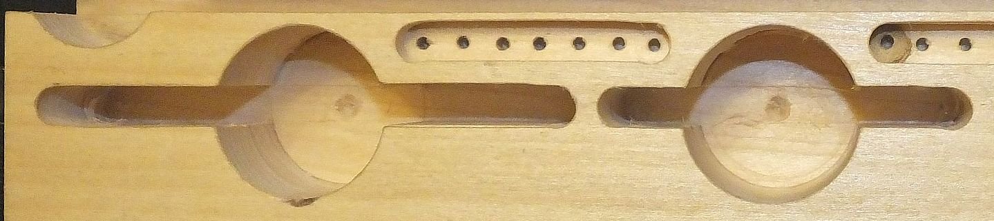

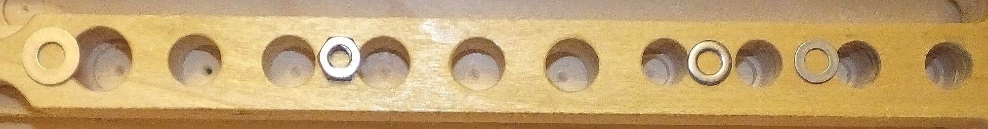

The second slot can hold 9 anchor nuts and 4 heavy washers.

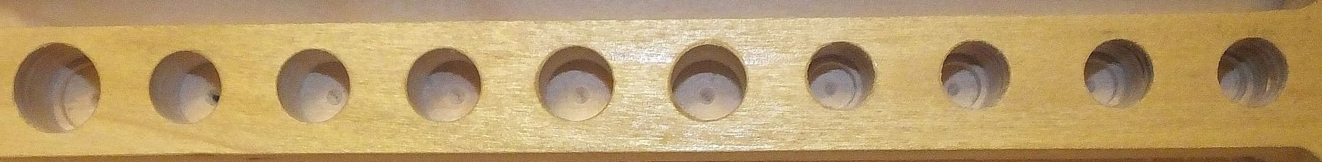

Between the two slot are 10 holes.
The larger hole at the left provides storage for the large (5/8") anchor kit washer. the four holes at the left provide storage for the anchor kit 1/2" thin and thick washers. The washer holes are counterbored at the bottom to allow the SS tool kit to snag under the washer at the bottom of the hole. The other 5 holes provide storage of the 1/4-20 jam nuts. All the holes are 3/4" deep plus the 1/8" deeper/1/8" smaller counter bore at the bottom. Originally 5 deeper holes were planned at a different location. When I decided to relocate them the shallower depth required more holes. I got carried away!(more holes than needed!)
washer & nut.jpg (107.36 KiB) Viewed 1246 times
The washers and a nut are positioned near their respective holes.

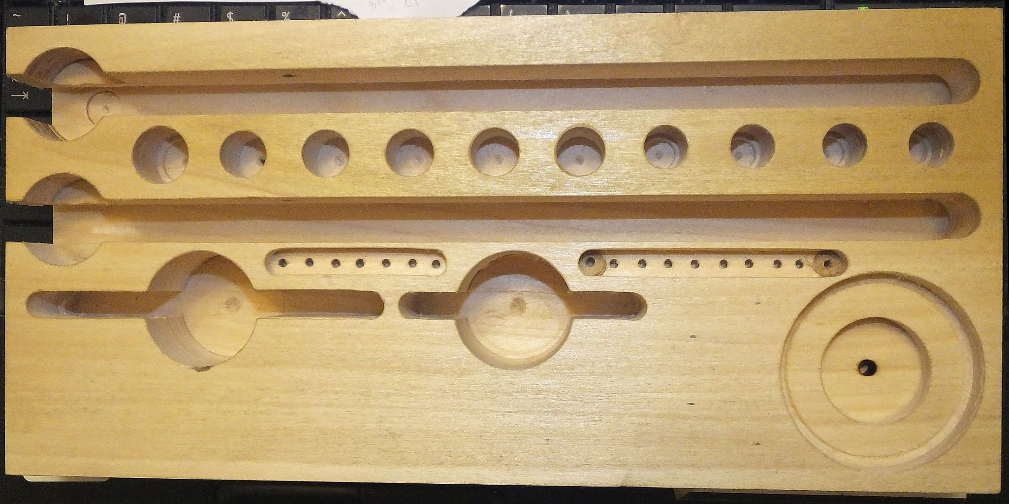

Moving towards the front left are two slots.
STUD SLOTS.jpg (98.44 KiB) Viewed 1246 times
These slots can contain 5 each of the 4" and 2.5" threaded studs. The large holes at the center allow fingers to grasp the studs.

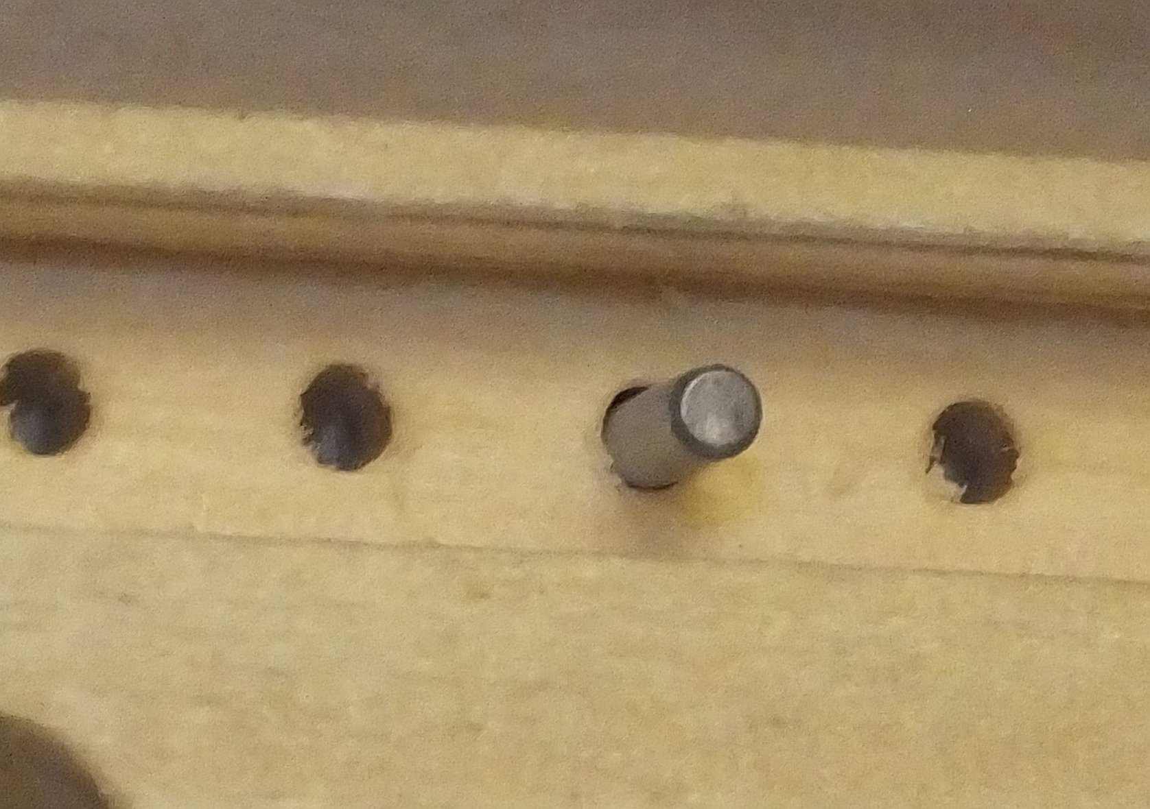

Above and to the left are two rows of small holes in a 1/4" deep groove. These allow storing the small alignment pins that orient the anchor nuts.
PIN HOLES.jpg (44.94 KiB) Viewed 1246 times
Originally I thought a magnetized SS tool kit could pull them from the holes. NOT SO! They be Stainless Steel. I will likely remove the lip above them to allow finger clearance to grasp them.
pin in hole.jpg (286.82 KiB) Viewed 1246 times

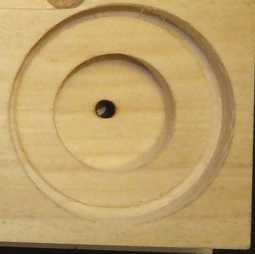

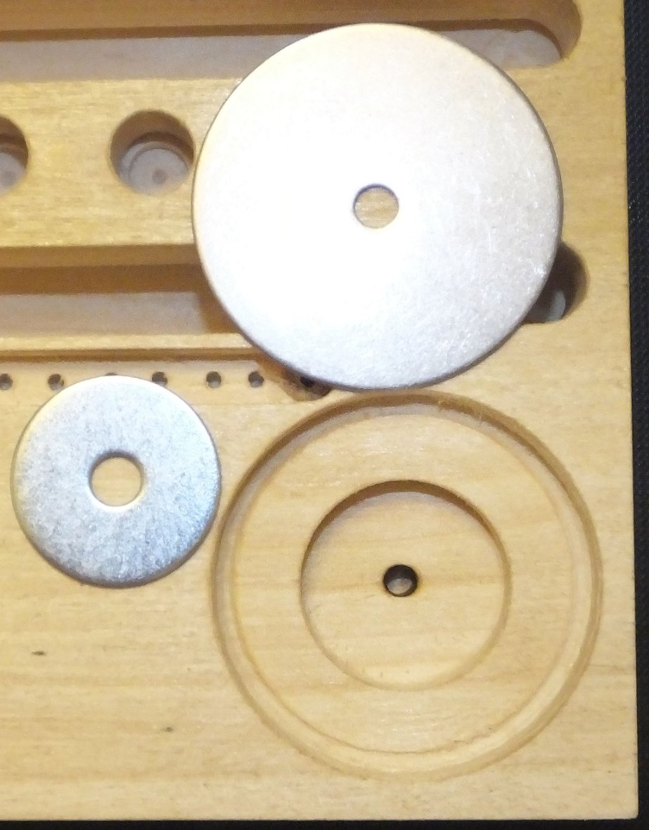

At the far right is a large counter bored hole.
BIG WASHER HOLE.jpg (162.58 KiB) Viewed 1246 times
This stores up to 6 of the Home Depot fender washers and 4 of the 2 3/16" clamp base washers. I need to add a counter bore at the bottom so the SS tool kit can snag the last washer at the bottom of the hole.
big washers.jpg (141.35 KiB) Viewed 1246 times

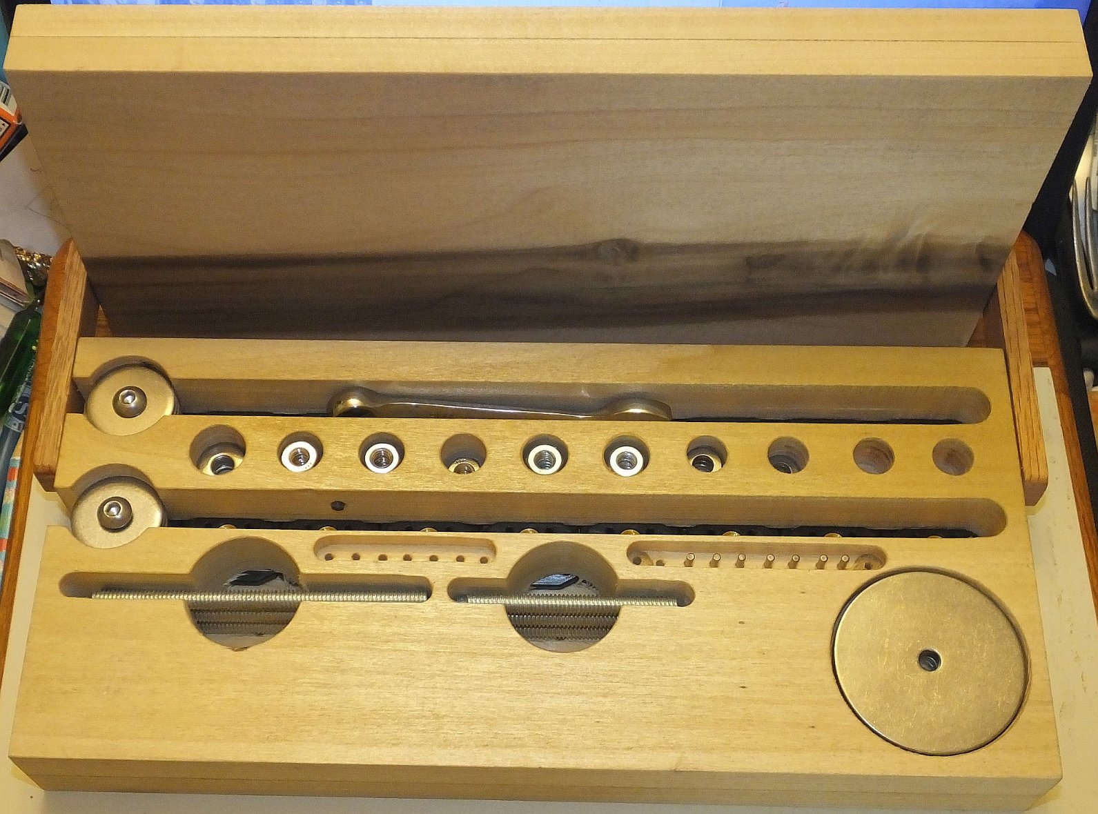

Now everything in it's place.
How can all this stay 'in the holes'?
Covering it will help, but how to attach the cover.

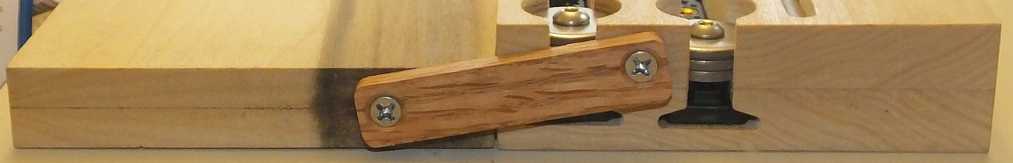

cover hinge end.jpg (356.73 KiB) Viewed 1246 times

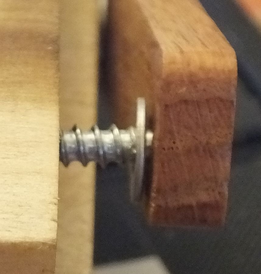

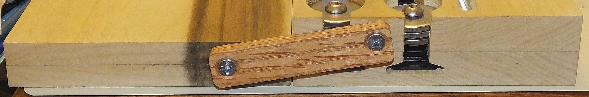

Attach it with a hinge at both ends. The hinges are two narrow strips with a counter sink hole at each end.
hinge screw washer.jpg (105.74 KiB) Viewed 1246 times
In each hole a flat head screw and a flat washer attach to both the cover and the 'base'. In order to function effectively the hinge holes are not simply a counter sunk hole. The hole under the counter sink is sized to tightly clear the od of the unthreaded shank of the flat head screw. Today's flat head screws have a larger od of the threads than the plain shank under the head of the screws. This means the screws must be screwed through the hinge hole until the unthreaded shank can act as a pivot. Both the countersnk And the washer side of the hinge are coated with JPW as well as the unthreaded shank.

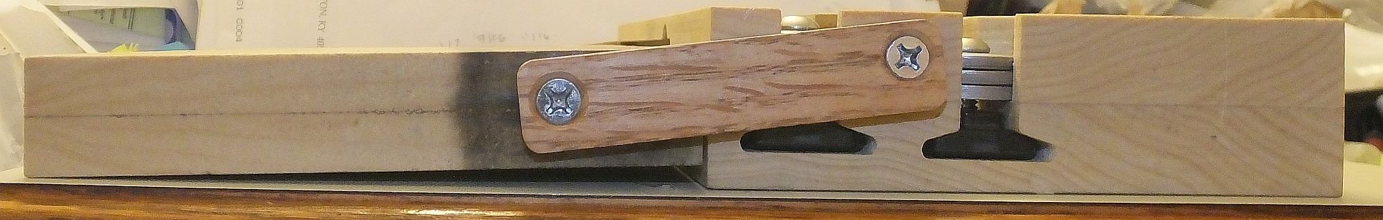

So with the cover opened.
cover open.jpg (373.6 KiB) Viewed 1246 times

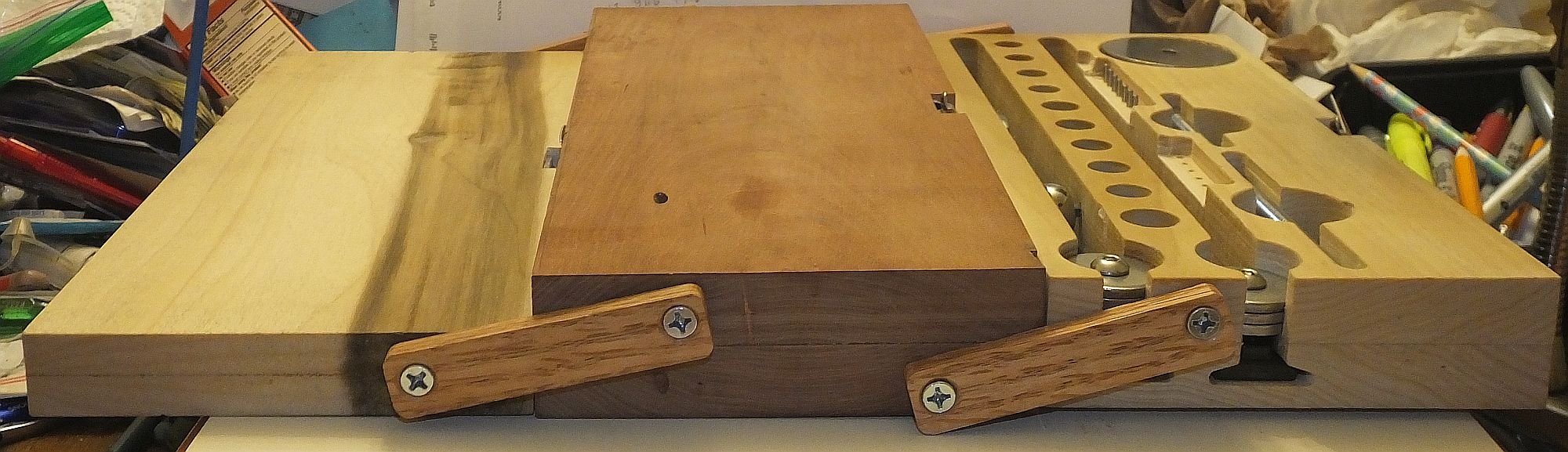

And fully open and laying flat.
cover flat.jpg (142.12 KiB) Viewed 1246 times

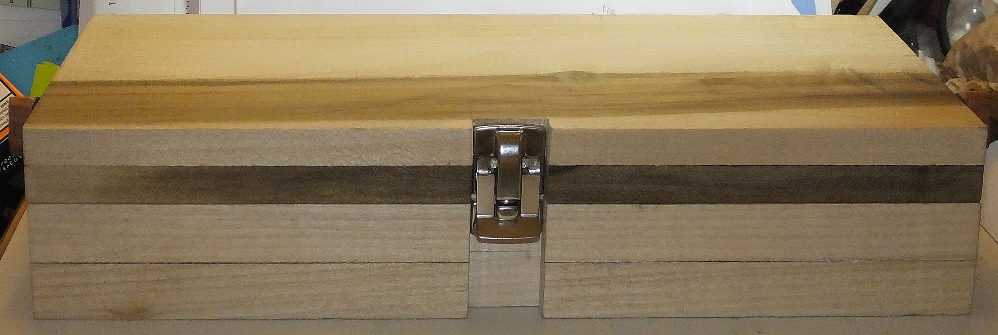

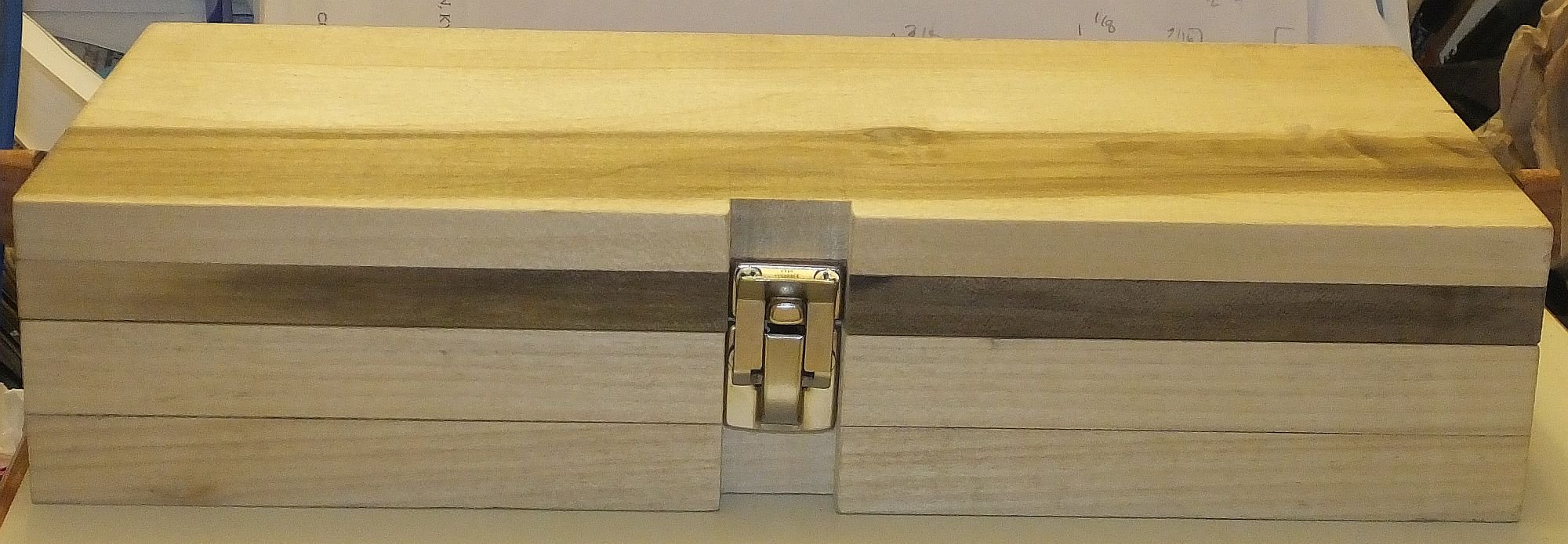

Latches arrived.
front latched.jpg (272.42 KiB) Viewed 1129 times

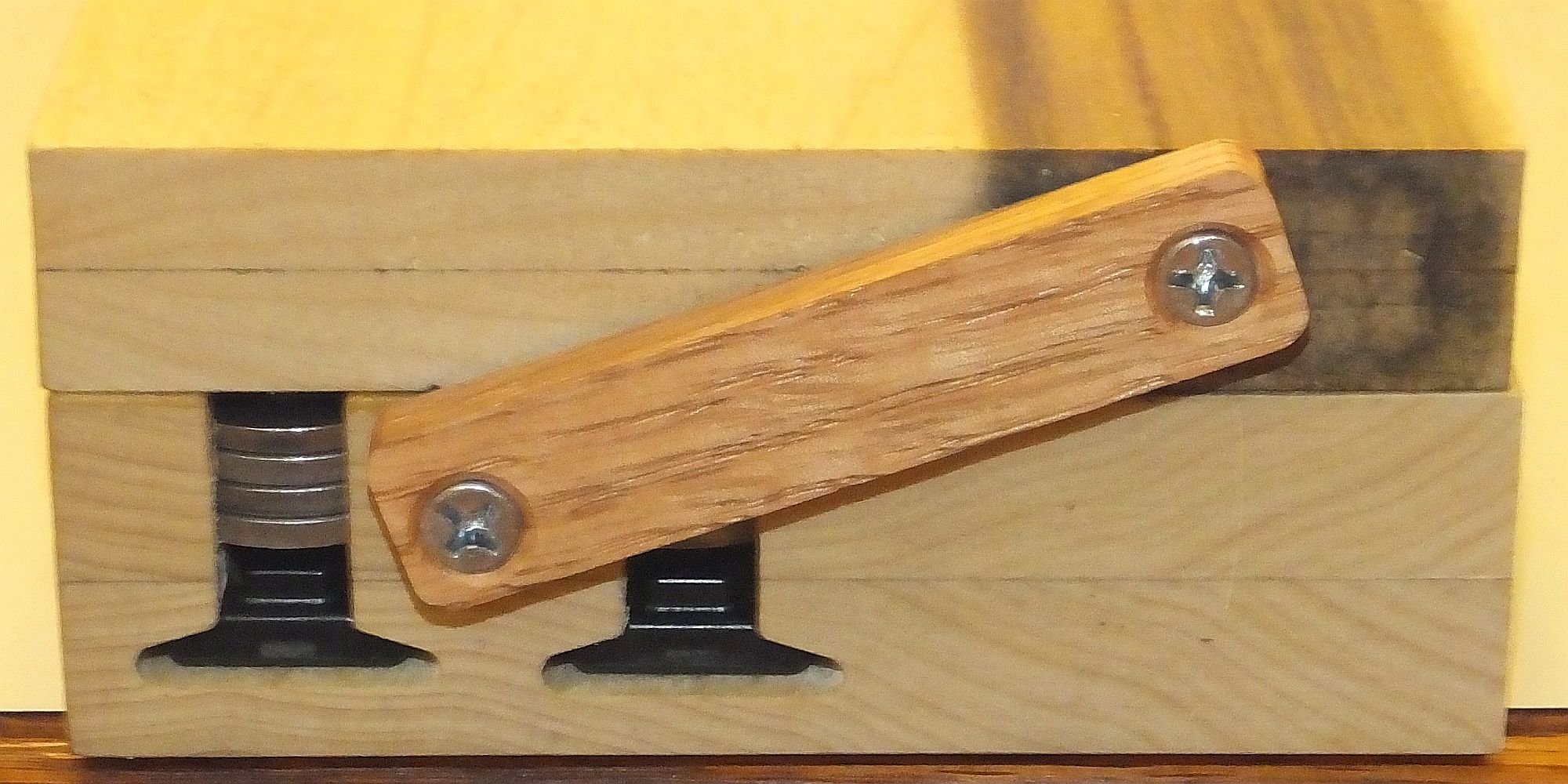

I originally planned to attach a latch at the front sides of both ends. BUT the hinges require that real estate to function.(it is the simple, obvious stuff that in the end bites thee!) So mount in the front. BUT then they prevent a full opened cover. So bury them in a groove.
But then the cover will not lay flat in the full open position.
latched open side.jpg (145.49 KiB) Viewed 1129 times
The protrusion of the upper latch is in the way.
So What! The least of the evils.

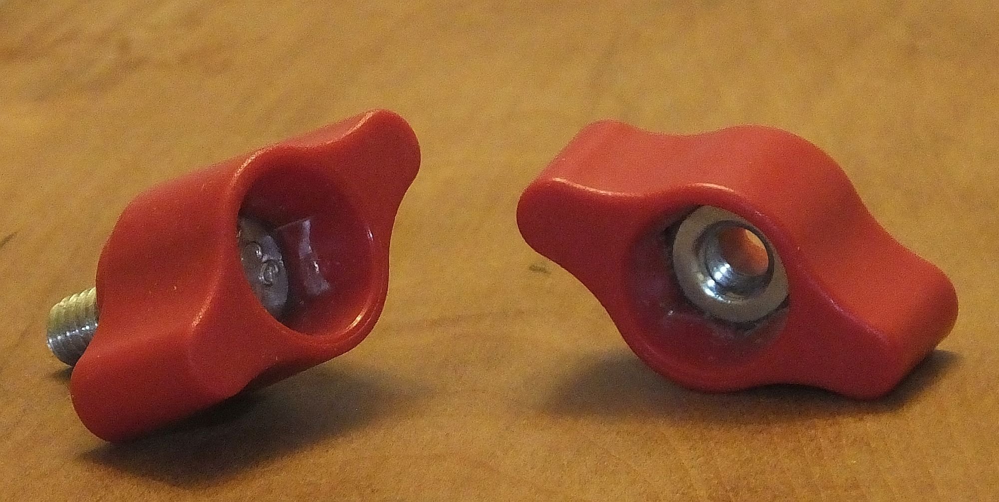

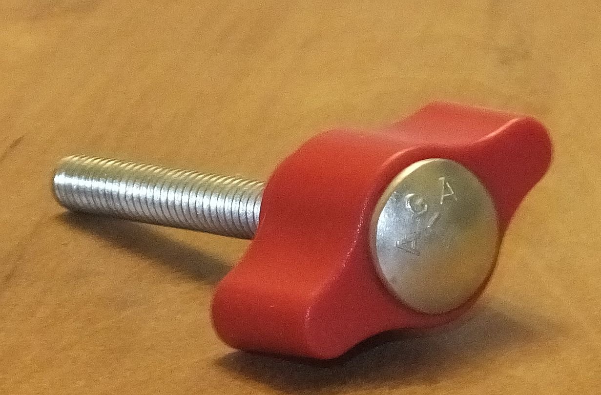

Now about my favorite "knob".
fav knob.jpg (391.79 KiB) Viewed 1125 times
From Woodpeckers. Accepts either a 1/4 nut or a 1/4 hex head bolt. Removable and reusable.
knob bolt variation.jpg (189.07 KiB) Viewed 1125 times
An unusual variation. There IS a nut inside also.
