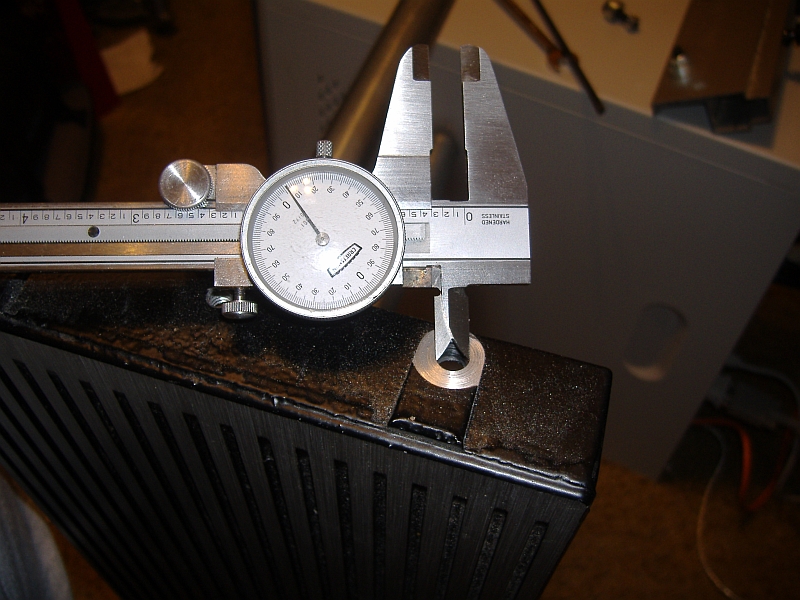

OK so here is a picture that might help.
[ATTACH]2588[/ATTACH]
The dial relaxed a bit so say the hole is more like .310 - .312.

You could fix this by enlarging the hole in the table but......
I would NOT do that until after talking to Customer Service. I suspect that they will make this right without you doing anything other than communicating your situation.
An enlargement that would correct for 1/8" (.125") is significant.
