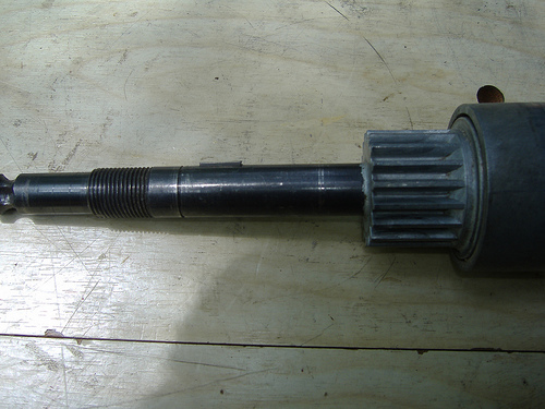

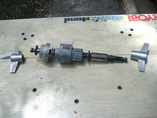

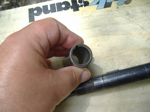

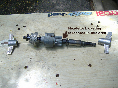

[ATTACH]2642[/ATTACH]
[ATTACH]2643[/ATTACH]
[ATTACH]2644[/ATTACH]
[ATTACH]2645[/ATTACH]
quill lock reference info
- qlr 1.jpg (125.45 KiB) Viewed 7581 times
- qlr 2.jpg (98.91 KiB) Viewed 7585 times
- qlr 3.jpg (99.8 KiB) Viewed 7578 times
- qlr 4.jpg (129.75 KiB) Viewed 7583 times
quill pix
Very Good! 1 Picture is worth 1 thousand words(or 100 line drawings). Several are that much better. Hope they stay till I can "copy" . THANKS!!!!!:)
