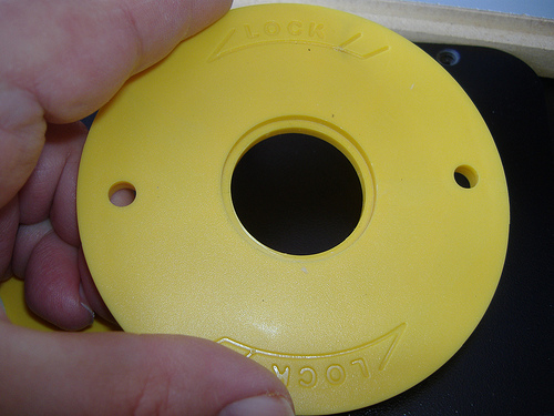

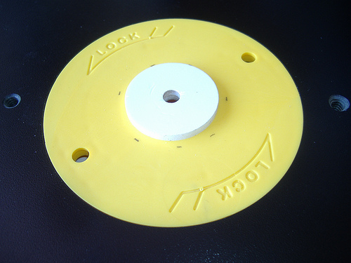

Ring with template guide bushing hole
[ATTACH]2720[/ATTACH]
Kit of parts needed
[ATTACH]2721[/ATTACH]

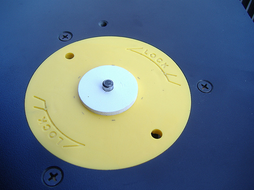

Centering washer in place
[ATTACH]2722[/ATTACH]
Screws in place to mark mounting plate
[ATTACH]2723[/ATTACH]

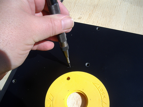

Note the sharp point
[ATTACH]2724[/ATTACH]

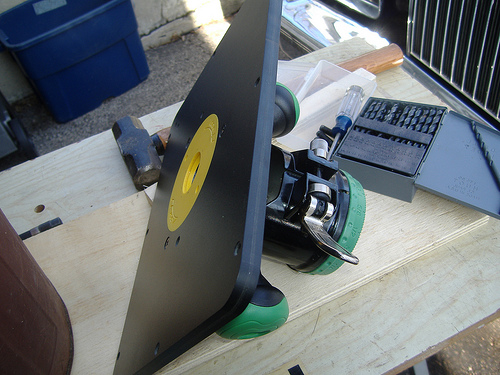

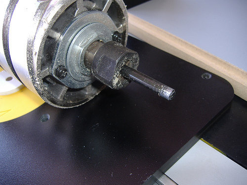

Arbor/shaft chucked up
[ATTACH]2725[/ATTACH]

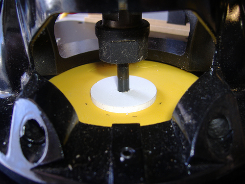

View inside router showing centering washer and arbor/shaft
[ATTACH]2726[/ATTACH]
Adjust so arbor/shaft goes though centering washer
[ATTACH]2727[/ATTACH]

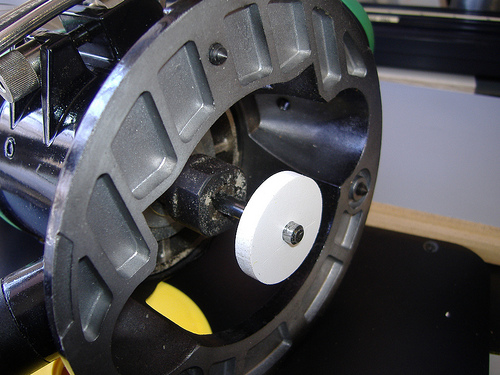

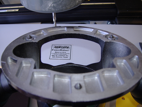

Note the position of the handles of the router, not all that good a fit this way
[ATTACH]2728[/ATTACH]
This fit is better and the latch will be easy to get at
[ATTACH]2729[/ATTACH]

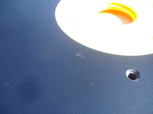

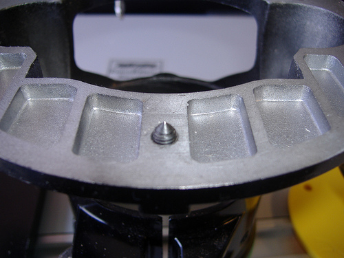

A little hard to see but the small arc and the centering hole are in about the center of the picture
[ATTACH]2730[/ATTACH]
Making the marks easier to find and use with an auto-punch
[ATTACH]2731[/ATTACH]

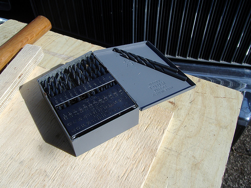

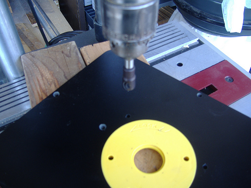

Drill bit selection, a #9 was used in my case
[ATTACH]2732[/ATTACH]

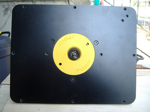

All three hole drilled
[ATTACH]2733[/ATTACH]

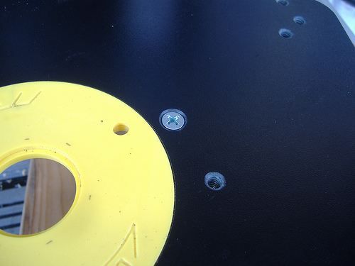

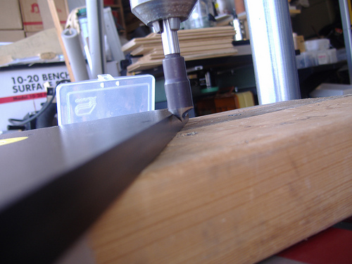

Time to countersink
[ATTACH]2734[/ATTACH]
We are getting close to the final picture and proof of concept

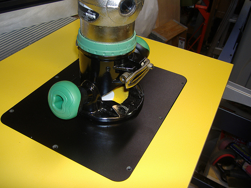

First guess at depth setting. Had to move stop to go about a 1/64" deeper...
[ATTACH]2735[/ATTACH]
See how head of screw is below the surface. The other hole is for a safety guide pin
[ATTACH]2736[/ATTACH]

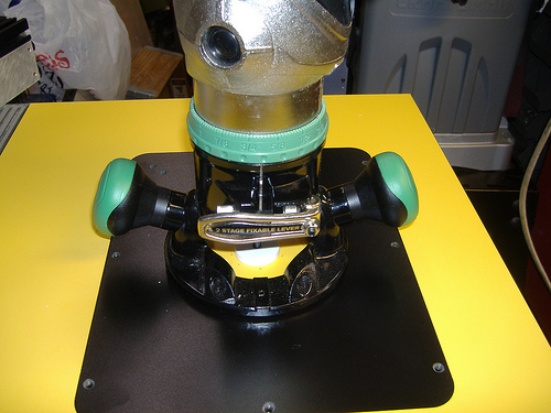

Mounting the router. I had to go to a a 3/4" long screw for mounting. Make sure yours are long enough too
[ATTACH]2737[/ATTACH]
Time for the proof, is it right on or not???
[ATTACH]2738[/ATTACH]
Perfect!
[ATTACH]2739[/ATTACH]
Perfect!
OK then it's time for a lunch break...
