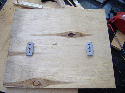

For the base unit I used a scrap of 3/4” plywood and started by finding a center line to work off of. It was not critical so I simply used a pencil after pushed the plywood against the way tubes and centering the plywood by eye. Two holes are needed that are align with the miter slots. The holes need to be flat bottomed and deep enough so the heads of the 1/4"-20 fasteners are not above the surface. The end result will be by using two sliding t-nuts you have an adjustable pin platform that can be locked in place.
[ATTACH]2795[/ATTACH]
[ATTACH]2796[/ATTACH]
At this point I needed to decide what I was going to use as a pin. I decided on the pins from the old OPR that I have. This might be something you do not have and may not want to use even if you do have it. You may also buy them from shopsmith if you want to it is the same pins they sell for the current OPR. (To be safe it would be nice to have a pin that can be drilled into and replaced as needed if you happen to drill to deep...) Well throwing caution to the wind I went with the inserts from the pin router. I know, I'm a wild a crazy guy.
What ever you pick for a pin you want to make sure that it allows you to re-center after the jig is taken off and then put back. In my case I did a couple of things I will detail. First the pins are taller then I like, I wish they were just short of a 1/4” high... in fact I decided to make them that high by counter boring a hole so that the pin was only above the platform surface by that almost 1/4”. This also means that I can use that counter bore hole and the bit that drilled it to help re-center the platform. How this works is the drill bit is mounted in the drill chuck then the platform is moved into position and located by feeding the bit into the hole (drill is not running). You can then lock the quill in the down position and that will hold the platform in place while you lock it with the sliding t-nuts.
[ATTACH]2797[/ATTACH]
[ATTACH]2798[/ATTACH]

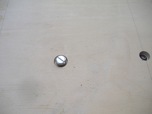

In my case using the pin router pins I added a threaded insert so I can use any of the 1/4”, 3/8” or 1/2” pins. If you happen to have the router chuck for your shopsmith this also works for the alignment. For this you screw in the insert and mount the router chuck then using the quill feed you capture the pin with the chuck.
The counter bore also works or doesn't depending on how you view it as a place for the chips to collect when you are drilling but it will need to be cleaned out from time to time... you need to make sure the jig will sit flat and in contact with the platform and wood chips can be an issue.

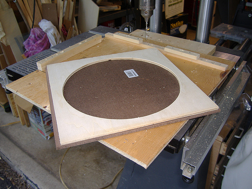

In my case I located places where I wanted to drill the holes for the rivets on one of the pieces. I took some care in the layout and marked the hole locations. Since the “drawer” is made up of a part (hardboard) that slides in the case and the top plywood part needs to be smaller to fit in and again I needed to keep things reasonable close. It also made since to drill both parts at the same time and to have the alignment of the top piece in relation to the lower done by the jig. When we get to the photos this will be clearly shown so I will not waste to many words on this part of the description.

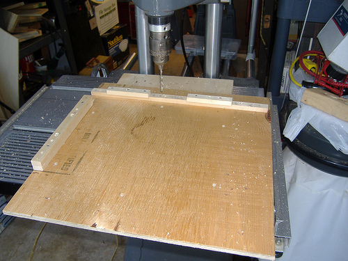

This is an over view of what the jig looks like.
Fixture set to drill body hole followed by counter bore of plywood

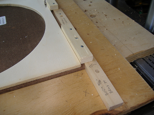

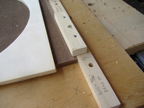

The fixture again was a piece of scrap plywood. I used some trimmed off pine as stops because again that is what I had on hand. I started by attaching a length of the pine to an edge of the plywood with some small nails. From this I used a framing square to locate a side and put a strip of pine down. You need to leave some open area if you can so the wood chips and dust don't collect in an inside corner and mess up that as a location point. This would be the contact areas for the bottom hardboard piece. I used a couple more pieces of pine on top of the other pine along the side. The location of these pieces set the location of the “top” plywood piece. I added a second piece of pine to the very original pine strips so both the hardboard and the pine were located at the same points along an even edge.
Notice how hardboard is located then the off set required for the plywood is done by the second pine board

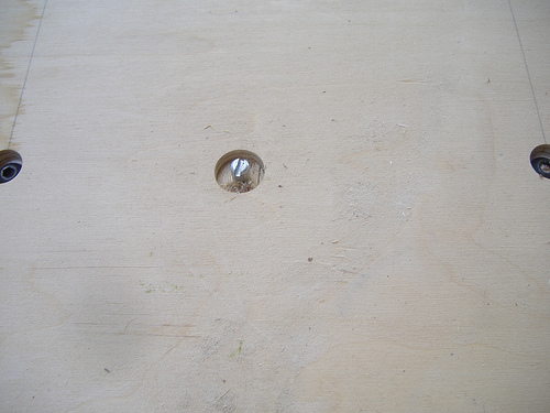

With the fixture now complete to the point of being able to control the location of the two parts it was time to do some drilling. For this a small bit such as a 1/16” twist drill works well. Remove the pin from the platform and made sure the bit will not go to deep as to hit any part of the platform. Actually adjust the bit so it will drill through the drawer parts and into the fixture, you need not drill through the fixture. Drill the holes at the locations marked. If you have not done so before it is a good idea to somehow mark the drawer parts so you don't flip anything around after the drilling and if they get separated you can get them back together and aligned. What you have done at this point is to mark the hole locations on the fixture.
I have the option of using one of several pin sizes but for this project I went with a 1/4” pin so I used a 1/4” drill to enlarge the 1/16” starter holes put in above. A brad point bit does really well with this and gives a nice clean hole. After drilling the holes you can clean the edges of the holes on the bottom side where the pin will be going. What is really neat about what you just did is that you have now located the drill positions for each hole you are going to make. Even if you were a bit off in location due to not being centered 1/16” hole that will be taken care of in the following steps. Since you are drilling each hole through both parts at the same time they have to line up.... OK if you mess up putting the parts in the fixture then you can make a mess of things but don't do that!!
This is what the bottom of the fixture looks like with 6 1/4” holes for the pin to set in for drilling locations. Pin is located on platform below the jig

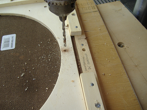

The fixture is ready to use so install the pin in the platform and get the drill you want to use. In my case I think it was a 5/32” hole for the body of the rivet. Make sure you are set deep enough to drill through the two parts but not so deep as to hit the pin. Take the drawer that you used to mark the jig with and reposition it on the jig. Remember what I said about maybe messing up the hole locations a bit not being a big deal?? Well, this is why, you are now going to re-drill the holes! Bingo the holes are now in alignment to the fixture as will all the rest you drill.
Body hole 5/32" Note that pin in platform is locating the fixture for this drilling operation

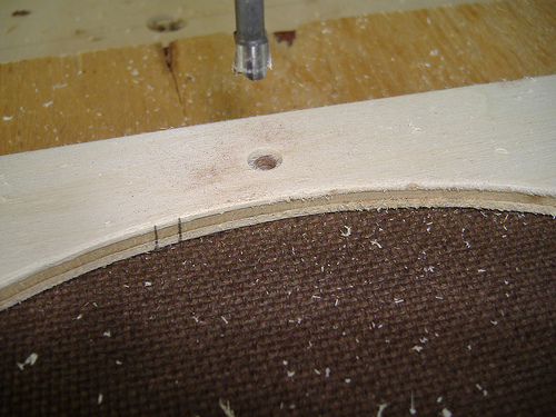

Almost done now... In my case I did the drilling of body holes for a bunch of drawers then went on to change bits to a 1/4” Forester and set depth to have the rivet head below the surface. Again the bit was centered on the hole from before because of the pin location and fixture location. After doing all the plywood pieces it was time to do the hardboard. This becomes a problem because you can not simply flip the pieces over... what you have to do is locate them upside down so to speak. In my case I simply relocated the pine pieces to the same locations on the bottom of the jig, which then became the top of the jig and everything was once again in alignment after flipping the hardboard over. This might require you do a little extra thinking but that is what needs to happen to get it right...[hint notice dowel holes]
Body hole for rivet is now be redrilled to counter sink rivet head.
Again the pin in the platform along with the fixture are locating the hole.

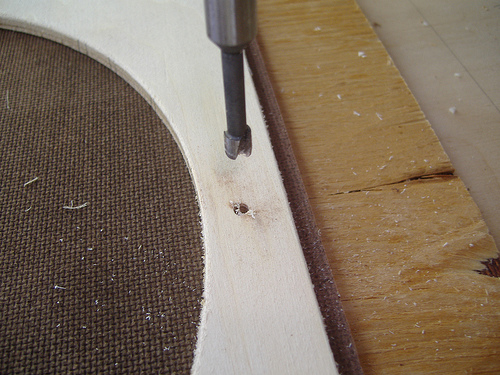

After counter bore for rivet head is done
[ATTACH]2806[/ATTACH]
