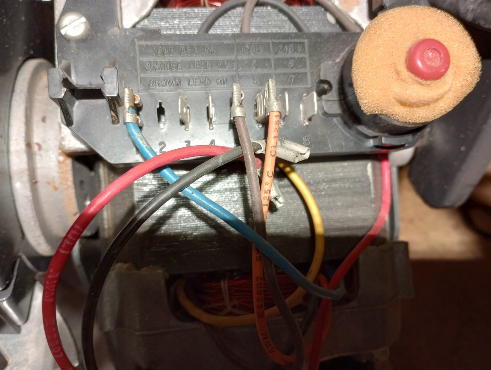

Can someone tell me the internal wire connections for the Craftsman Radial Arm saw?
Somehow they got disconnected. the red and black are not connected.
Model number 113.197751
Wiring connections - Craftsman Radial Arm saw

- wires2.png (2.25 MiB) Viewed 1932 times
- Radial Arm Saw wires_1.jpg (238.39 KiB) Viewed 1932 times

Picture of similar model that may help: http://vintagemachinery.org/photoindex/ ... x?id=12283
I can't see a capacitor on yours, or the black and white pair that I assume are the main AC lines coming from the switch. I'm no expert, but I think you may need a capacitor.

Re: Wiring connections - Craftsman Radial Arm saw
I think that nailed it!edma194 wrote: Fri Feb 04, 2022 1:16 am Picture of similar model that may help: http://vintagemachinery.org/photoindex/ ... x?id=12283
