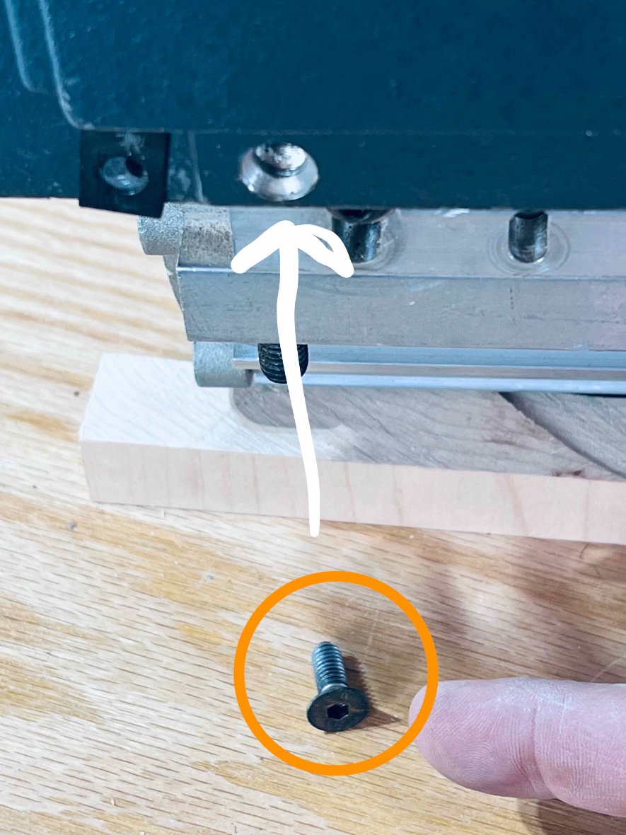

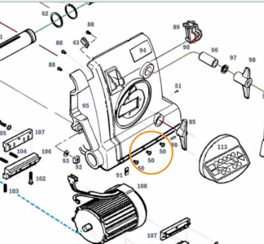

Hello,
When reinstalling the PowerPro motor I noticed there are 6 locations for bolts, but I only have 4 bolts. I would like to order the remaining two bolts from Shopsmith, but do not know how to find them. They are part number 50 in the schematic included and I have a picture of one at the tip of my finger. Suggestions on their proper name so I can order? Thanks
520 upgraded to PP. Bought used. Primarily use as Saw and Lathe

Aaron wrote: Thu Feb 24, 2022 4:30 pm They are part number 50 in the schematic included and I have a picture of one at the tip of my finger. Suggestions on their proper name so I can order?
Ref. No. 50 is PN 522659 described as "M6-1 X 10 SFHC Screw." This info came from a PP Upgrade manual, 556202 Rev. B, really the continuation of the drawing you attached.
Note that with the full description you can get these elsewhere if you so choose.

DLB wrote: Thu Feb 24, 2022 4:49 pm Ref. No. 50 is PN 522659 described as "M6-1 X 10 SFHC Screw." This info came from a PP Upgrade manual, 556202 Rev. B, really the continuation of the drawing you attached.
After thinking that answer over for a minute it occurred to me that there is NO WAY that those screws are only 10 mm long. So while the manual says they are "M6-1 X 10 SFHC Screw" I believe they are in fact M6-1 X 16. They are metric grade 10.9.
- David

They are back in the machine, so I cannot measure, but I agree 10mm is awfully short. I will order and give it a try. Thanks for the help.
- Aaron
