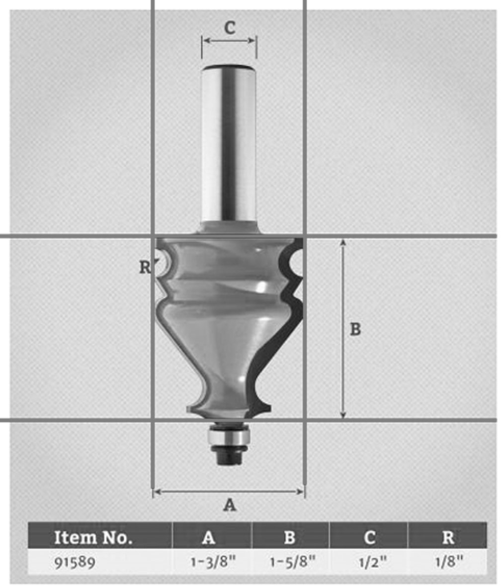

Before I attempt something I have never tried before, I would like to hear if what I plan to make is feasible and can be done safely.
The bit I have purchased is this:
Rockler 2141.jpg (120.93 KiB) Viewed 23685 times
The material to be used is cedar, or possibly white pine (1"x 2").
With Shopsmith in drill press mode, bit mounted in router chuck, rip fence between bit and way tubes, stock should be fed from back to front? Move fence closer to bit after each pass (cutting no more than 1/8" each pass) until profile complete and guide bearing is rubbing against stock?

I would start out by using wider stock, routing the profile on one edge, then cutting off the narrow piece of molding. This is the kind of thing that is easy to do with a handheld router if you have one and then you can leave the Shopsmith in table saw mode to cut off the finished molding.
I prefer not trapping the board between the fence and the router bit but if you do them I think passing the board left to right should be done. A right to left pass in front of the bit would be preferred, and since you have a guide bearing a fence is not really needed.
Pine and cedar should be easy to cut. Do you have a PowerPro or are using a conventional headstock limited to 5200RPM? It's a fairly wide diameter bit so should cut well at the top but the bottom shape is somewhat delicate, you could watch for tight straight grain at that edge, and of course avoid knots on that edge.

Be careful of feed direction as it depends on direction the router bit is traveling, you want to feed the wood into the oncoming router cutting edge. The router bits are designed to rotate clockwise, if you are routing between the way tubes and the bit, right to left feed and if in front of both the way tubes and bit then left to right feed direction.

I feel like I'm kind of reading between the lines a bit. Are you planning to fully profile a face of the 1 X 2? (1-5/8" profile, 1-1/2" stock) Which won't work the normal way because you are cutting away the reference surface that should ride the fence. And for that reason you are wondering about cutting with the material between fence and cutter as opposed to burying the cutter in the fence.(?) I've never done that, so a general comment: cutters of this type pull the material into the cutter, which is normally buried in the fence so it just helps guide the material along the fence. If you cut the other side of the material it is going to try to pull into the cutter and away from the fence. That seems bad, and I doubt the bearing's effectiveness if that happens.
If my assumptions are right, I think Rhode Island Ed had the best idea, cut the profile on larger stock with the bit buried in the fence and cut down to finished size after it is profiled. There may be some other ideas on utube or something, I've never done anything like this on a face away from the fence. I've always thought of it as one of those things you don't do.

Thanks for all of the insights, suggestions, comments and questions. You have all given me several things to think about. I'll try to answer all questions in the order they were received:
edma194: I do have some wide stock I could try using a hand-held router on, and then rip the finished profile to width, so I will give that a try. My Shopsmith is a Mark V 500, so the faster RPM of hand-held router should also help. My thought to use the Shopsmith, even with it's slower speed, was because I didn't think a bit this large could (or should) be used in a hand-held router.
thunderbirdbat: Yes, feed direction was one of my main concerns. After others' comments about feed direction, if I try using the Shopsmith, it will be with the bit "buried" in an auxiliary fence, and not with the workpiece trapped between the fence and the bit.
DLB: My initial thought was that the stock will be a rough 1 x 2, so greater than 1.5" tall. I may not be able to cut the entire profile of the bit. After drawing a more detailed profile of what I want, I may have to use a larger piece to get the size I need. The idea of cutting the profile on a wider board and then ripping the profiled edge off is seeming more and more like the better way to proceed.

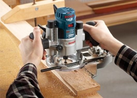

Your bit also struck me as pretty big to use in a handheld router. I didn't know what the "official" advise was on that, though, so I Googled it just now.
This Woodworkers Guild of America article says "Bits larger than 1” in diameter or longer than 1-½” should not be used in a freehand router—switch to a router table for those cutters." Your bit exceeds both dimensions. But those dimensions are undoubtedly just a rule of thumb. If you have an edge guide for your router and adjust it to take to take several light cuts, I expect that you'd be OK.
That edge-guide setup kind of blurs the line between handheld routing and table routing.

Thank you BuckeyeDennis, those are good guidelines to follow. br549, I think you should be ok with a handheld router on pine or cedar taking several passes, if you have an edge guide, but don't do this if you are not comfortable with it. The article linked above is a good guide to follow. If you use your ShopsmithI think the advice to use a shaper fence to rout in front of the bit is a good idea.
