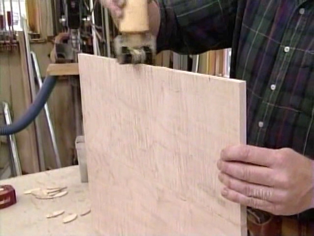

Hi,
I found I have that show on tape and maybe you were distracted for a brief second when they showed the glue being rolled on but it is there. On my tape is at 5:49 into the show...
[ATTACH]3310[/ATTACH]
I like to tape the shows because I'm often nodding off while watching just after lunch and missing stuff. Somehow the sounds of woodworking relax me and I often wake listen to the credits at the end of the show...
