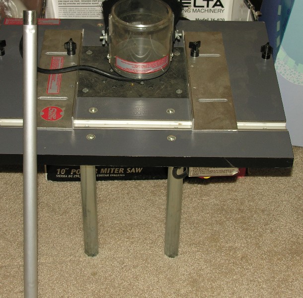

I think the router table on sale is for the old free standing OPR. I have a couple of the old ones and really enjoy them. If you needed to replace the table on one of the old ones this would be a great deal. I also have a couple of the under table router tops that SS offers or offered. They fit on the end of the SS with an extra stabilizing leg and share some of the same hardware as the old OPR. I was getting ready to stick this one in storage and decided to post a pic for what its worth.
ldh
[ATTACH]3583[/ATTACH]
