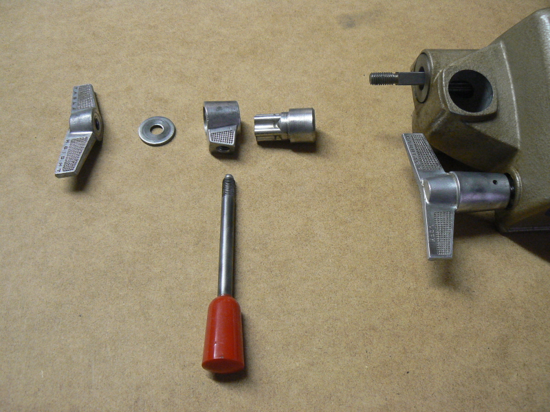

The first pic is the table lift crank with lever disassembled. (BEFORE)
b4 table lever.jpg (363.52 KiB) Viewed 21473 times
The second pic shows the assembly sequence of 'new' lift crank. (AFTER)

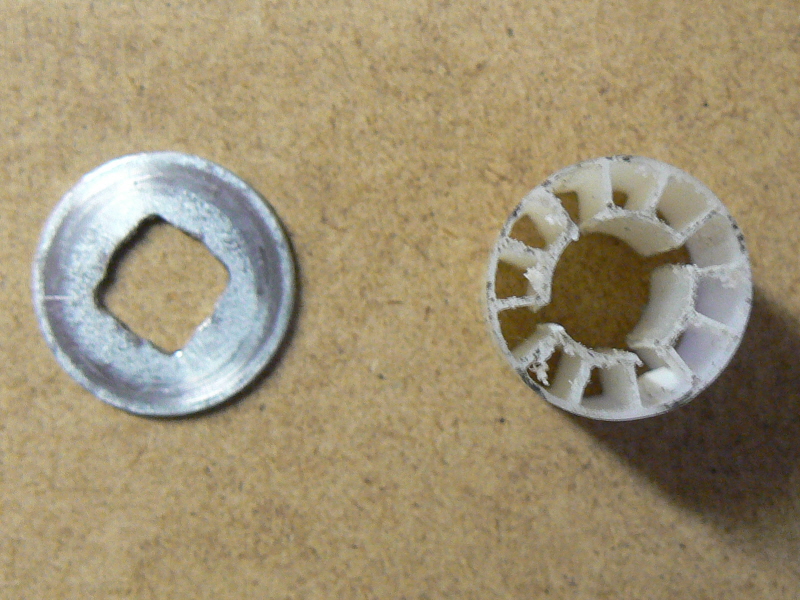

The third pic shows the NEW parts. The crank(514330) is NOT shown.
new parts.jpg (327 KiB) Viewed 21468 times
The washer is a 3/8" flat washer which will not quite fit over the crank shaft. Therefore the 4 notches are added(filed).
The white thingey is a spacer to hold the original 'pinion knob' centered. It is made from a paper roll core and is slightly shorter than the pinion knob. The core had 8 webs between the od(7/8") and the id. The id was 'sliced' at 4 places equally spaced. This allows the 'thingey' to slip over the crank shaft.
The washer goes between the new crank and the original pinion knob. The clamping force when the lock wingnut is tightened is from the crank through the washer to the pinion knob and to the table pinion.

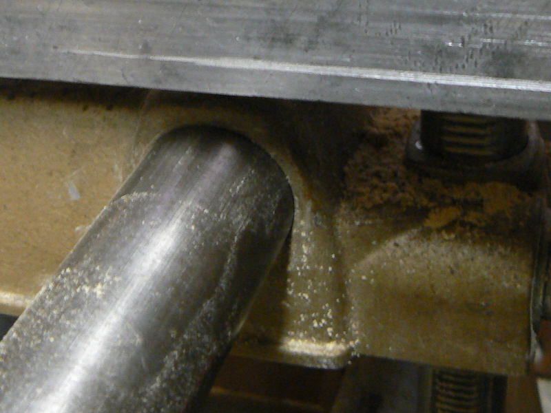

The last pic shows the downside to this alteration.
hit crank limit.jpg (285.74 KiB) Viewed 21472 times
When the table is rotated 90°(think vertical drill press) the table hits against the crank 7/8" short of hitting the way tubes(previous limit).

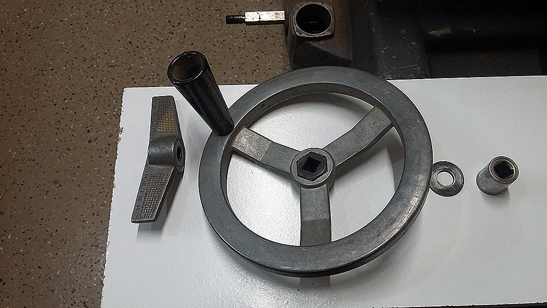

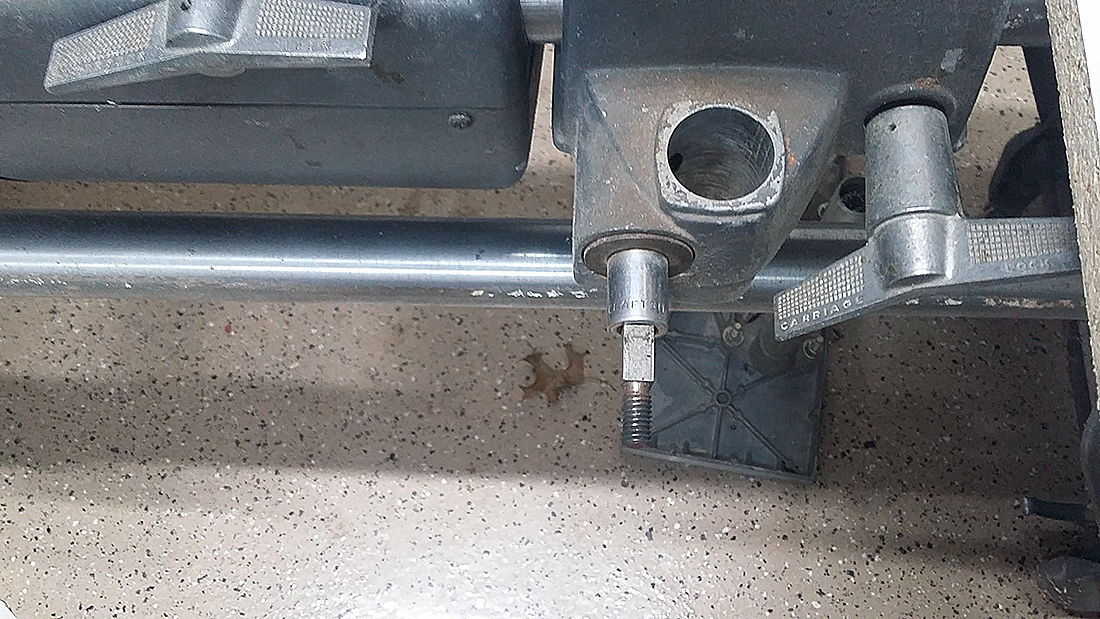

Back in about 1996 I came up with this way to approach this problem, I went to a ShopSmith Store, what were they "Woodworking Unlimited" and and asked them if the new wheel handle to raise and lower the table on my Mark 5, they said "NO." So I went over and looked at one on the showroom floor and when no one was looking I took the Handwheel off and looked it over, figured out what I needed to do to make it work and ordered the "Crank and Insert" and proceeded to make it work when it was delivered, I figured out the only thing I needed to do was inert a 3/8" drive 9/16" socket and put it back together. Below are the pictures that show how it works.
Here are the parts,
Table Height Lock, Crank and Insert and washer along with 9/16" -12 point 3/8" drive socket

Shows the 3/8" drive socket, which the socket drive socket is exactly the right size to fit over the Pinion shaft square end

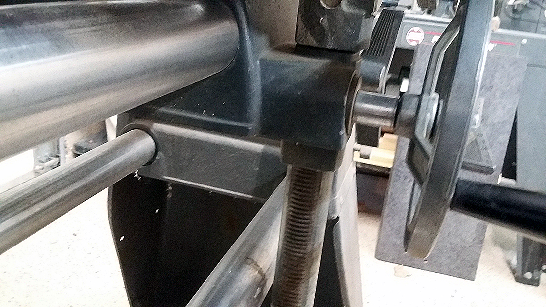

Showing the table fully lowered to the way tubes.
