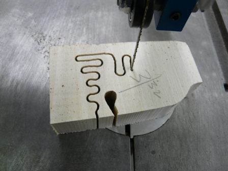

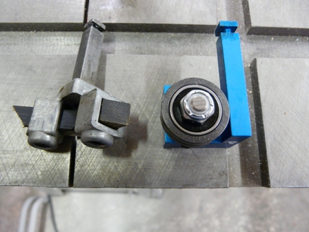

Some of you remember my post a couple of weeks ago asking about the carter guide. Well It came Friday and I installed it this morning. It was a simple procedure just remove the old guide replace it with the new one. A simple alignment and it was ready to go. I will give it 5 stars with the 1/8 inch blade. Carter advertises it for blades up to 1/4 inch. I plan to keep it set up with the 1/8 inch at all times. I replaced the tires last week cleaned and greased the top bearing and with the new guide I am very pleased.

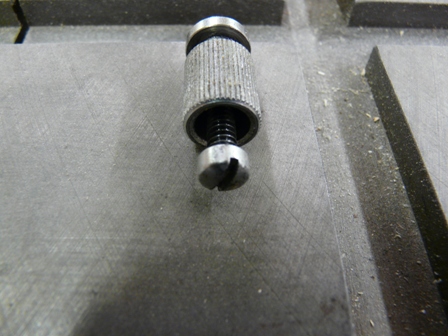

This adjustment nut comes off with a screwdriver.

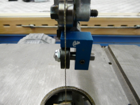

I am real interested in hearing how this works out. I am skeptical to say the least.
It appears to me that the Carter Stabilizer is just another thrust bearing but located where the cool blocks would normally be.
It also appears in your photo that you have not aligned the thrust bearing with the blade. This may be a optical allusion but I find that the blade runs much truer if it tracks right between the two bearings.
How far behind the blade do you usually have the thrust bearings set? It appears in the photo that the blade may never get pushed that far back because the Carter Stabilizer is already engaged.

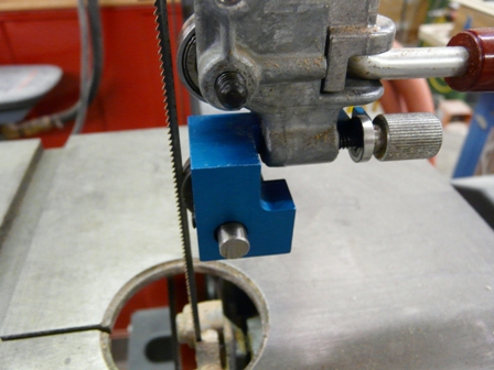

IF I correctly understand the method behind the carter stabilizer, It is meant to be this way. The Carter has its own 'groove' that the back of the blade rides in. The front of the blade is free to deflect from side to side to allow tighter radius cuts. It is NOT intended for larger (resawing) blades.dusty wrote:I am real interested in hearing how this works out. I am skeptical to say the least.

See above. The blade never engages the thrust bearing when using the Carter bearing. The blade rides between the Carter bearings and is actually even pushed forward a tad to create tension on the blade.dusty wrote:I am real interested in hearing how this works out. I am skeptical to say the least.
I have this bearing mounted on my band saw and it works great
Yep! That is correct.
No optical illusion. The original thrust bearing is not used when the Carter bearing is in use

When I first got this band saw and set it up with a new 1/8 " blade and cool blocks I got a lot of blade wandering when I did tight scroll cuts. As stated before I plan to keep this set up at all times. With the Carter guide I do not get the wandering or side to side blade movement as before. In my opinion the cool blocks will work fine for blades of 1/4 inch and larger and I certainly wood not want to have to change the guides out when changing blade sizes. As in all tools some are not for every operation but this set up is going to work great for my smaller cutting projects.
