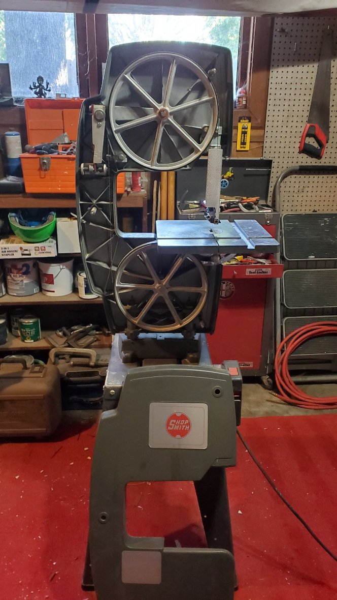

New to me bandsaw. Also, I'm new to the forum.
Questions:

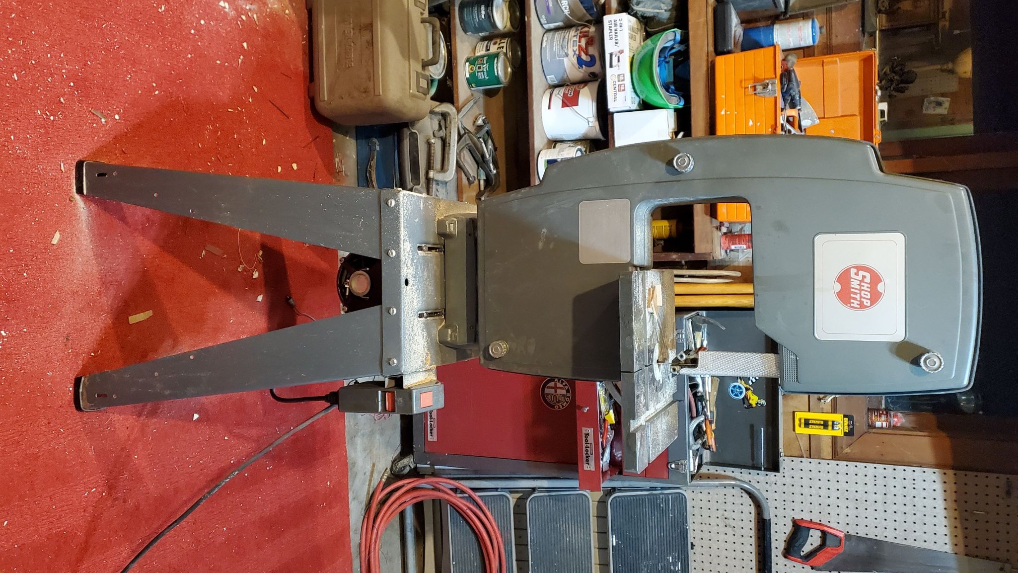

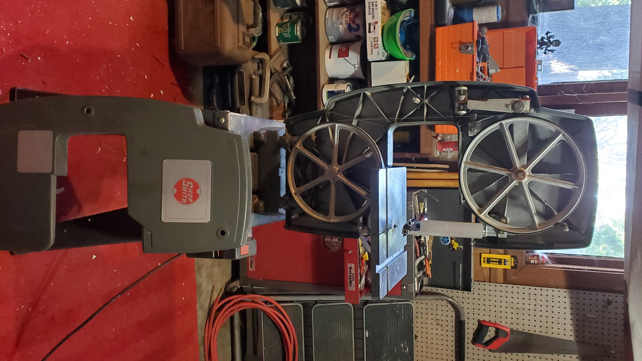

Why are my images sideways?

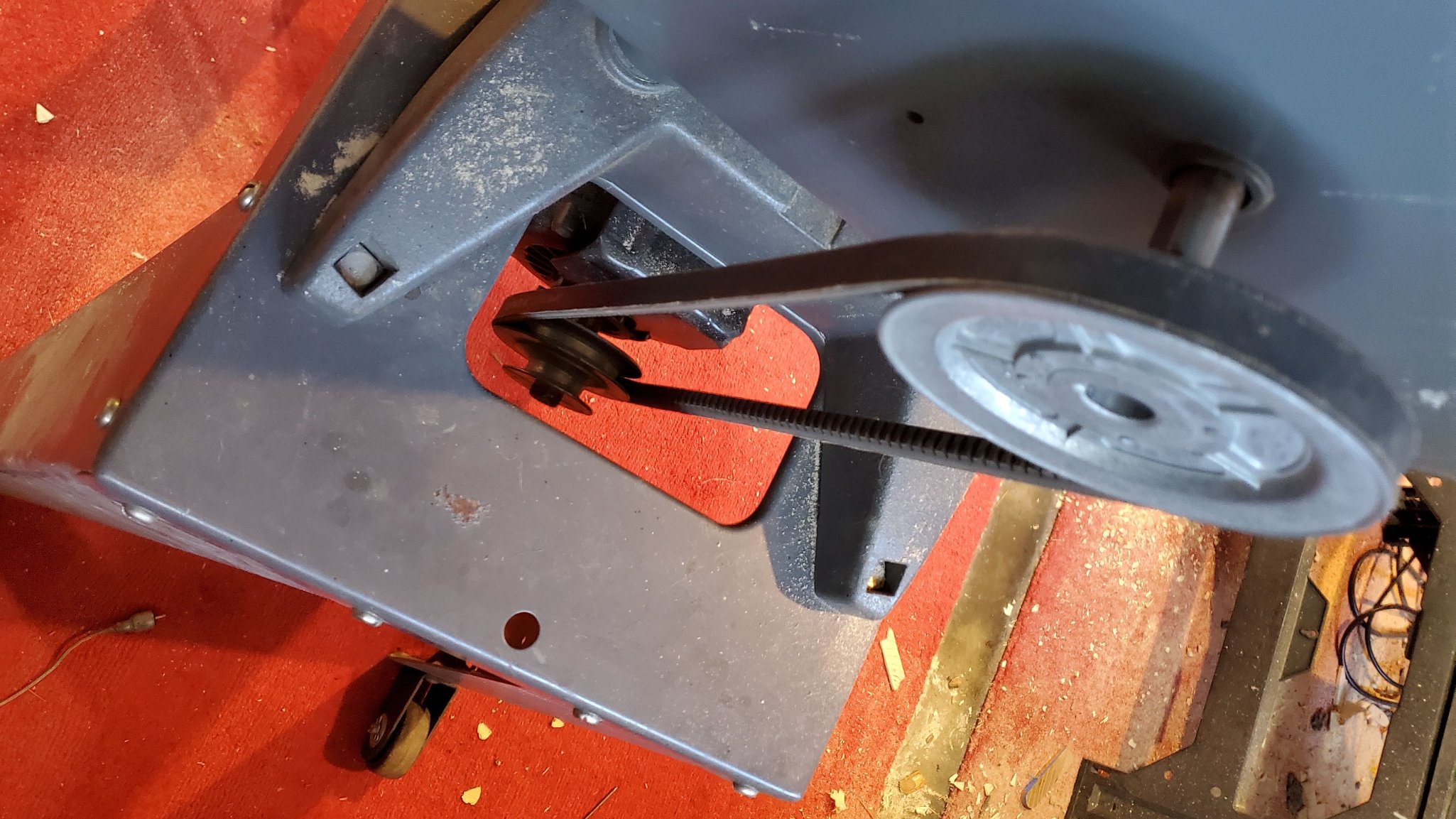

Is the belt on the correct pulley? What's the other pulley for?
What year was this saw made? There's no serial number.
There's no peephole for blade tension viewing. Okay if I cut one? Anyone have a picture of one that's been done well?

The two pulleys give you a choice of speeds. Only recently made bandsaws have a hole for tensioning. You'll need a window also so you can see the tension gauge without taking the side cover off. Here's an example of a DIY window: viewtopic.php?p=182706#p182706
You can also but a new bandsaw cover with the hole, window, and dustport: https://www.shopsmith.com/product-page/ ... -dust-port. A dust port only upgrade is available also: https://www.shopsmith.com/product-page/ ... dust-chute
Your images are shown in the default orientation detected. Why that is depends on how you took them or edited them before uploading.

I took the pics oriented vertically, and resized them the same way. Must be some setting I need to fix.
Steve in Portland OR
Re: Bandsaw Pulley
The forum sw ignores the orientation metadata and assumes/displays horizontal. So to prevent rotation, always take in horizontal.top up orientation.

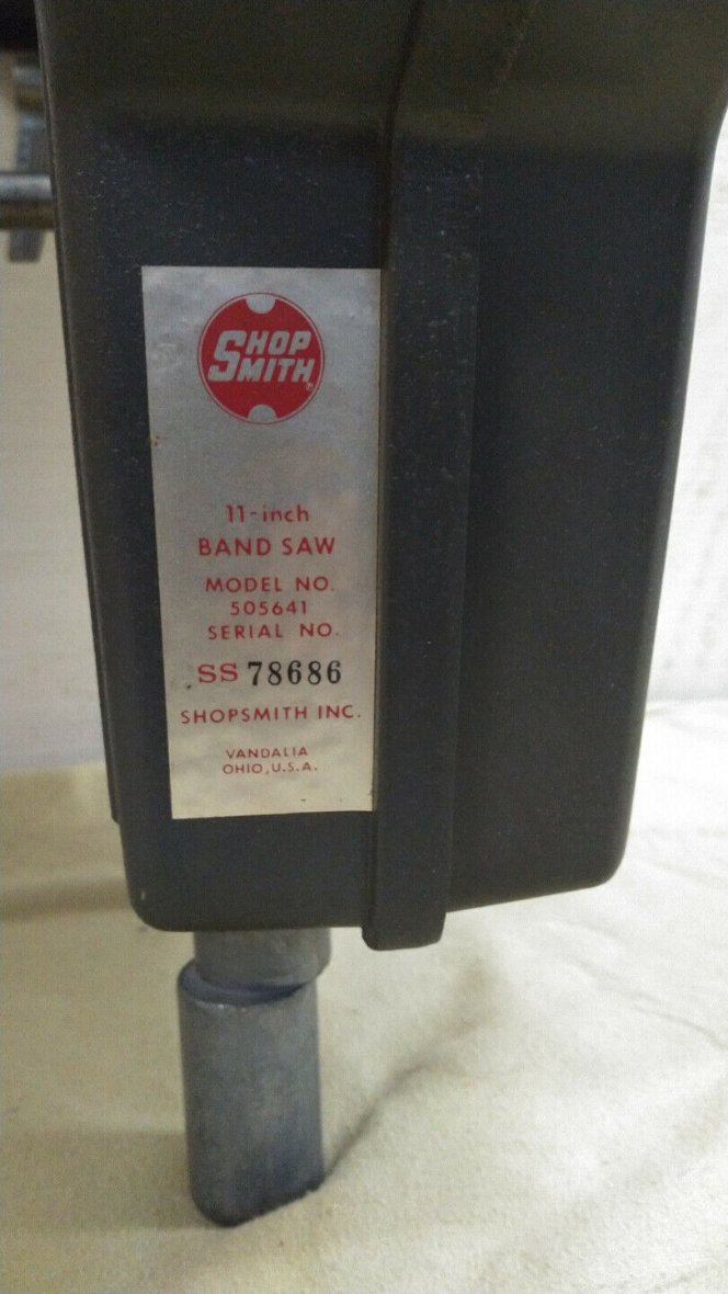

Since 1973 the serial number has been on a sticker like the ones shown below. It is most commonly found in that location on the Main Frame. Later Bandsaws after Date Coding replaced serial numbers the sticker location varied.
_
SS78686 Apr 83 SS.jpg (98.88 KiB) Viewed 2130 times
_

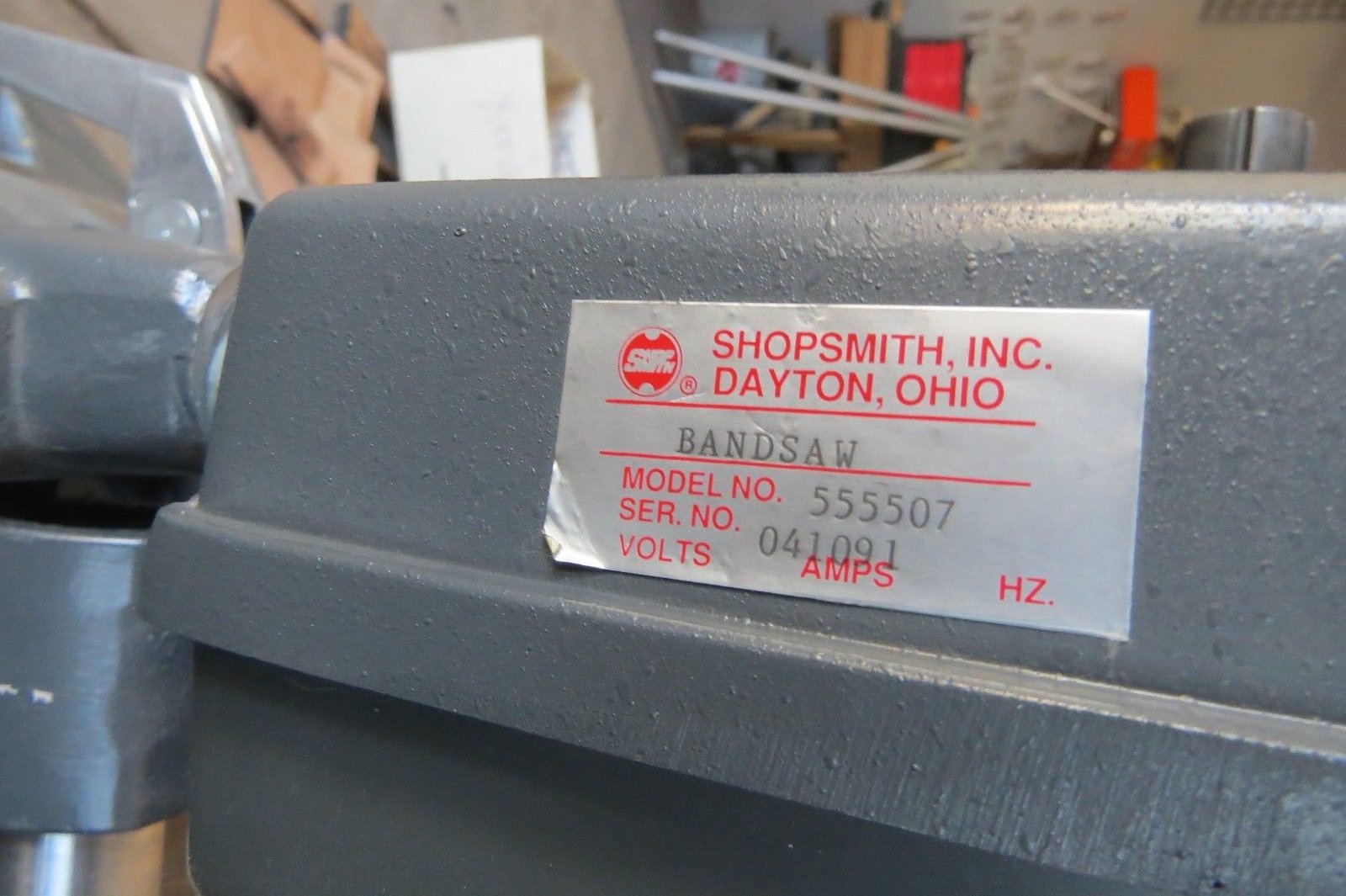

This Bandsaw was made April 10, 1991
Date Code 041091 Apr 91 SS.jpg (231.89 KiB) Viewed 2130 times
Although the sticker above says SER. NO. 041091 it is a Date Code and made April 10, 1991.
There were not any changes made to the Bandsaw between 1973 and 1992 that by looking at it would narrow it down any more than that.
