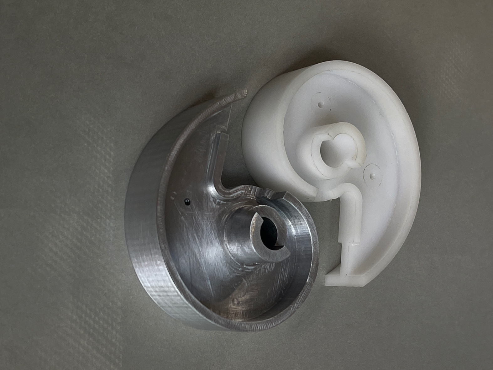

Somewhere I have an original blueprint of the CAM along with original manuals. The BP was pretty hard to read since the quality wasn’t very good. I made about 20 CAM parts (CNC from Delrin) and 1 from aluminum about 15 years ago.
I’m thinking about recreating the 3D CAD and a 2D drawing to see how well a 3D printer would compare to the CNC parts I have.

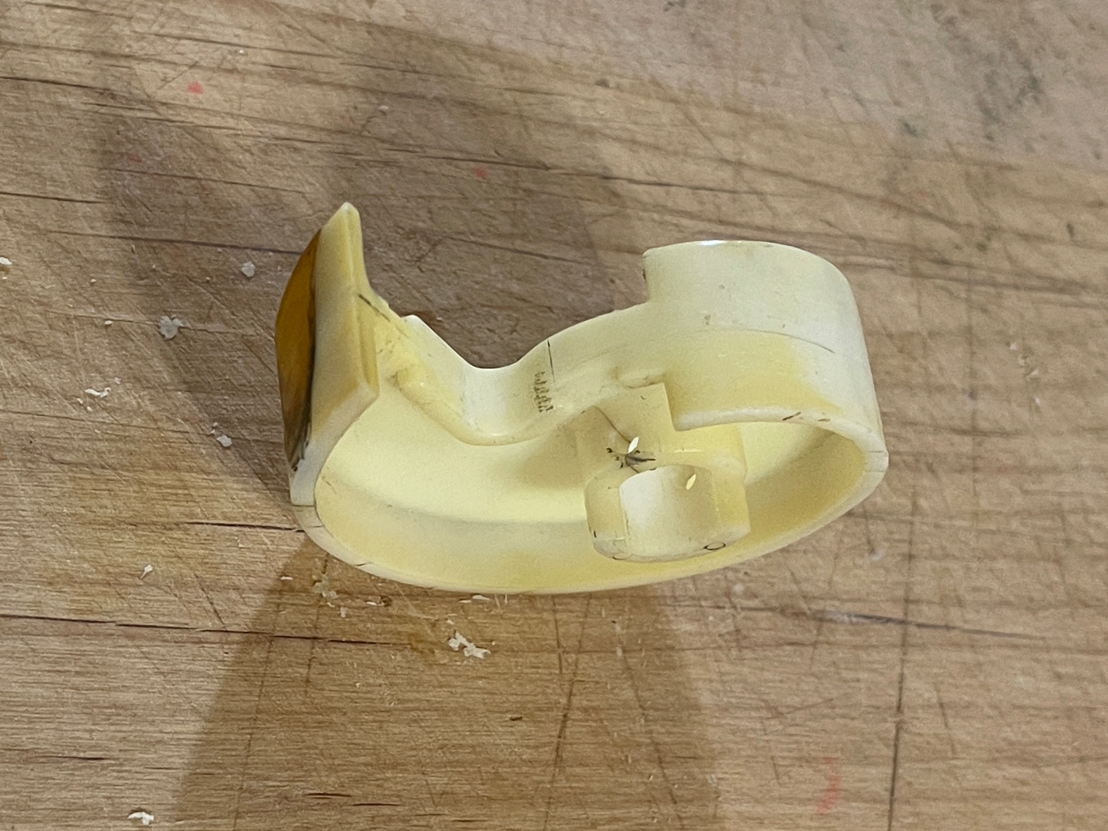

- CNC CAM~Control Delrin500 & Aluminum
- image.jpg (407.56 KiB) Viewed 2747 times

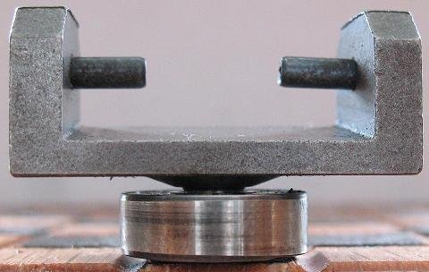

- CAM_Follower_included_in_Sheave_Control_Assembly.JPG (31.92 KiB) Viewed 2721 times
- CAM_Follower_Bearing_Attached.JPG (25.49 KiB) Viewed 2721 times

Interested? You are asking one who paid $80 for a cnc aluminum one a few years back.
And more recently 3D printed one.
Yes I think so!

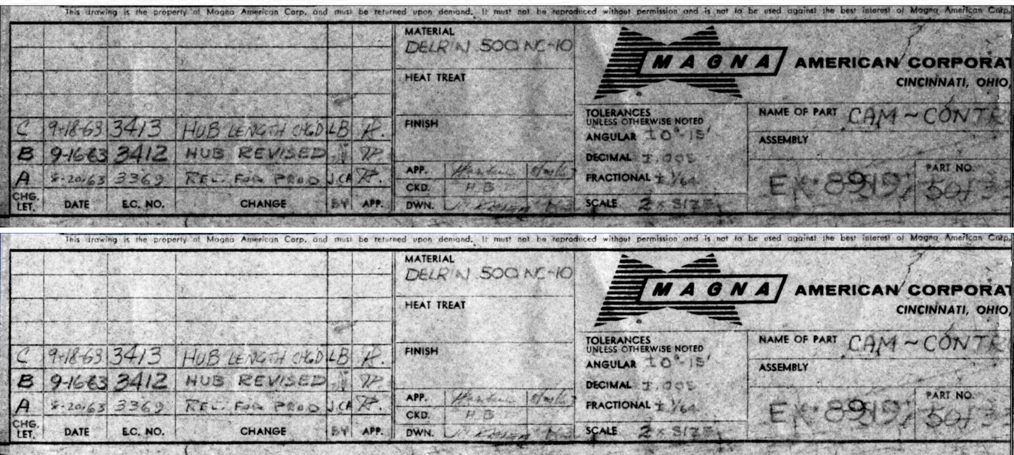

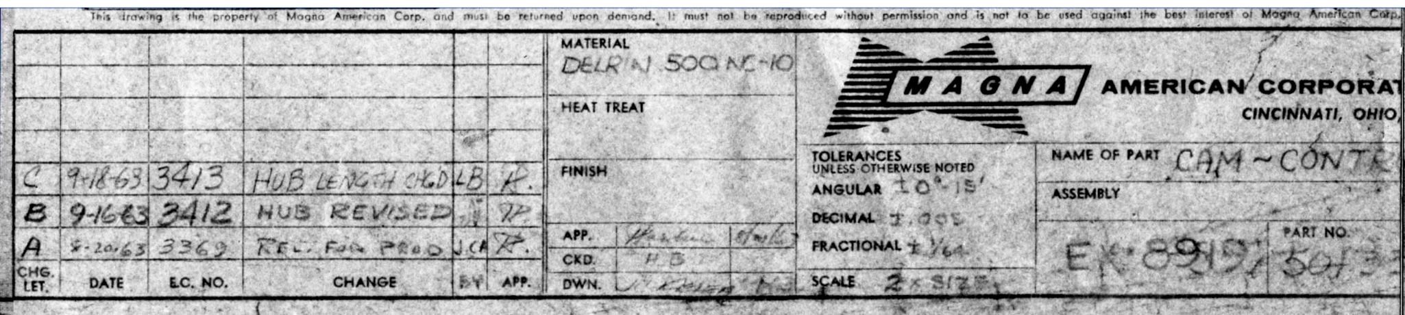

I’ve begun the restoration of the CAM ~ Control documentation.
The original Magna American Corporation (9-18-1963 revision “C”) blueprint is the basis to recreate an ANSI C size 2D drawing and subsequent blender 3D CAD model.

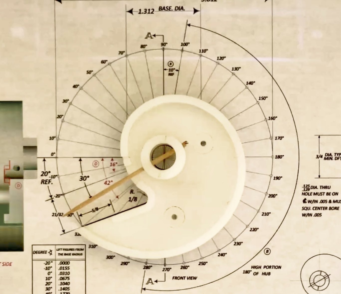

Thanks JPG,
The blueprint note, "FULL SCALE" image on the print I have measures to the actual part size; it is correct.
Therefore, the blueprint note, "SCALE 2 x SIZE" implies that the print dimensions are doubled.
Additionally, the blueprint measurement is 17 x 22 (ANSI C dimensions).
The attachment shows a Mark VII CAM part against an 8.5x11 printed document that I made (so far).
The outline on the drawing is slightly covered by the part.
So, I'm pretty confident that the dimensions on the drawing are quite good.
I'll post a 8.5 x 11 pdf of the drawing I'm making in a bit.
I would appreciate any comments for correction.

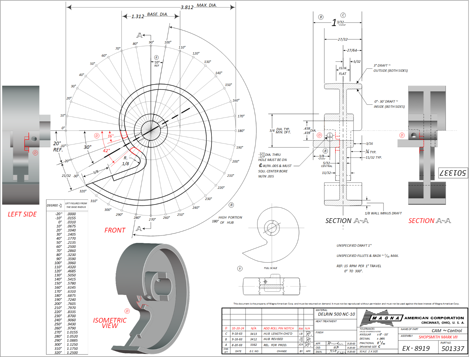

Re: 501337 CAM - Control, Shop Smith Mark VII
Comments and corrections are welcome
PDF is a better resolution PNG resolution is still good

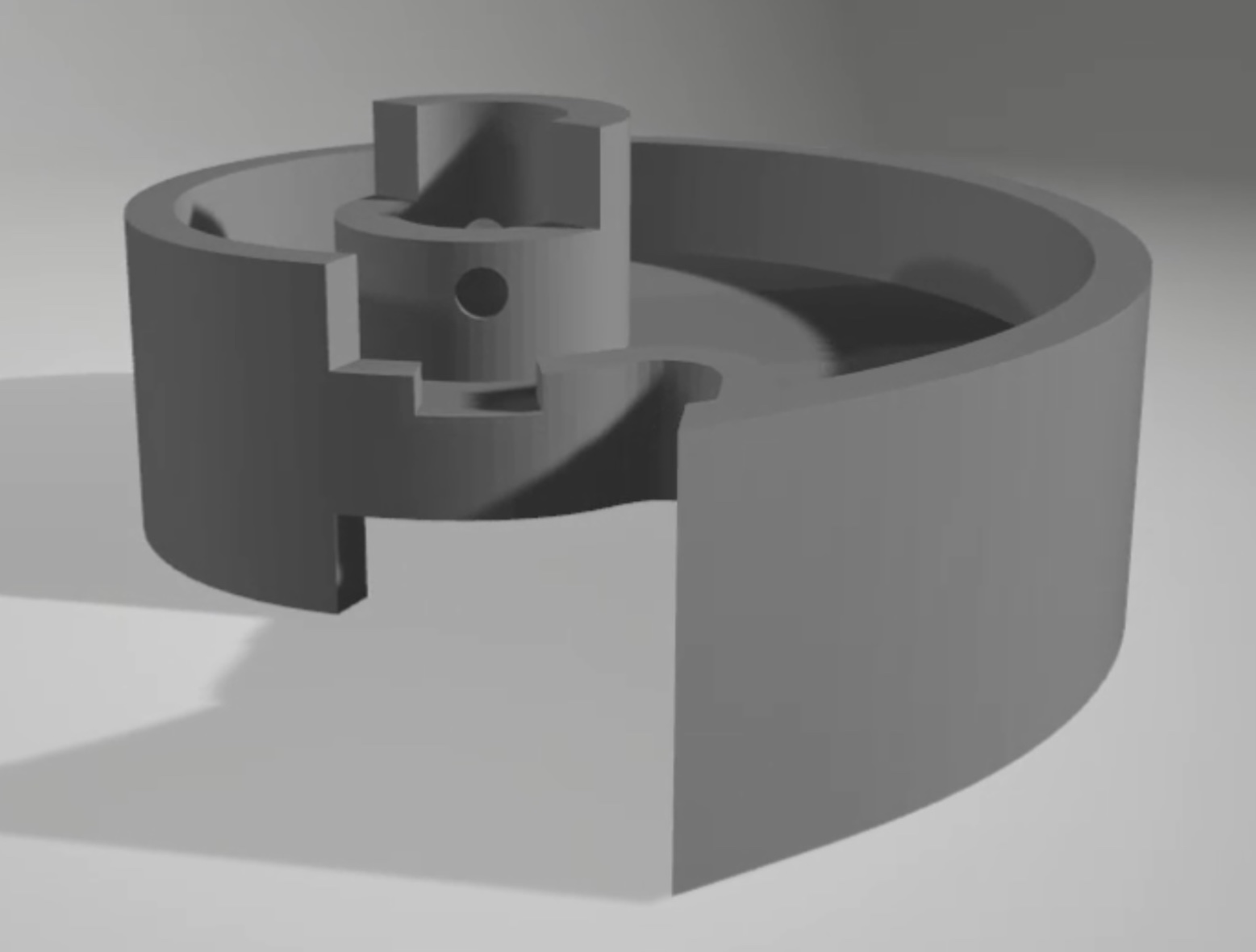

1st shot at a 3D model
