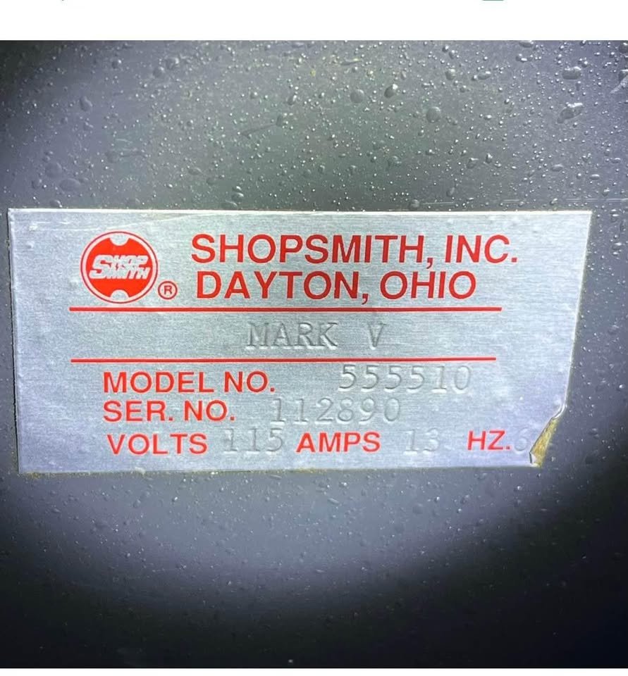

Hello, I'm new here so bear with me. I'm looking at purchasing a used ShopSmith. I'm having trouble figuring the age of the unit. The serial number (112890) is saying it would be 1982. But it looks like a 510 which wasn't introduced until 1985 (555510). Can anyone verify either way?
Thanks, Mike

Some older machines were upgraded with a 510 table system.

The table are of the later 510 version.
P.S. age matters not -- condition matters most.

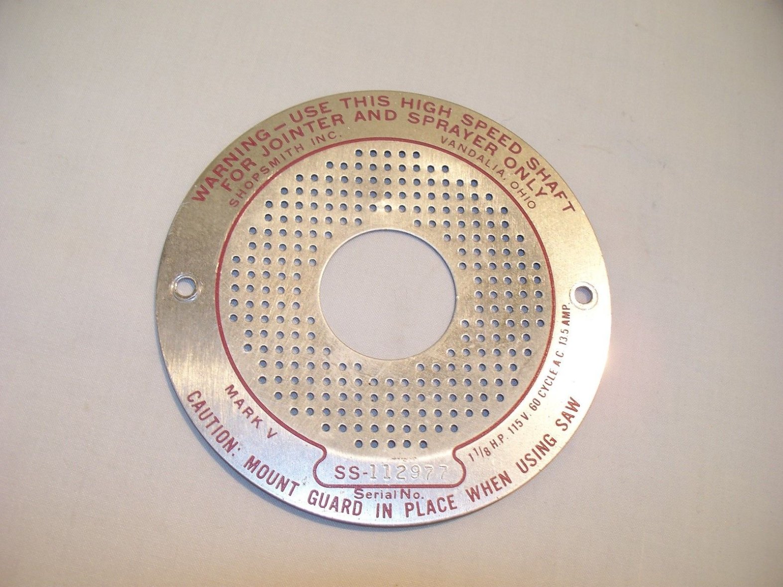

I believe the serial number you gave as 112890 is actually a date code. As an actual serial number 112890 would have been made in January 1982 but would include the prefix SS before the numbers. That would be on a Belt Cover Vent Plate like the one below.
_
SS-112977 Mark V Jan 82 woodgoody1.jpg (313.47 KiB) Viewed 2761 times

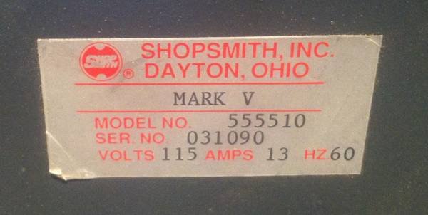

If that "serial number" is on a sticker as shown below it is a Date Code and is the date it was made.
_
031090 Mark V Poulsbo WA.jpg (23.71 KiB) Viewed 2761 times
Serial numbers changed to date codes in December 1987.

Great, thanks. So that would mean it was made 11/28/90? [
Re: Looking to buy?
YES
