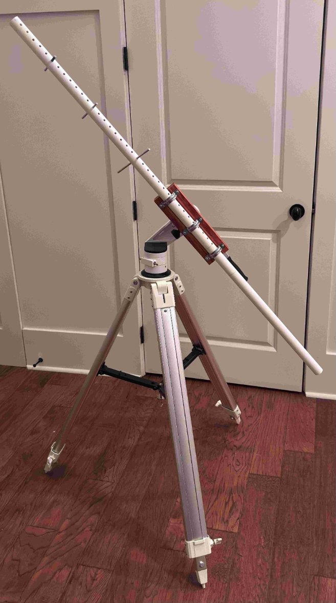

ps: Attached is my astronomical cross stick that I made using the drill press. It allows you to measure the angular distance between stars and/or planets. Could not have made it freehand.

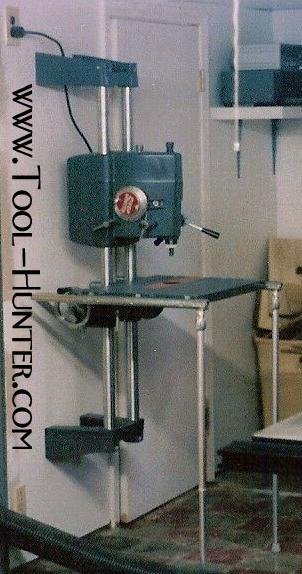

Have you considered mounting it to the wall similar to this? It doesn’t require cutting the tubes.
viewtopic.php?p=299813&hilit=Wall+mount ... ss#p299813
You lose portability of course but it’s the smallest footprint.

It would be possible to mount a Mark V to the wall but would be mounted differently than the Model 10ER shown in the link. For that I would recommend attaching the Bench ends to boards that span the wall studs. The last thing you want to have happen is anything coming loose from the wall. Angle brackets can be used to attach the Bench Ends to the boards through the five holes in each that attach the Bench Ends to the Legs.
If they were available Mark I Bench Ends would be easier to attach to the boards for a 510 wall mounted Drill Press as seen below.
_ .
Sorry but I just had to throw the Mark I in there.
_ .
